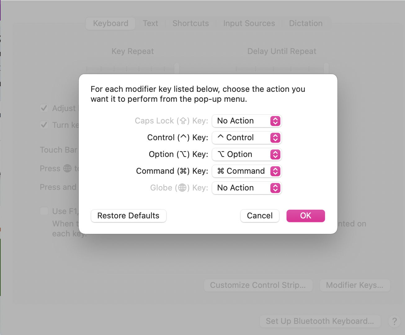

Choose No Action on Caps Lock and Globe Key, it's be solved.
