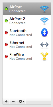

I do have the original Airport Express installed. Without the PCMCIA card installed the AE will not connect, even to an unprotected guest network. Here's how it looks:

Yes, x.x.x.30 and .31. Weirdly, if I power off and pull out the PCMCIA the AE card continues to work. This was not the case a few days ago. Perhaps it just needed to be jump started 😀 It works in both Leopard and Tiger now. I'm most pleased.
