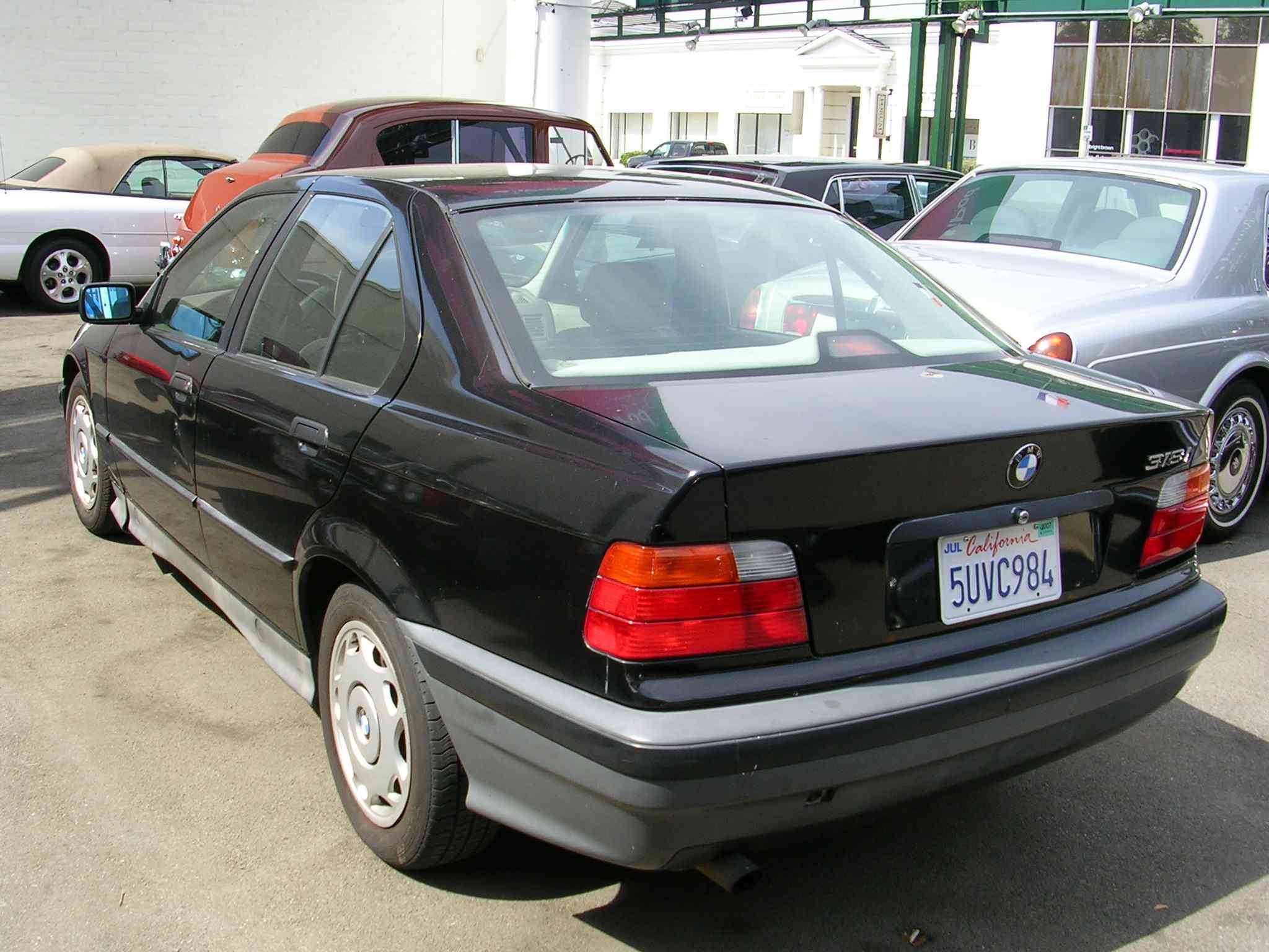

Well, I found a car that I really like. Its the right price and the right year. A little heavy on the miles but not too bad. Its in really good shape. The lucky car is a BMW 318i.
But........
It has had a replaced head gasket. 😱
I am told (by a euro car expert and good friend of the family) that replacing a head gasket is the equivalent of adding 100,000 miles. The engine just isn't the same.
Is this true? Apparently the car runs beautifully (I was hoping to see it in person this weekend).
I was always under the impression that something like this was good... like a recent brake job or something...
So confused.
Help?

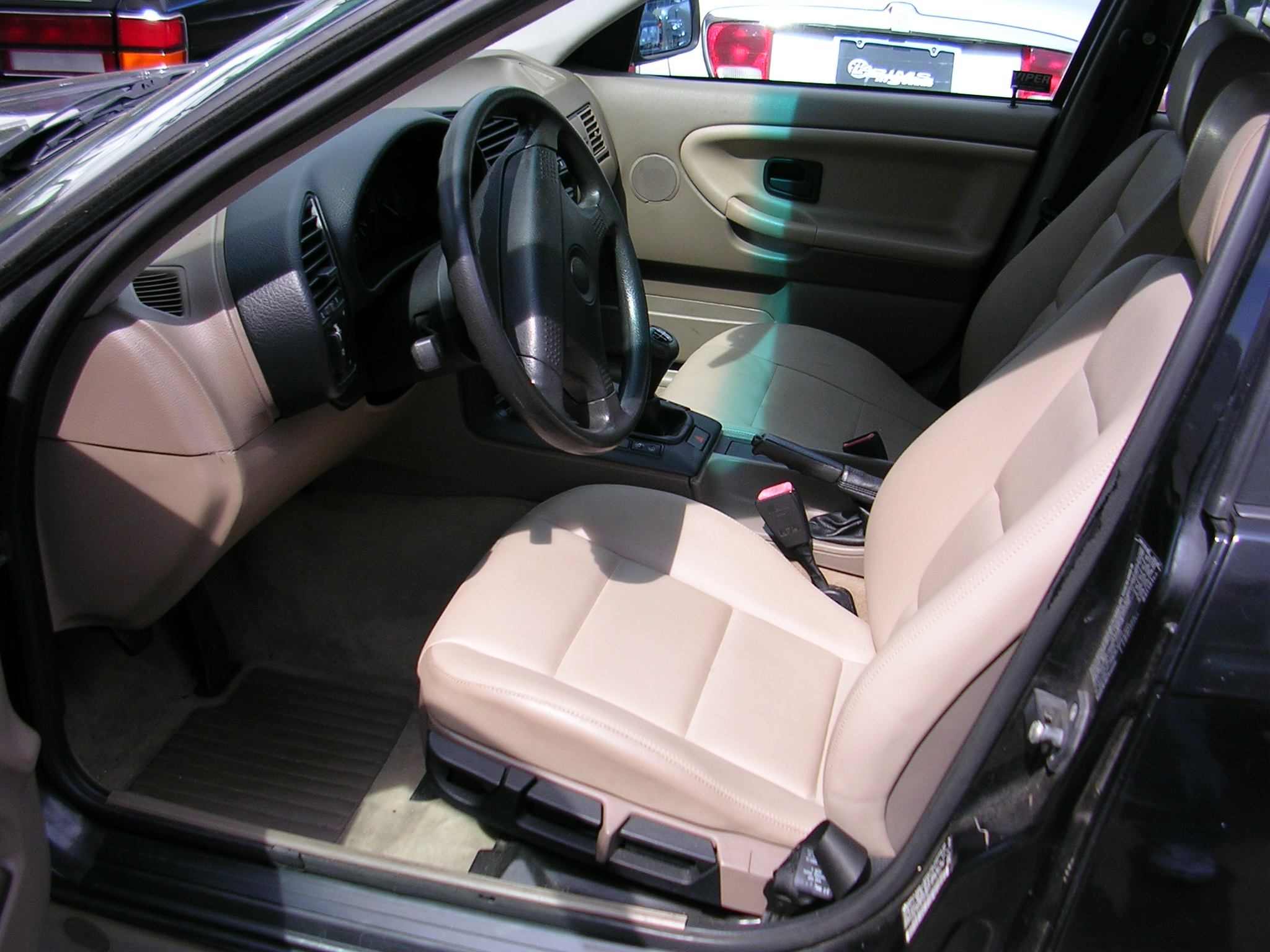

Its a 1992 318i w/ 180,000 miles. The body and interior are in great shape (interior is practically *MINT*)
Also, the power windows were recently worked on (to me this implies that I wont be needing to do much electrical work in the future... since its fixed? 😎 )
Also, I hear that the 318s are more prone to mechanical problems because its a smaller engine pulling a heavier chassis, thus must work harder. Is that true or... BullShido™?

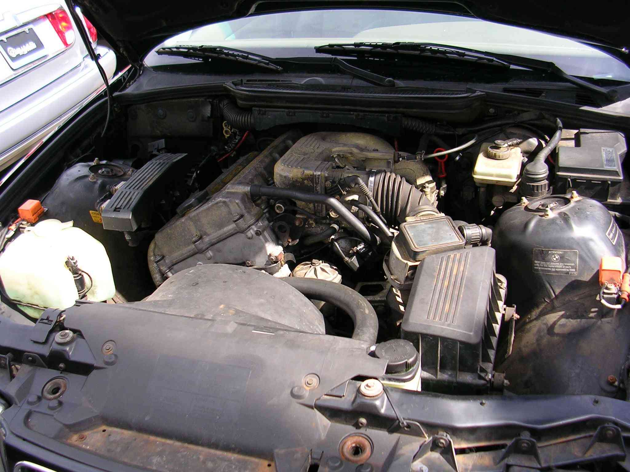

How can I tell if coolant got into the crankcase or if oil got into the coolant system? I worry about coolant > crank case because it can be murder on the bearings/etc.
I am hoping the previous owner was smart enough to shut the motor down IMMEDIATELY when it started to overheat.
Also, how can I tell if the head warped and weather or not they fixed it?
Finally, do you have any insights about the smaller engine > bigger chassis theory? Will it really be working hard enough to be more likely to fail?
Thanks.

Kingsly said:
How can I tell if coolant got into the crankcase or if oil got into the coolant system? I worry about coolant > crank case because it can me murder on the bearings/etc.
You should be able to see if there's any contamination because the oil on the dipstick will show signs of emulsification (foaming).
Easy to see if there's any oil leak at the gasket. Otherwise you'd have to take the head off and check it with a straightedge, I guess.

For my inspection:
I assume I would have to bring the engine up to operating temp and look around the cylinder head for oil leaks,
Check the dipstick for foaming,
Check the radiator for cracks/leaks,
Check the coolant pump,
Check the maintenance record of the gasket fix,
Push all the buttons, knobs, and dials,
Drive it, listen for... <someone please fill in the blank> 😱

Well did you buy it yet? One thing I did notice from the photos you posted in that the engine compartment is going to need cleaning. 😛
