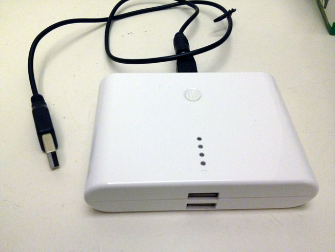

I was given a portable USB power charger as a gift. I don't recognise - nor can find anything on - the brand. On a full charge, it's supposedly good for 5 iPhone charges.
I tried it out and it seems to work fine, but started wondering -- given that it may not be a reputable brand, is there any chance that this thing could damage my iPhone 4S or iPad?

It should be fine, iPhones have the ability to detect charge and control the rate built into the phone.

The big issue is how stable it is at a particular voltage. IOW, if it has a 5v usb connector, it better be 5v. Under 5v and your iDevice can over heat or usually just not charge, and over 5v can cause the internal voltage regulator to be overworked and heat up.
The biggest risk with these batteries is its internal voltage regulator. If it blows and sends 12v to your iDevice (as an example) instead of cutting off, it will toast your phone.

I wouldn't worry too much about damaging an iPhone or iPad with it. I think there's enough charging control in the iDevices themselves. I think the most likely failure modes, given that it's an unknown brand (therefore unknown reputation), would be failure to supply the rated capacity, failure to supply full spec current, and taking forever to recharge the power supply itself. But these are all things you can check, and it sounds like you have.
So, I suggest you use and enjoy. If it supplies anything close to 12,800 mAh, that's a sweet gadget!

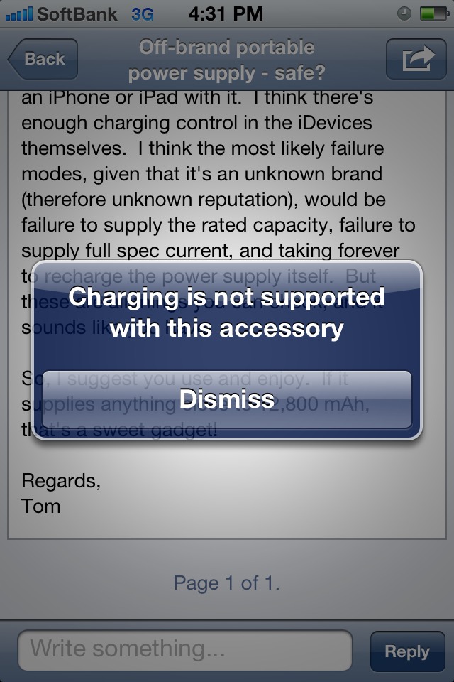

On a related subject... When I get this annoying message when using my generic charger, is it a problem? I unplug it, plug it back in and it charges for another few minutes or so. Doesn't give me an error if iPhone is not being used.

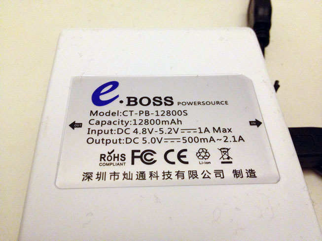

I agree with most of what was said by this poster except for the last sentence, most of these batteries contain a single Li-Poly cell at 3.7v, the electronic then boost it up to 5V to charge the iPhone so if it fails, most likely it will go down rather than up. Even if the design is 2 cells, it is still just 7.4V and with a bit of luck your iPhone will simply ignore it or say overvoltage.
There is no 12V in these batteries.
The 12,800mA relate to just the capacity of the battery and can't damage your iPhone, it's like how big your petrol tank is, the more you can fill up the farther you go, having a large petrol tank is impossible to damage your engine. However it is also unlikely that it contains a 12,800mA battery, most likely it is a "marketing" figure !!! If you dare to open it up you might be able to read up the real capacity as printed on the battery itself, probably 6000mA, but its already good going if so.
