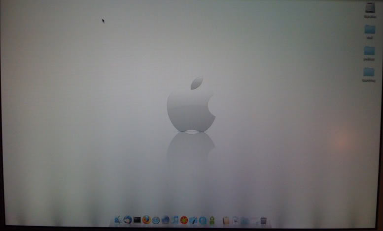

Post here if u have this problem.
We should bring up this issue. Lets get apple to fix this problem!!
2k + laptop should not have this issue

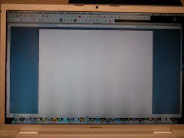

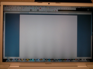

Same problem occurred to me. I took a few pics (see the one attached) the second time it happened to me. I took my mac to the local store and showed the pictures. The "genius" simply dismissed me by saying "This is the second time I've seen this. I don't think it's a hardware problem and I believe it's a software problem. So, there is nothing we can do now... You just have to wait for our software update. And it will be more helpful to us if you can recreate this problem and let us know how you do it..." Isn't that NICE??? You paid premium price for a faulty machine, which the "genius" cannot give you a good explanation!!!
Somebody apparently were lucky enough to have their macs exchanged due to the same problem. I'm just wondering how customers were treated differently depending on locations.
I'm from Cambridge, MA, by the way.
