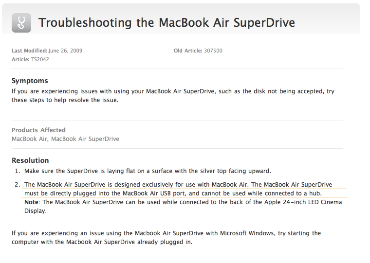

No, it doesn't. If so, you've got magical hubs and a truly Super, SuperDrive.
Have you read this thread. No hubs work with unmodified MBA SuperDrives.

Unless they changed something since the end of June, Apple support says they won't work on a hub either and doesn't differentiate between the two versions. So if yours does work, it's broke!😛 Hold on to it.:
