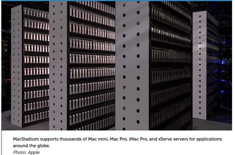

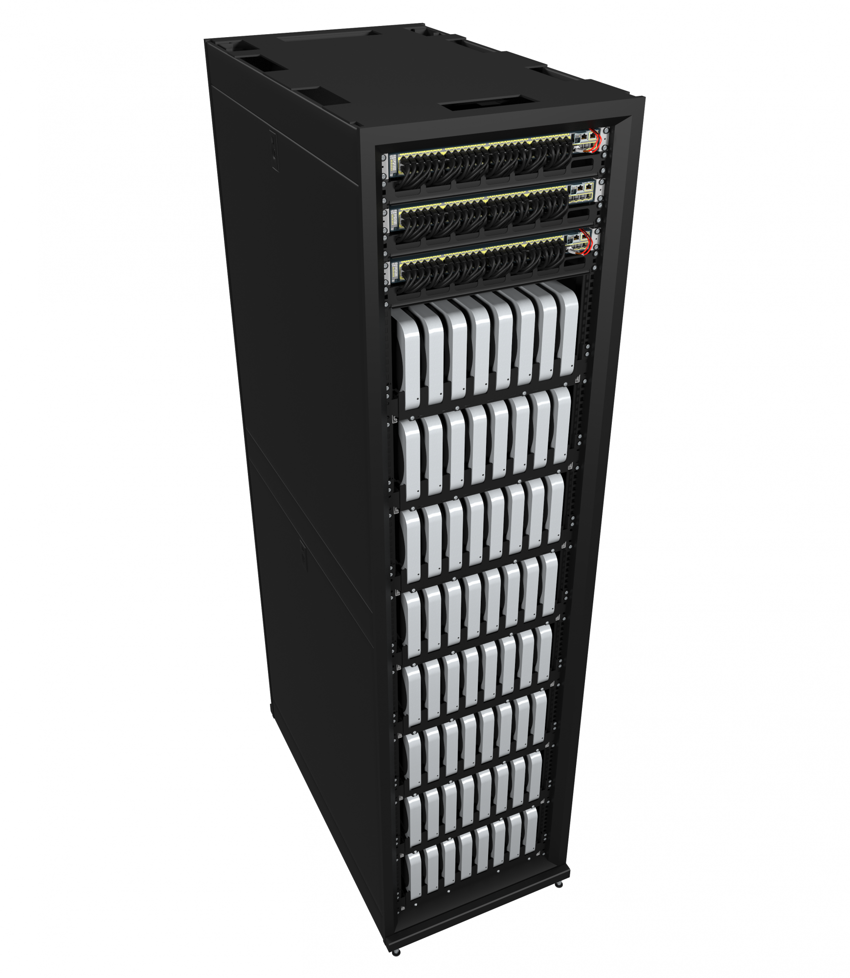

Mac Minis are crammed into server racks on their side with no issues, so I’d be surprised if the same couldn’t be done with the Mac Studio
