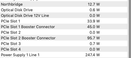

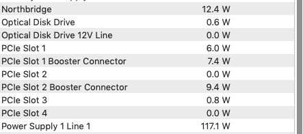

Thanks again chaps. I decided to test the 7970 just to see what that situation was. For the sort of work I'll be using this box for it looks as though it's going to be fine. I did an hour of general browsing, e-mail, Lightroom and Wordpress and according to Hardware Monitor this was roughly the peak power usage.
I then fired up Luxmark just to see what happened and the 8 pin connector quickly shot up to over 75W to around 90-95. I quit out quickly to be safe and although I can't think of any work I'll be doing that will cause similar spikes I have set up some alerts in HM just in case.

95 Watts is beyond a healthy limit,
as the other line is just 45 Watts get an adaptet set with
2xmini6 to 8
8 to 2x6+8
so you will have load balancing within the specs.
