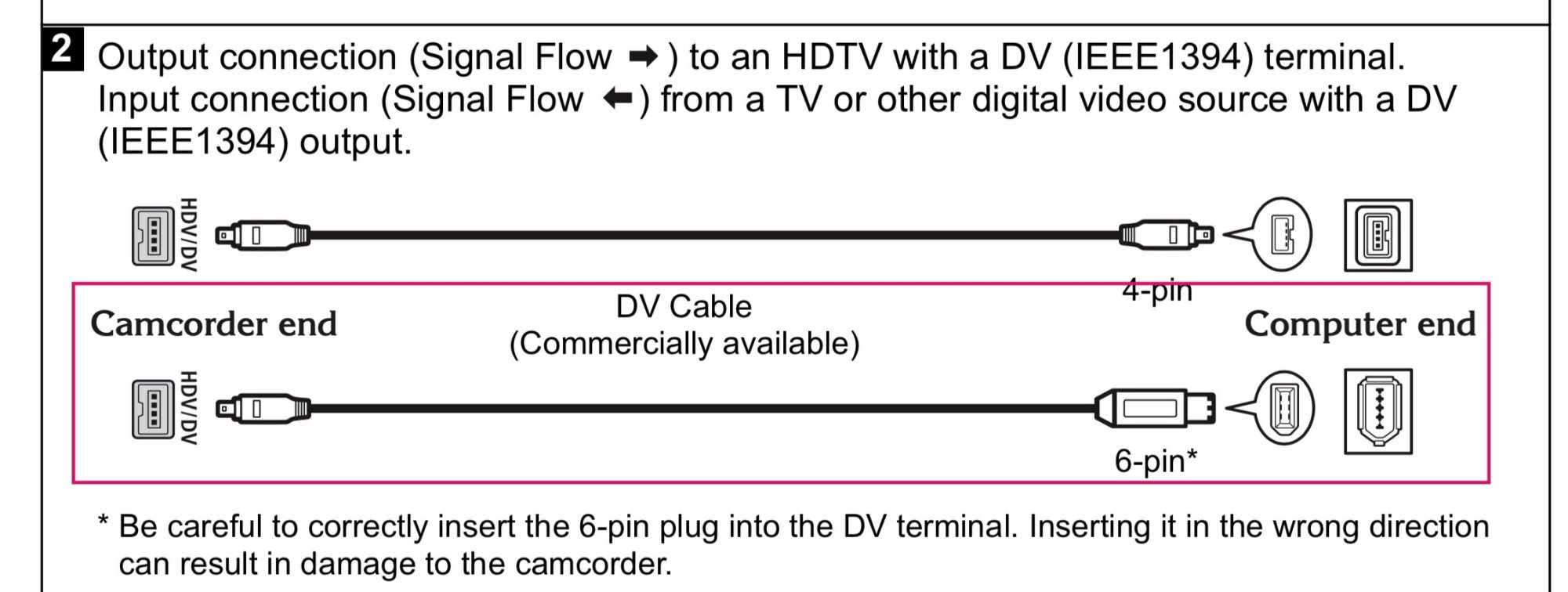

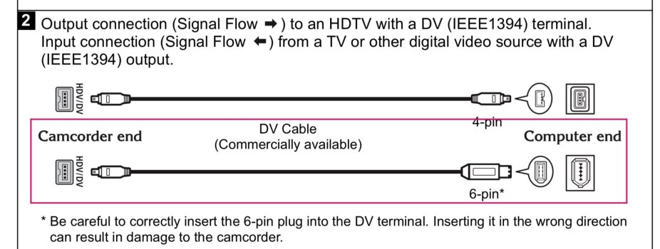

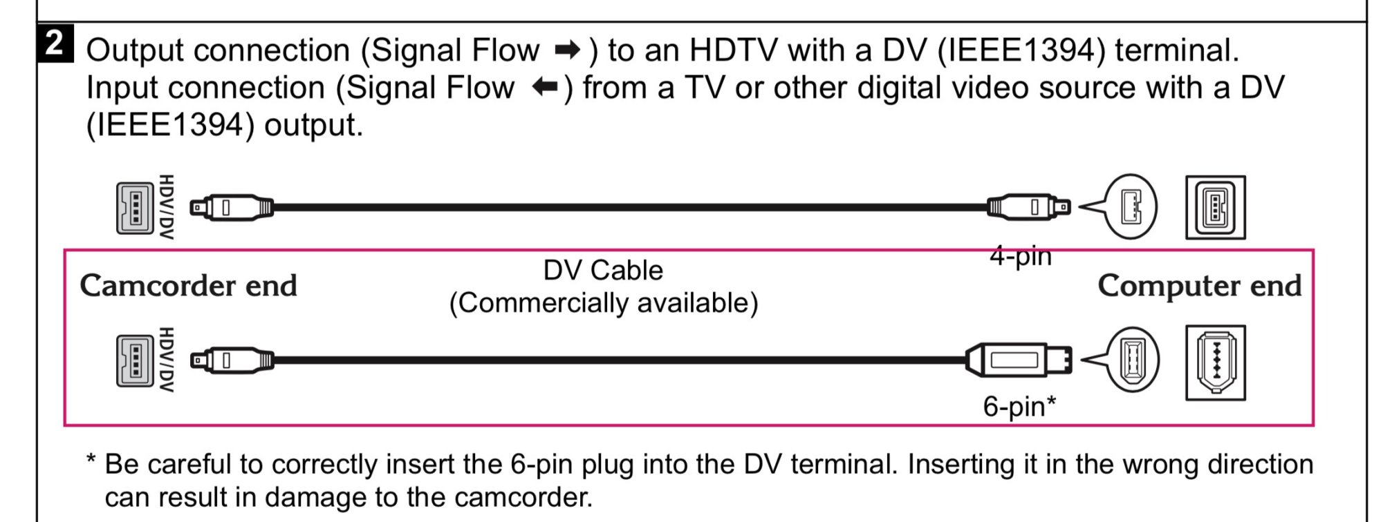

OP:
The manual for the camcorder is attached.
Looking through it, it looks like this offers a "camera-to-firewire" connection for video.
See page 68:
Did you ever use this cable before (perhaps to transfer video to your older Macs)?
BE AWARE that modern Macs DO NOT have a firewire connection, and it's not easy to establish one on a modern Mac (if it's possible at all).
For this reason, for working with the camcorder, I suggest you use an older Mac that DOES have a firewire connection on the back (can be either firewire 400 or firewire 800, doesn't matter). The image above shows the connector (on the right) for firewire 400, but there are adapter cables that can convert that to mate with a firewire 800 port, no problems.
