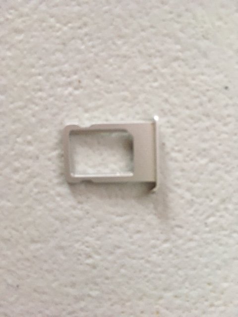

Here is how the sim tray looks. From looking at it compared to what i see online, its bent right? Its on the other end of it where its where you put it in the hole area. It doesn't seem to be straight so i must have damaged it when pulling it out?
But could i just put the sim card in without needing the sim tray?

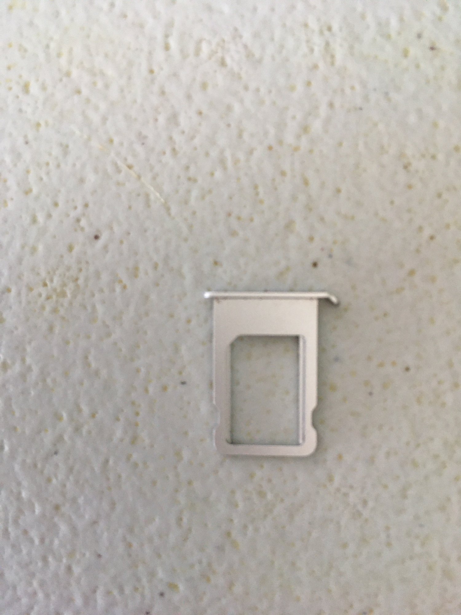

Here is another picture of it. So I damaged the sim tray when taking it out?
Again the earlier issue was i dropped my iphone on floor and it showed no sim. So i shut down phone and powered it on and same issue. Then i took the sim card tray/card out but i had used like this circular pin i had to take it out. I didn't have the correct tool to pull it out so i used that.
But now i cannot even push the sim card tray fully in.
I assume your talking about the bent ear where the tray seals against the side of the phone? Try and bend the sim tray flat, even if the small end of the ear snaps off, the SE doesn't have any water resistance rating so it won't matter much considering you plan on replacing it in a couple of months anyway

The later. It might break off, but that die is cast. Yeah, get it caught on the housing of the iPhone? I've never seen it happen, but...

See that little nick on the other end? That is what holds the tray in. Also turn it over, that is your iPhone serial number. Nice place to put it, but...
I wouldn't worry about it. Straighten it, and if it snaps off, well, it's still going to work...

If you can get a replacement tray that would be great. The tray has to be used, you can't just stick the card in the opening. I wound lay the bent end facing down on the flat part of a table (hard surface or the table may get marred) or vice and use a small hammer to tap gently until the ear is flat

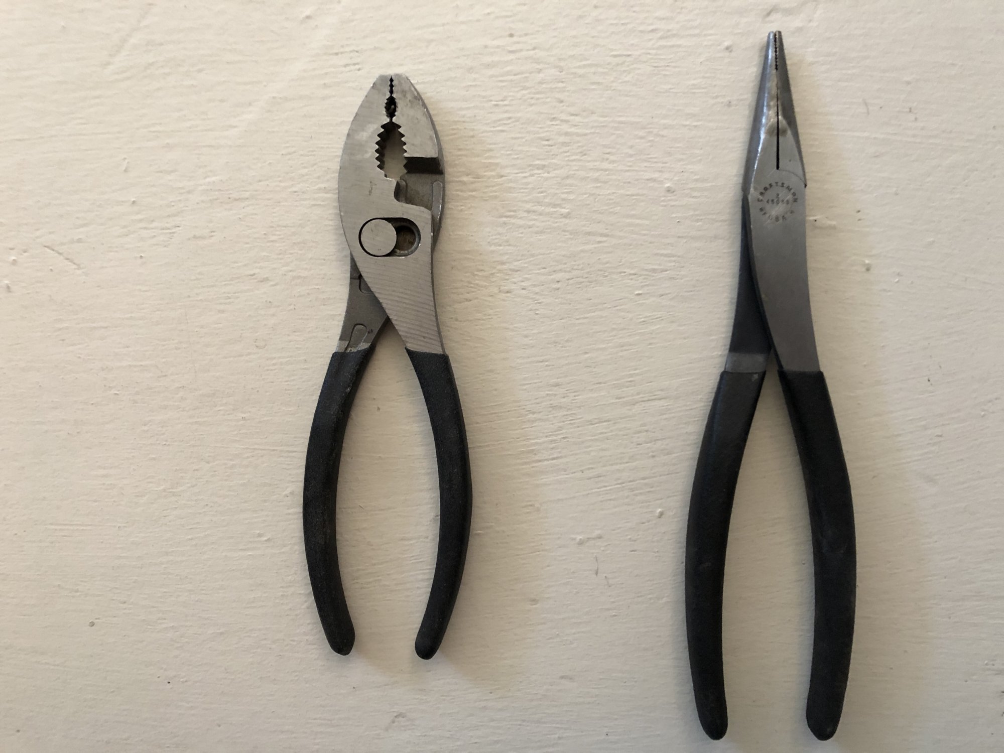

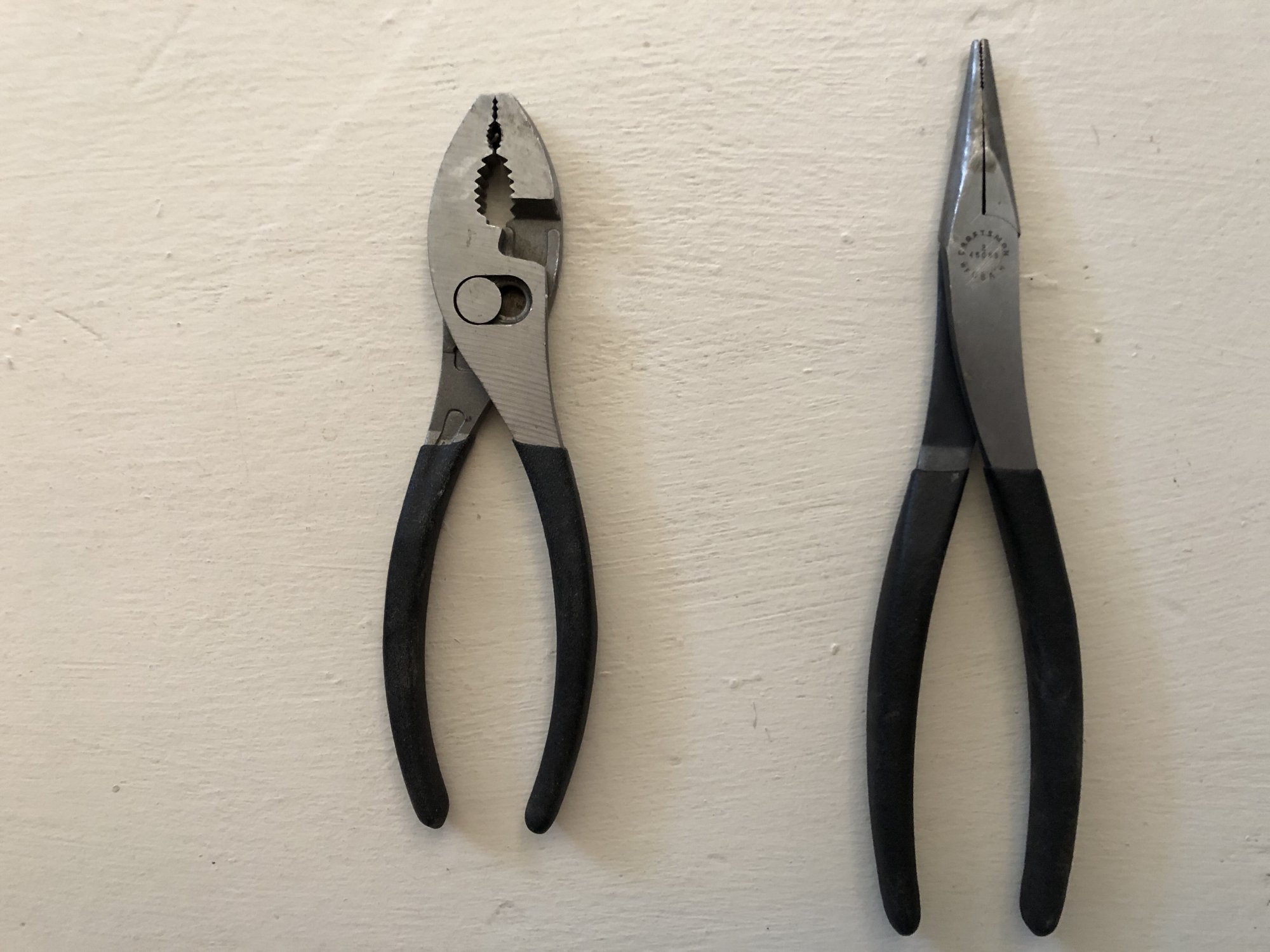

Gently, gently tap with the smallest hammer you can find or use pliers. Something like this if a small hammer isn't available
