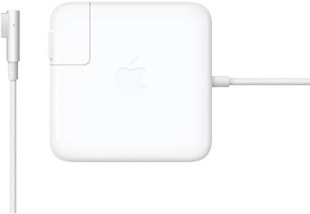

Here is pic of the old power supply that might be helpful.
Thanks, gamboolman....

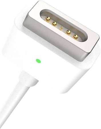

Here is 2 X pics of the old ones

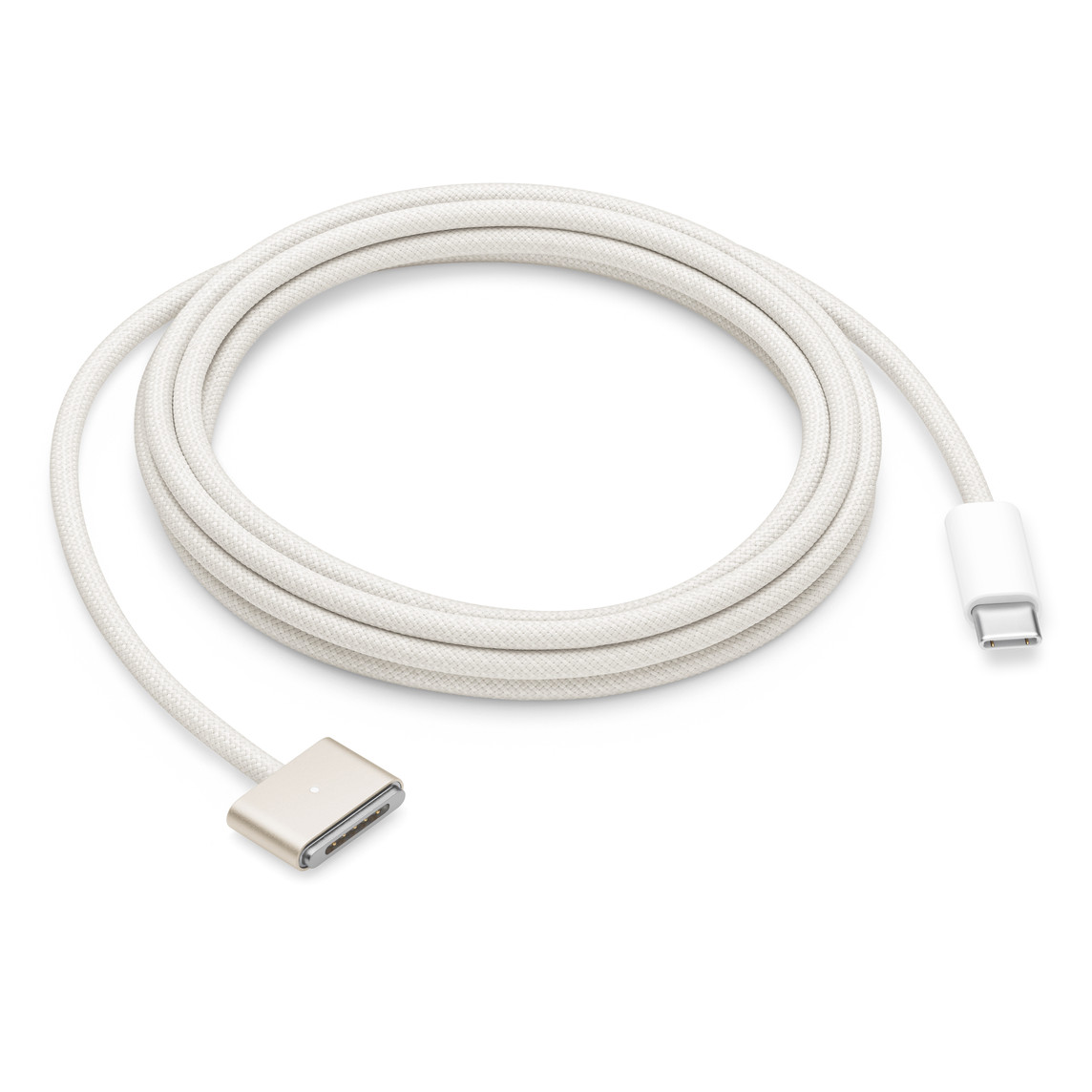

New MagSafe Cord
There is no way to convert MagSafe 1 or 2 into MagSafe 3. They are electrically incompatible.
Some converters have been made from MagSafe 1/2 to USB-C. They would potentially work but contain active circuitry to convert between the standards and I have no idea if they are good or not:
Quality hit or miss. Used several AnyWatt years ago with a bunch of Apple Thunderbolt displays. They tend to get hot depending on how much draw. However, they did work. I recommend you only use them with 45w or 65w adapters for this reason.

The good thing about the new ones is that they're modular and based on the USB standard, making it easier to replace cables without replacing the entire power supply. I also means that modern MacBooks can be powered directly through a USB-C port if you don't have a MagSafe 3 cable available but do have a charger for a newer iPhone, iPad, or PC that uses USB-C.
