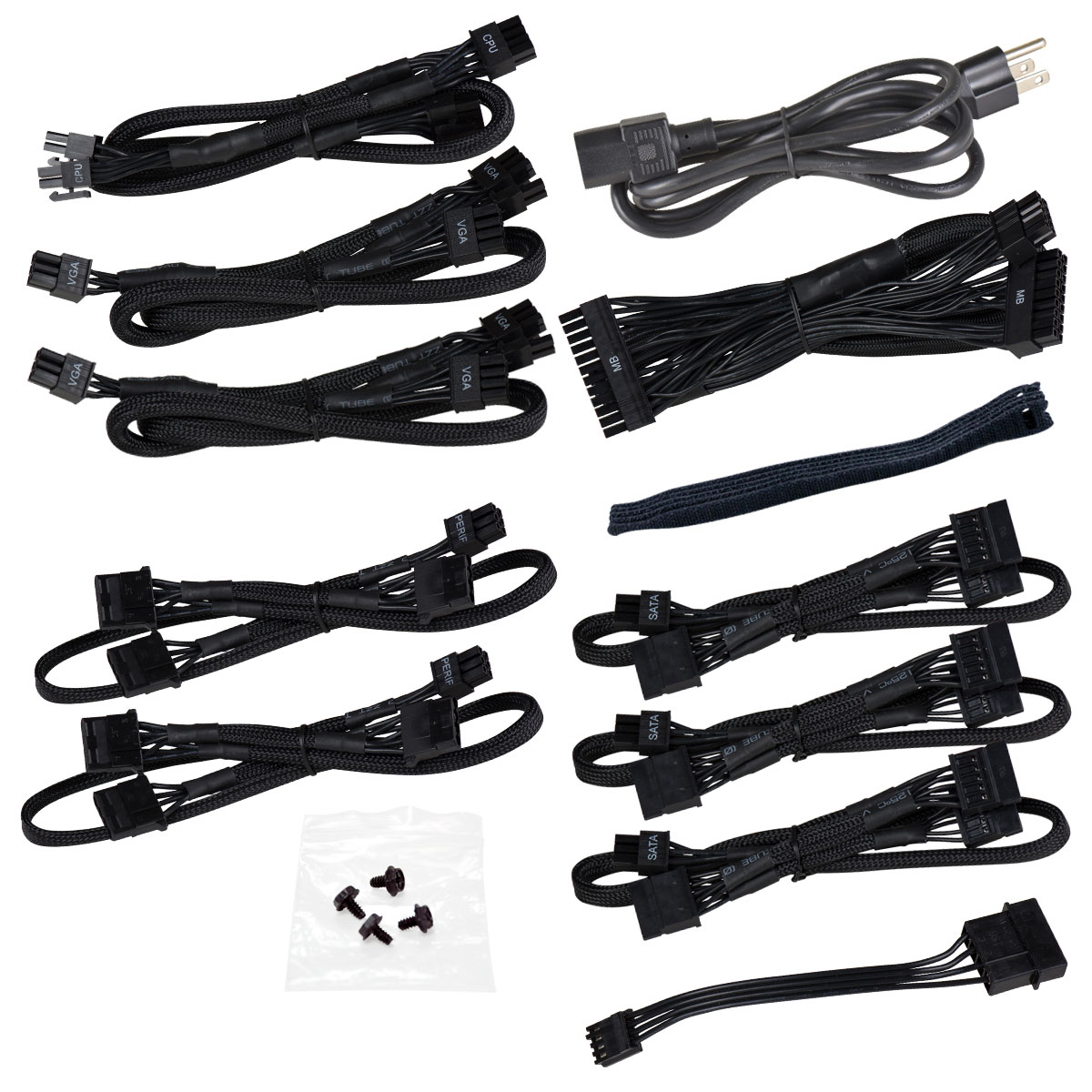

My concern was for the CPU connection. The computer now takes a 4 pin connector. The larger PSU has 8 pin, and 4+4.
The main board is already installed in a larger small tower case.
Look at the photo of the cables. I'v also attached it here. The CPU cable is in the upper left. It's an 8-pin block that attaches to the power supply and it comes out as two 4-pin connectors, hence the 4+4 moniker.
So, would I be able to split the 4+4 and only use one connector? Is the polarity wiring the same as in older devices using a single 4 pin connector?
You can definitely only use one. It is already two 4 pin connectors. The pinout is part of the ATX spec.
You will need a 24 pin to 8 pin adapter. They sell them on Amazon and eBay for about $7 to $13.
