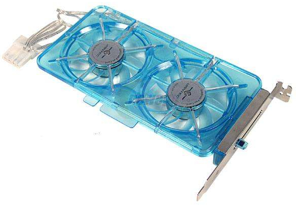

What graphic cards do you have in the MP?
Configured with heat sinks? 1 fan? 2 fans?
What's the GPU temp?
Any PCIe slots open?

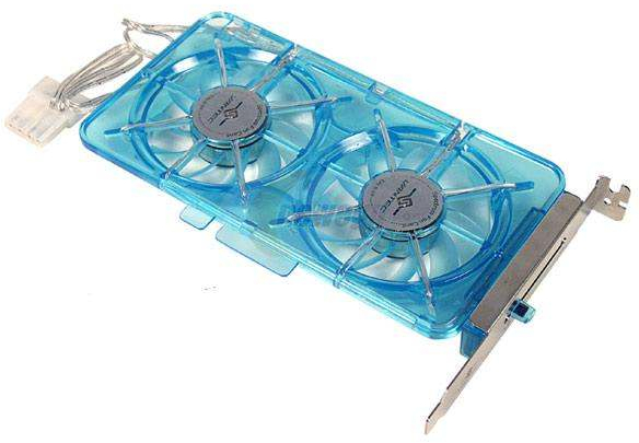

Room for a:

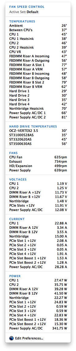

As requested, here is my exact setup...
Mac Pro 2006 (upgraded to 2 x Quad 2.66 5355s)
16GB RAM (8 x 2GB modules)
3 HDDs
1 SSD
ATi Radeon HD 4870 (driving a 30" ACD and 23" ACD)
ATi Radeon HD 2600 XT (driving two 23" ACDs)
I posted my temps below...
