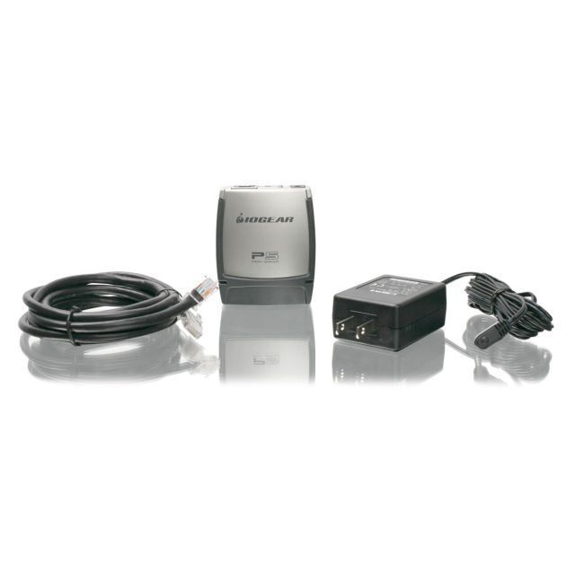

Yea, contact Brother. My Brother printer isn't supported with Ventura (or M1, M2, can't remember). Either way, I changed to a USB print-server and it's been chugging along since.
I used one of these:

"Device is not compatible with Multi-Functional Printers." :-(
