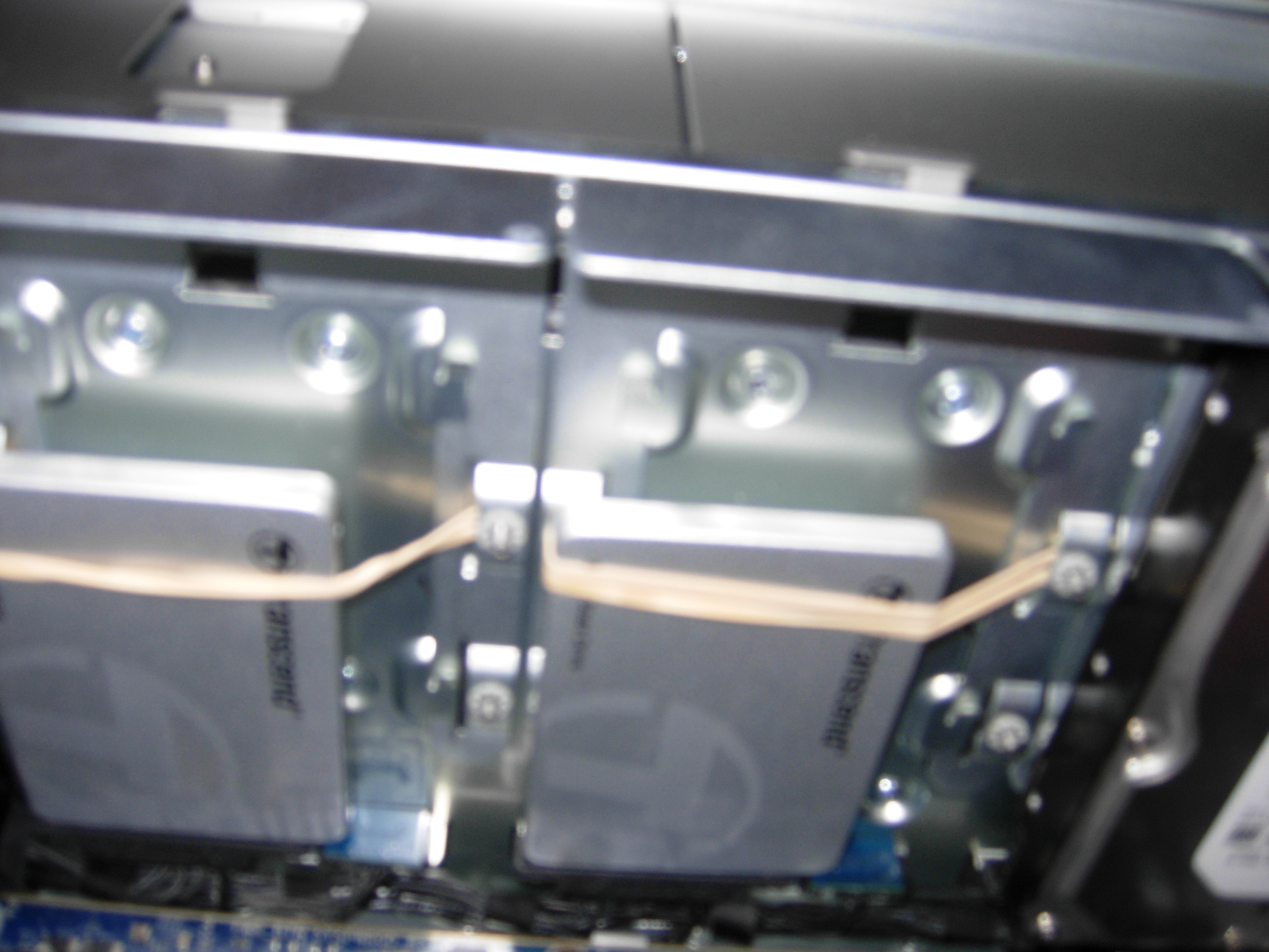

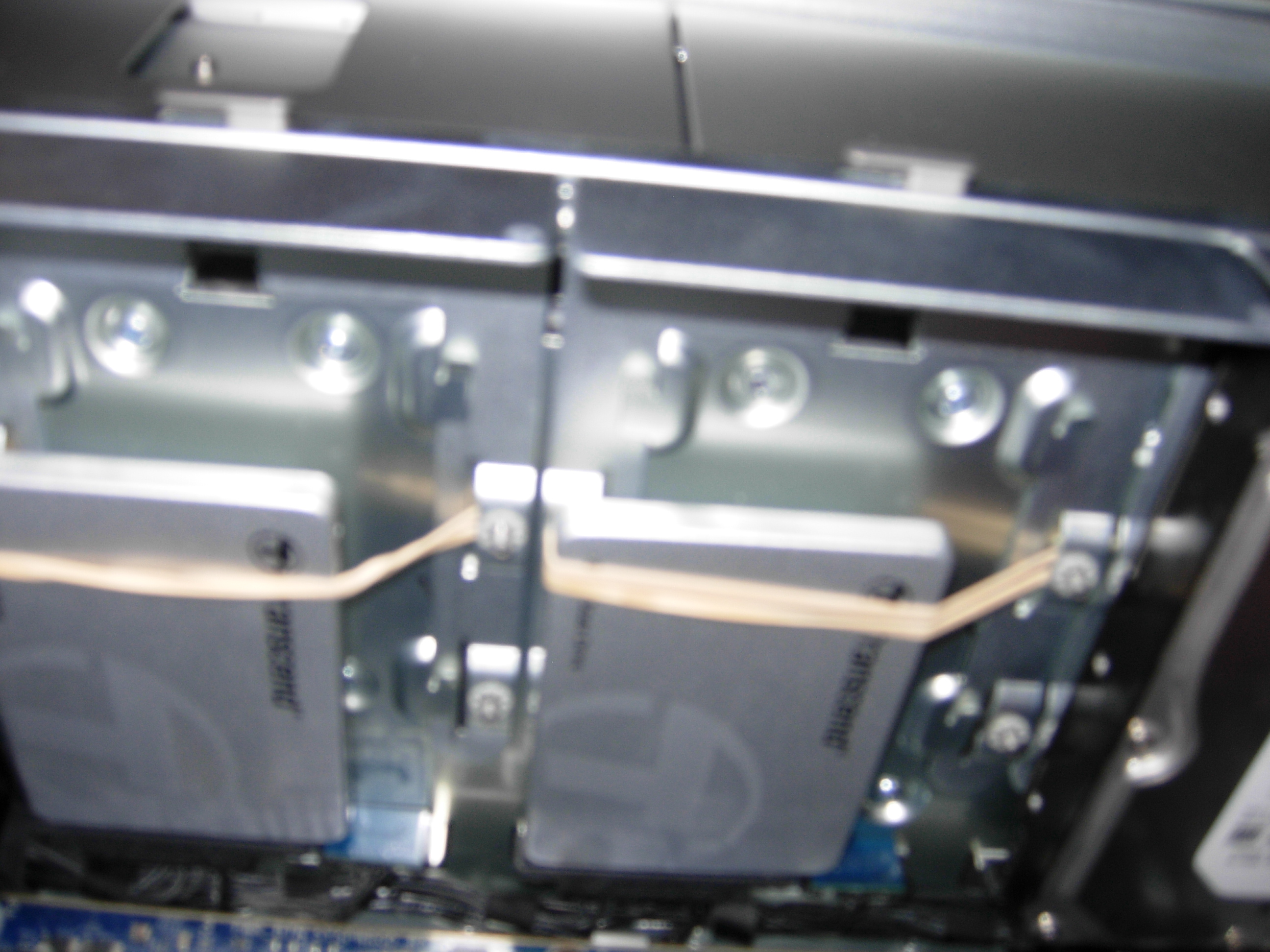

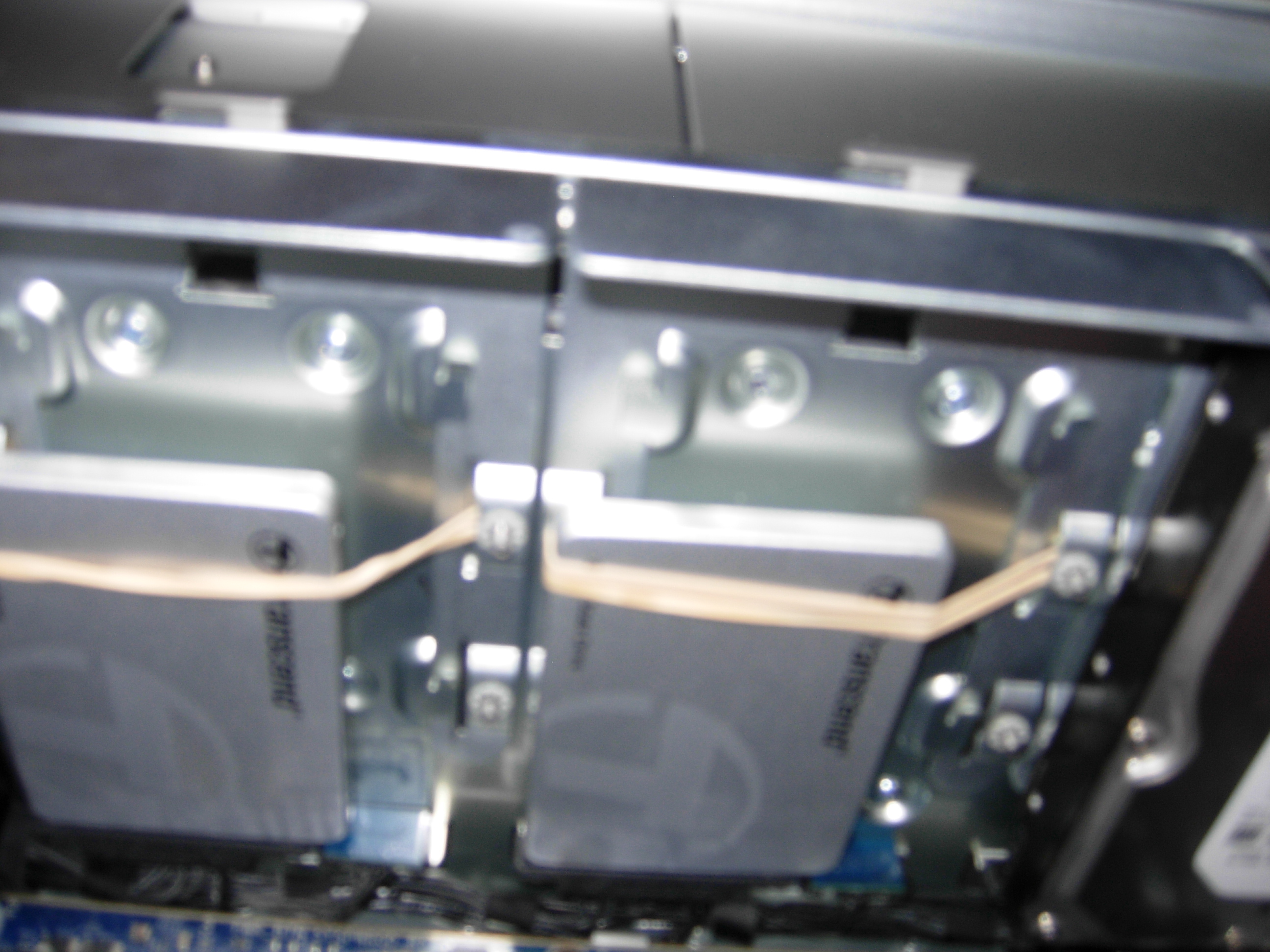

Or you can leave the case on, not void the warranty and support the rear end with a rubber band like so...
I'd never put a rubber band inside a computer - at least not long term.
Haven't you seen how old rubber bands dry out and get stiff and brittle?
I'd use nylon tie wraps (they don't need to be tight - just to support most of the weight).
