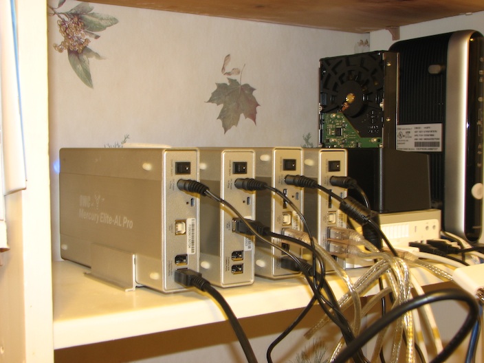

Certainly use external and not ethernet connected drives. I'd suggest FW800 for streaming but USB actually works fine for TimeMachine which is quite slow anyway.
