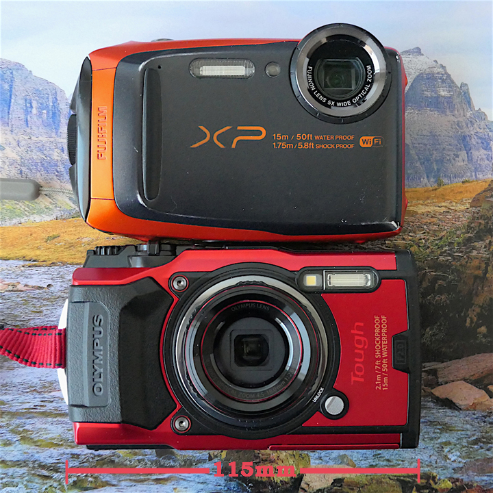

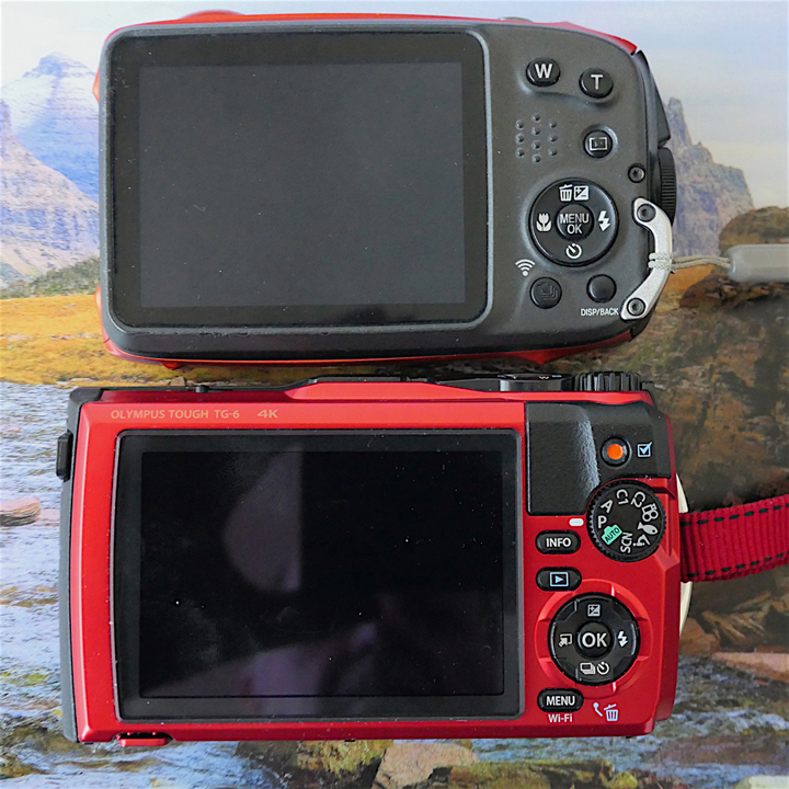

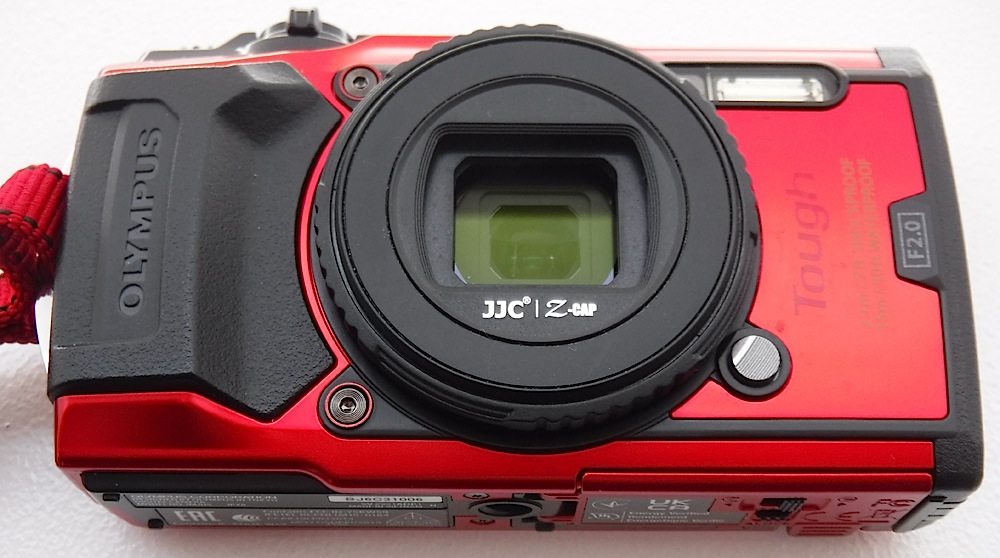

So a visual comparison. cameras are almost the same size with the Olympus being about 3mm longer, the Fuji being 5mm taller and the Oly being 4mm thicker. The Oly weighs 254gms, the Fuji is 207gms.
NOTE: The Oly has a bayonet mount which allows for filters, tele-extender, or super wide angle attachment.
ALSO NOTE: The Oly also has a mode dial, whereas the Fuji requires a menu dive to change modes. This dial is not really a good thing as it means one more thing that can be accidentally bumped when working the camera with one hand.
A quick discussion of the lenses. WP camera lenses have a unique build in that the front element is fixed and the internal elements move to achieve zoom and focus. This is how they achieve such a good waterseal. Also explains the rather limited zoom range.
The Oly lens is 4.5-18mm(25-100mm equivalent). Maximum aperture is ƒ2 to ƒ4.9 depending on focal length.
The Fuji is 5-25mm (28mm-140mm equivalent). Maximum Aperture is ƒ3.9 to ƒ4.9 depending on focal length.
So at the widest angle the Oly has almost a 2 stop speed advantage over the Fuji but at 18mm (100mm eq)both are an identical ƒ4.9.
The Fuji has a strange quirk that I have seen in no other lens. It has excellent depth of field in front of the point of focus but very little behind. So with landscape shots that don't have a lot of close in foreground it's better to focus further away than with other cameras. Most obvious in the wide angle range, but till somewhat true at the telephoto end.
Because the lenses are fairly small and very short, there is not a huge range between minimum and maximum aperture. These are not cameras you would choose for blurring everything but the subject.

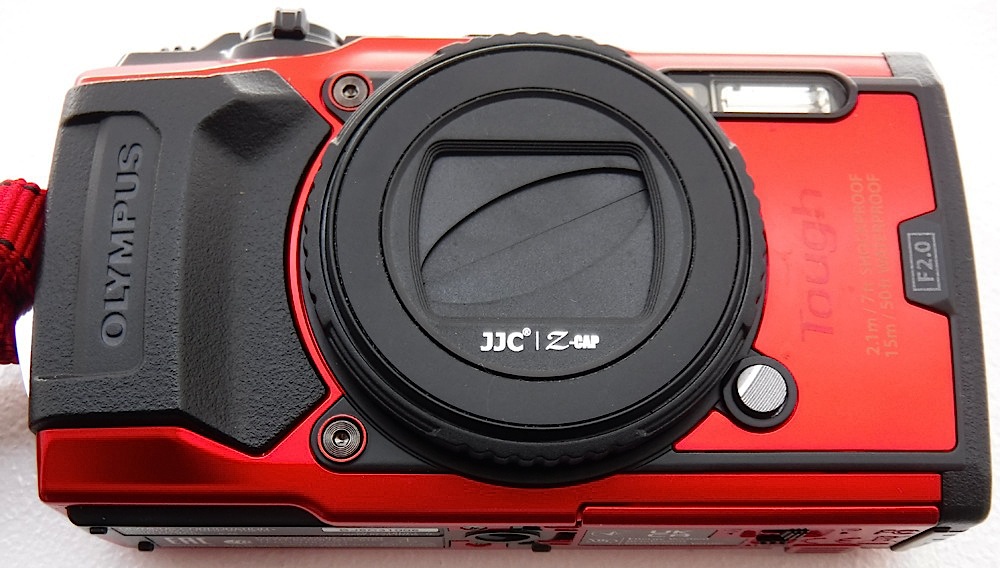

This is my third WP camera dating back to 2010. Water droplets or spots on the lens can be a major irritant, when the camera is used on or in the water rather than under water.
Earlier I talked about the bayonet mount on the Oly. Purchased an aftermarket spring loaded lens cover and finally tested it on a river. Turn right to open, left to close, zero vignetting. Gonna give it a slightly mixed review. It did keep the lens dry despite numerous splashes to the life vest, but the cold water made it really stiff to open. A bonus is it provides protection for the face of the lens when the camera is otherwise taking a bit of abuse.

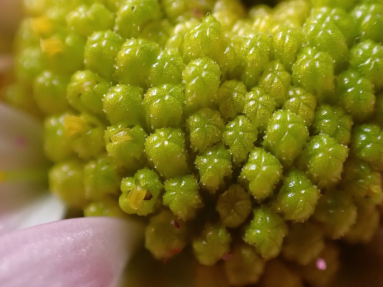

Both of these cameras offer good close-up abilities. Moreover they do it without having to use the wide angle of the lens.
Both require switching to close-up focusing. With the Fuji this involves pressing the left side of the joystick then selecting 'close-up'. The Oly requires pressing OK, finding the focus selctor, then selecting 'close-up' with the joy stick. The Fuji reverts to normal auto focus when the camera is turned off. The Oly retains its setting. The Oly offers both auto and manual close-up focusing. Manual focusing will not get in as close. I used the auto for this comparison.
With the Fuji getting in to the closest focus point is a bit of an art. With this shot to get in as close as possible I started at a point showing the entire flower and some background as well, pressing the shutter halfway to get a focus then moving in a shade closer and refocusing. It took about half a dozen baby steps to get in as close as possible. I was working at the 13mm point on the 5-25mm zoom, Aperture was wide open at ƒ-3.9, shutter came in at 1/180, ISO was manually set to 800. If you look at the image at full resolution you will see a bit of noise but not objectionable. That said I prefer using an ISO of 400 or slower with this camera.
With the Oly I used the maximum 18mm focal length. Aperture was wide open at ƒ-4.9, shutter was 1/100, ISO manually set to 1600. The auto focus grabbed at once and I continued to immediately release the shutter, as it was hand held and maintaining exact distance for any amount of time impossible. The Oly can go in even a smidge closer provided the camera does not get in the way of lighting. Again a bit of noise but not objectionable.
First image is from the Fuji, second from the Olympus. Entire flower is 3" or 75mm in diameter. Entire center is 5/8" or 15mm in diameter. Vertical portion of Fuji image is about 40mm or a bit more than 1.5". Vertical portion of Oly image covers less than 12mm (1/2)" At it's closet the Oly focuses down to .375"x.5" or about 9x12mm. This is only if the lens is zoomed all the way into FL=18mm. At FL=4.5mm, the coverage is not nearly as good.

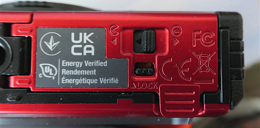

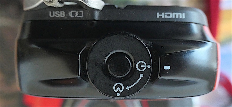

Gate locks may seem unimportant but that is definitely not the case with Waterproof cameras. Leaving the door ajar could have fatal results, at least for the camera.
Fuji uses a double action lock. Push the spring loaded center button while turning the knob left to open. Locking is automatic when you turn right to close.
The Oly uses a pair of fingernail slides. One to lock and unlock and a second to open or close.
NOTE: It would be difficult to unintentionally open the gate, even should one forget to lock it.
Oly uses a second double slider gate to access HDMI and USB ports. Fuji just has a single gate for everything.
