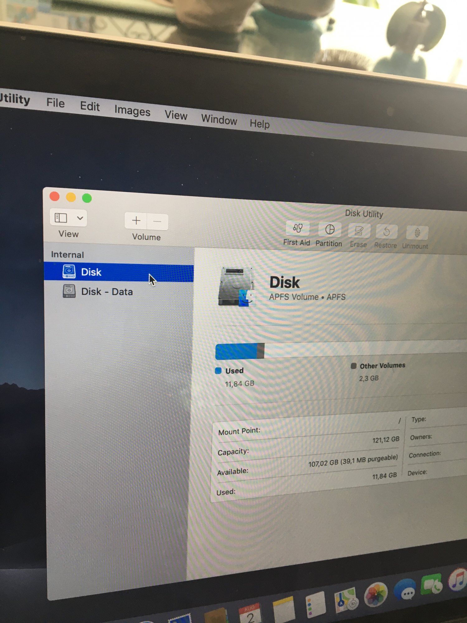

Ok - but when I want to make clear fresh install if Mojave, when I was in Disk utility - now there is new Disk - Data appeared... Before there was just Disk and i erase it an that was it.. now I dont know what to do? Both disks“Disk” and “disk-data” have same space 121 gb but one is 1s1 other is 1s5?

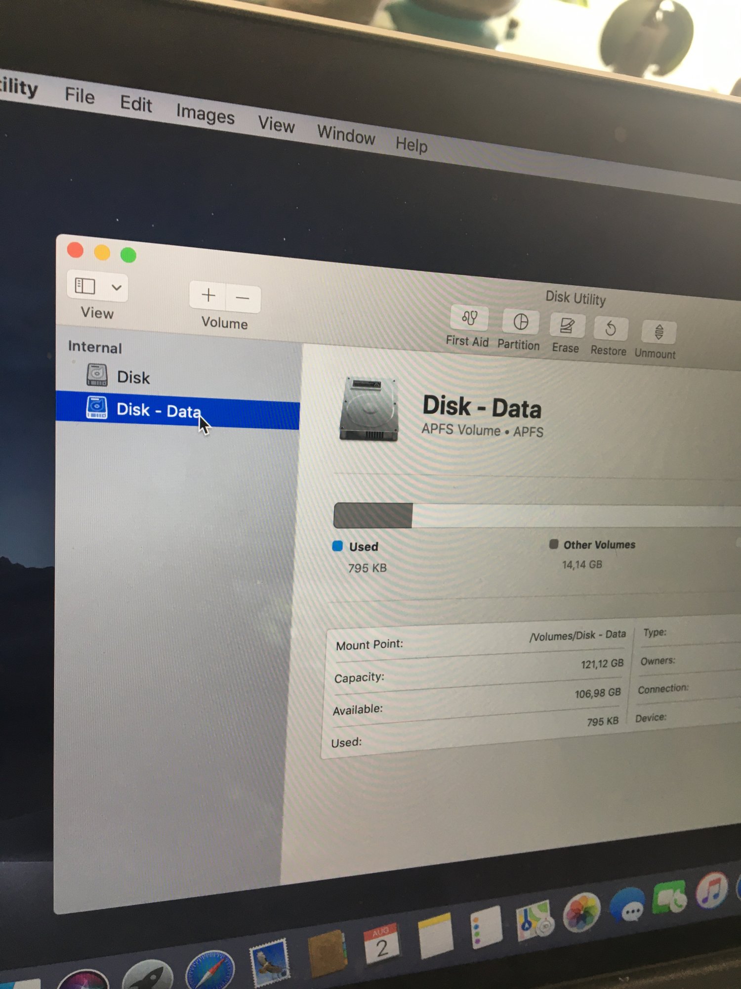

Thanks.... but how can I make only one disk again since I will use Mojave and hate two disks? Now it looks like this in disk utility on a picture - I want to have just one disk again and dont know how to do it... thanx....

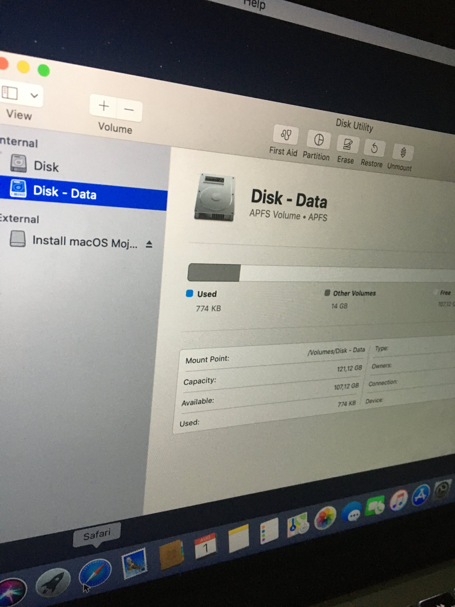

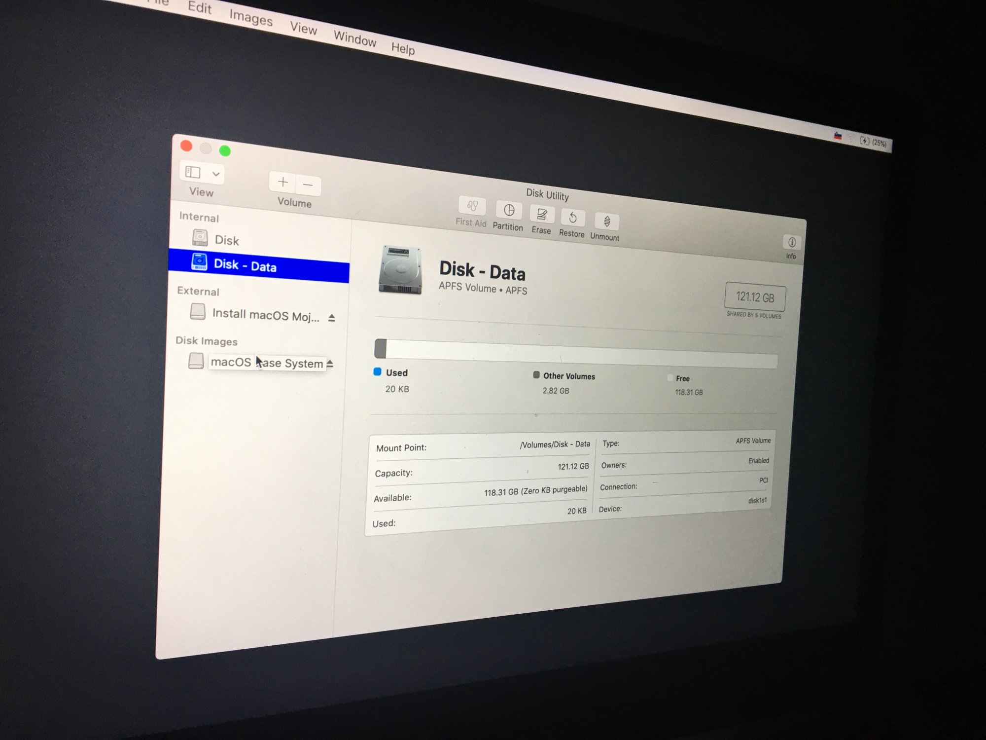

but the “disk” i cannot erase, on the other hand “disk-data” i can erase but what it does Is it is just formatting it.... dont know how to get rid off...

I have USB with Mojave on it for clean install...... When I want to make fresh install, I turn on Mac with alt key pressed on - and then go through process - which include going to disc utility - shoul I be able to delete disc there through that exact process?
yes if you are running the disk utility from the external drive (installer?) you can erase the drive and format as APFS - then install Mojave
- or use macOS recovery to erase the drive

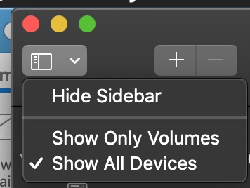

Boot from the Mojave USB, launch Disk Utility, change the View (upper left button in Disk Utility) to "Show All Devices";
Then select the top Internal device (it may be named Apple something) then Erase the entire drive selecting APFS for the format. That will format the entire device to APFS. The erase will eliminate all of the volumes. Install Mojave.
