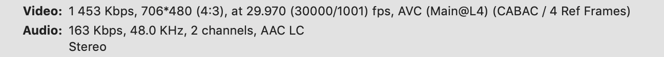

Update. I appreciate all the advice/suggestions so far. After installing multiple video players, converters, codecs, etc... with no success, I guess the files are a lost cause. I did use the Scoop app to display detailed info on each .m4v and all the videos that play had a 'Writing Application' of Handbrake 1.*.* (ex 1.0.7) or greater, the videos that DO NOT play properly have a 'Writing Application' of Handbrake 0.*.* (ex 0.9.5) or 'Writing Application' of CoreMediaAuthoring 700. Does anyone know if older Handbrake versions used a codec the later Handbrake versions did not? Again, thanks for any advice.

What encoding does something like MediaInfo show? Is there a codec difference between those that play and those that do not?
Do they also not play in Windows (which tends to support legacy stuff longer than MacOS)?
