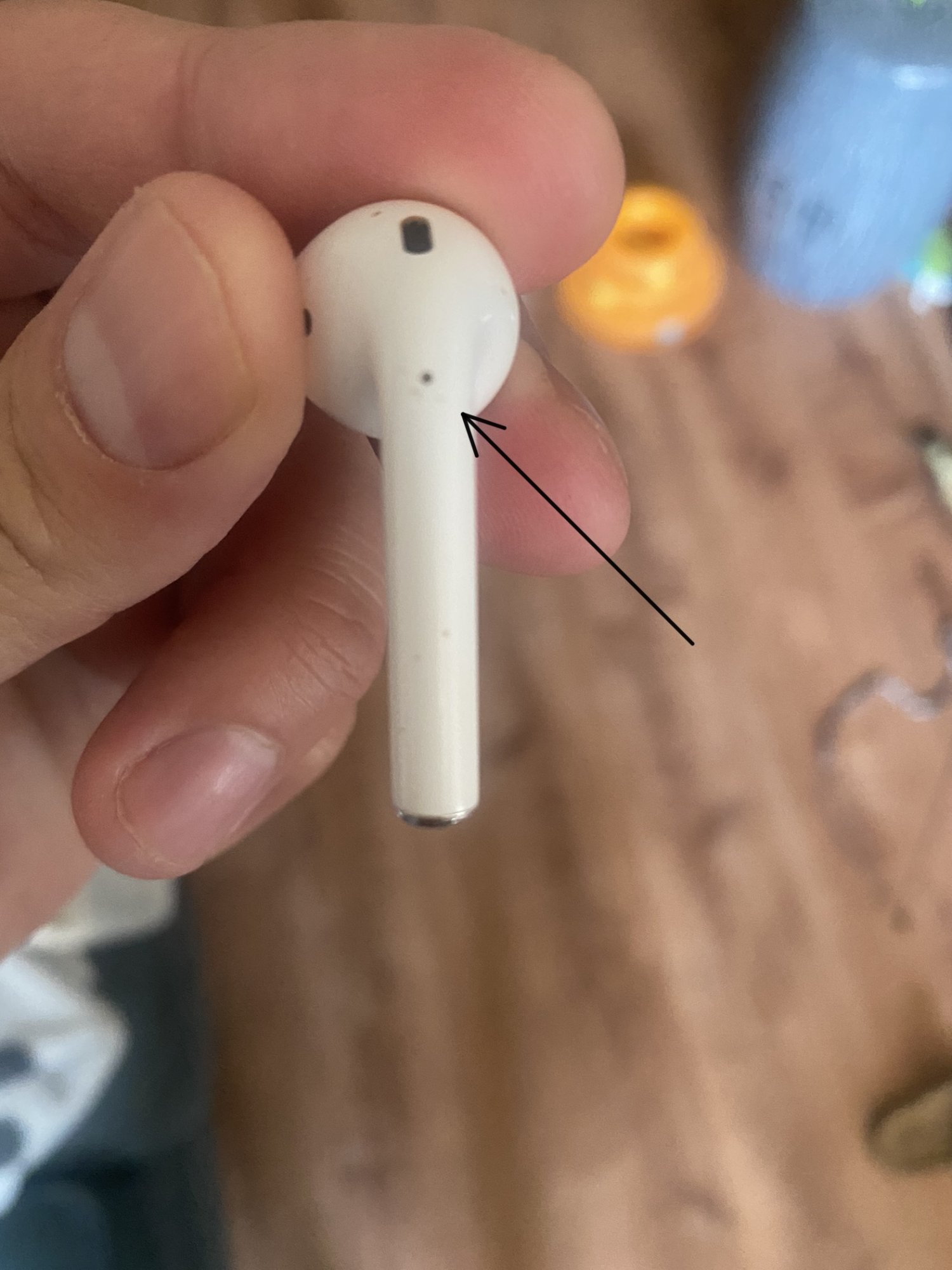

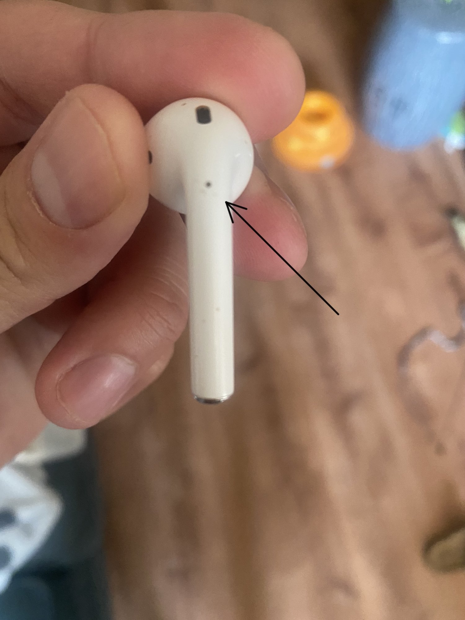

Hey all, I had bought my girlfriend 1st or 2nd generation airpods and they worked great for 2 years. The right one stopped working when it was in by itself. The left one would still work by itself when it was in, and they both worked together. We tried literally every method mentioned on the internet. When I was examining the AirPods there is a small hard reset button on each AirPod on the backside. I used a sewing kit needle to push the button in on the right AirPod that wasn’t working by itself, and held it for 5-10 seconds. Then repaired the airpods from my phone back to hers and that fixed the issue.
I hope this helps someone, no tips and tricks I read had this method in there!

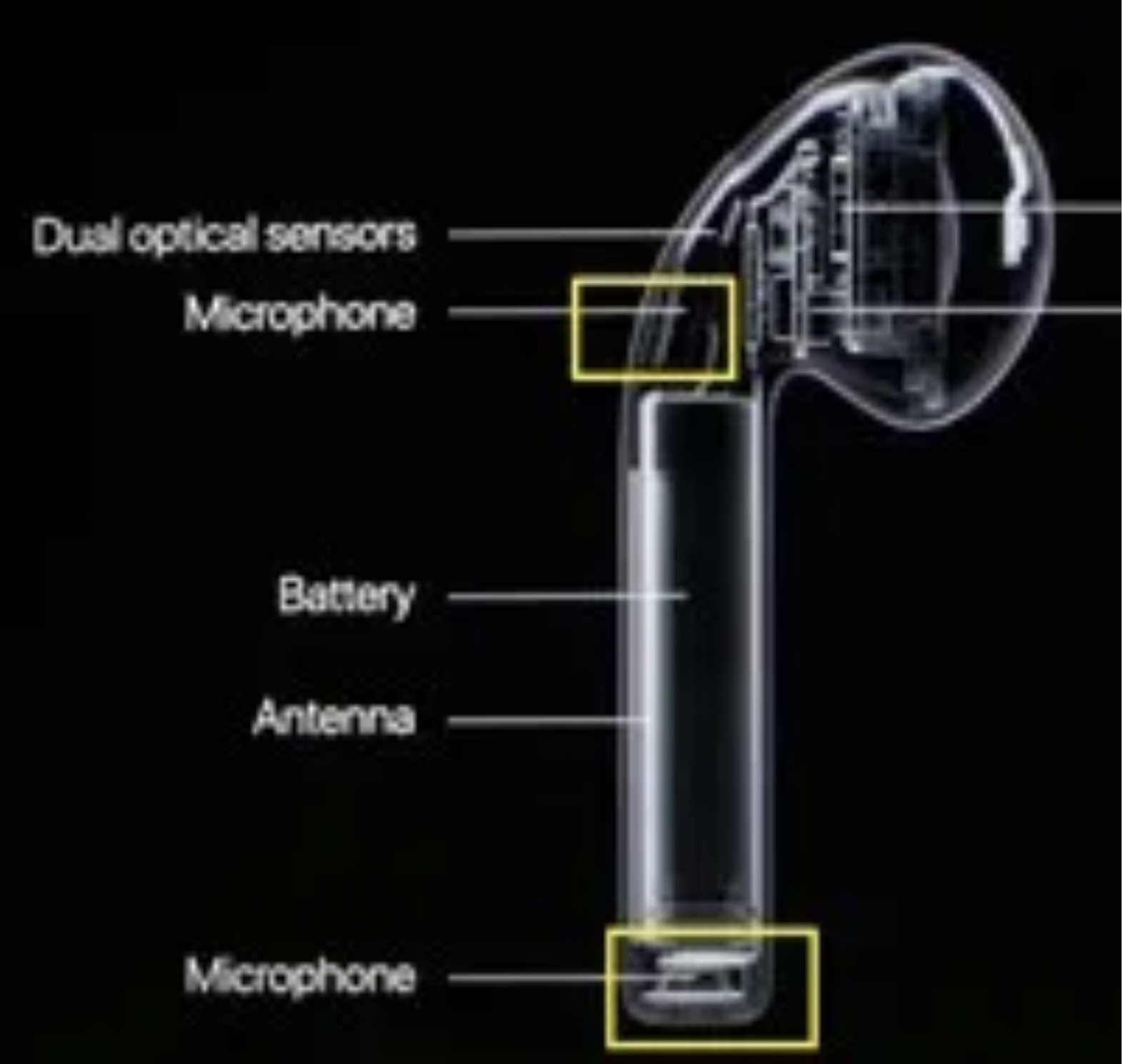

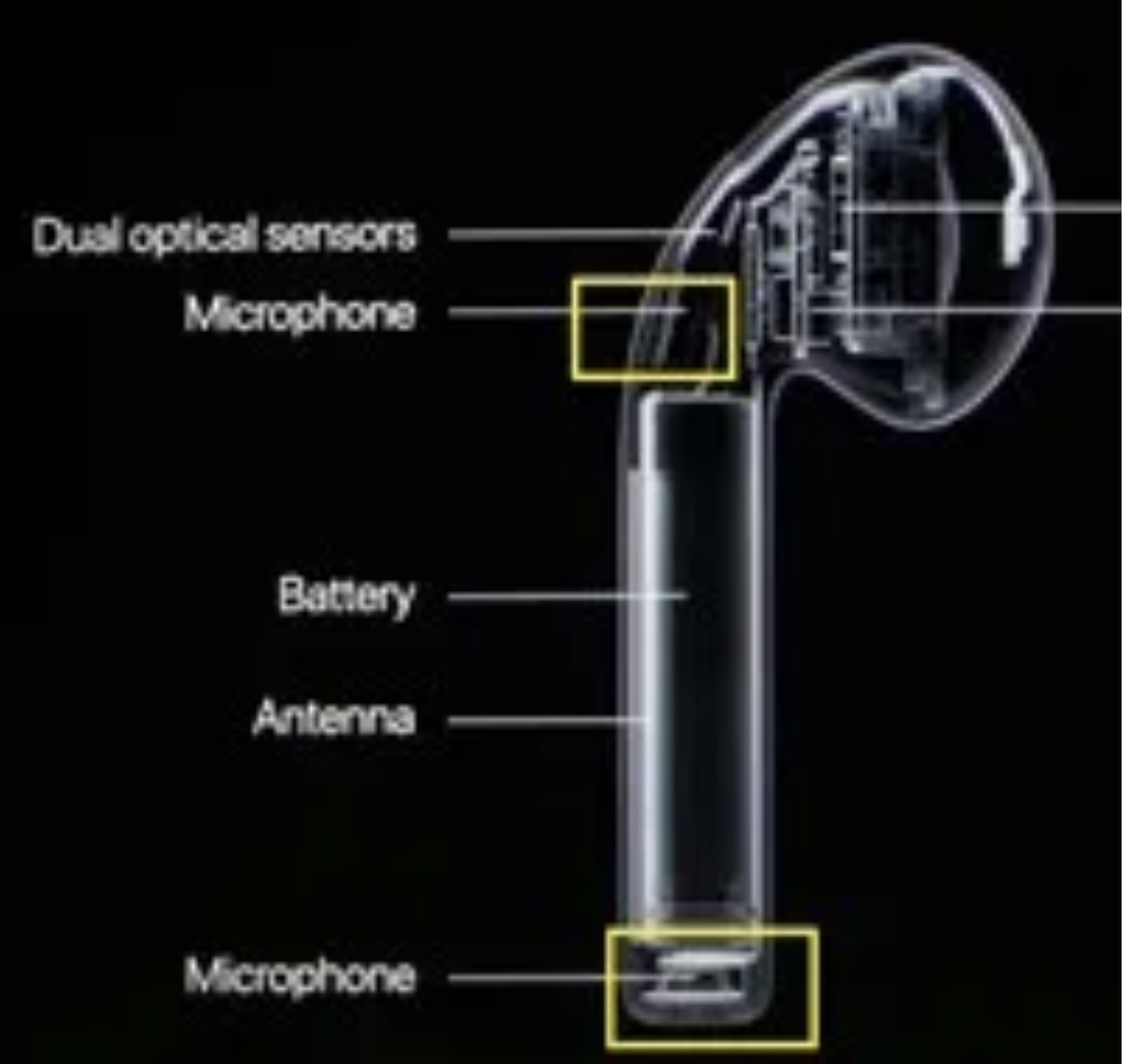

There is no reset button on the Airpods...
It's a microphone. Stick a pin in it and ruin them, but sure... Here's something most people don't know: those metal pieces at the bottom of the stalk are a space alien antenna to call the mothership: if you hold both at the bottom of a swimming pool the mothership will come back to get you. It might take a half hour, but bear with it, and it'll work for sure... 🙄
Begone!
Begone!
🤣🤣 whatever I did it worked. They have been working great for 6 hours now. Not ruined one bit.👍🏻
