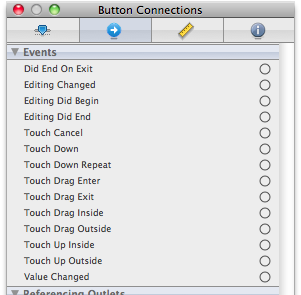

Certainly possible. Connect different IBActions to different events. Look at all the events that are available for button connections:

It's certainly possible to connect different events to the same IBAction method. Whether you can manage them from within that method, I'm not sure. If you are just going to logically separate them within the method though, why not just use separate IBActions to start with?
