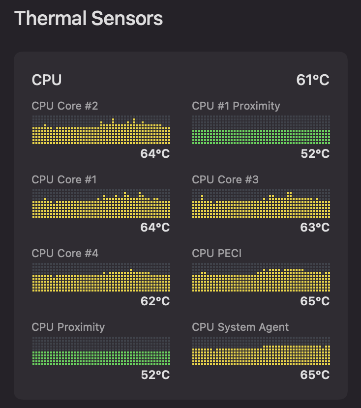

Interesting observation looking at my iMac vs my Mac mini thermals (processor) watching a 720p video on YouTube using the Brave Browser.
iMac:

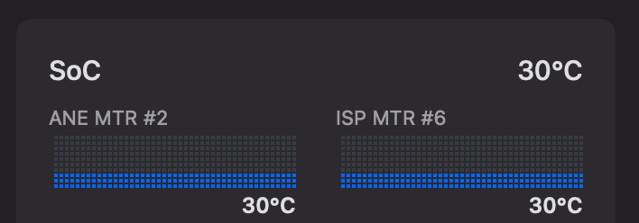

Mac mini (too many items listed to copy them all):
I am very pleased with the thermals so far!

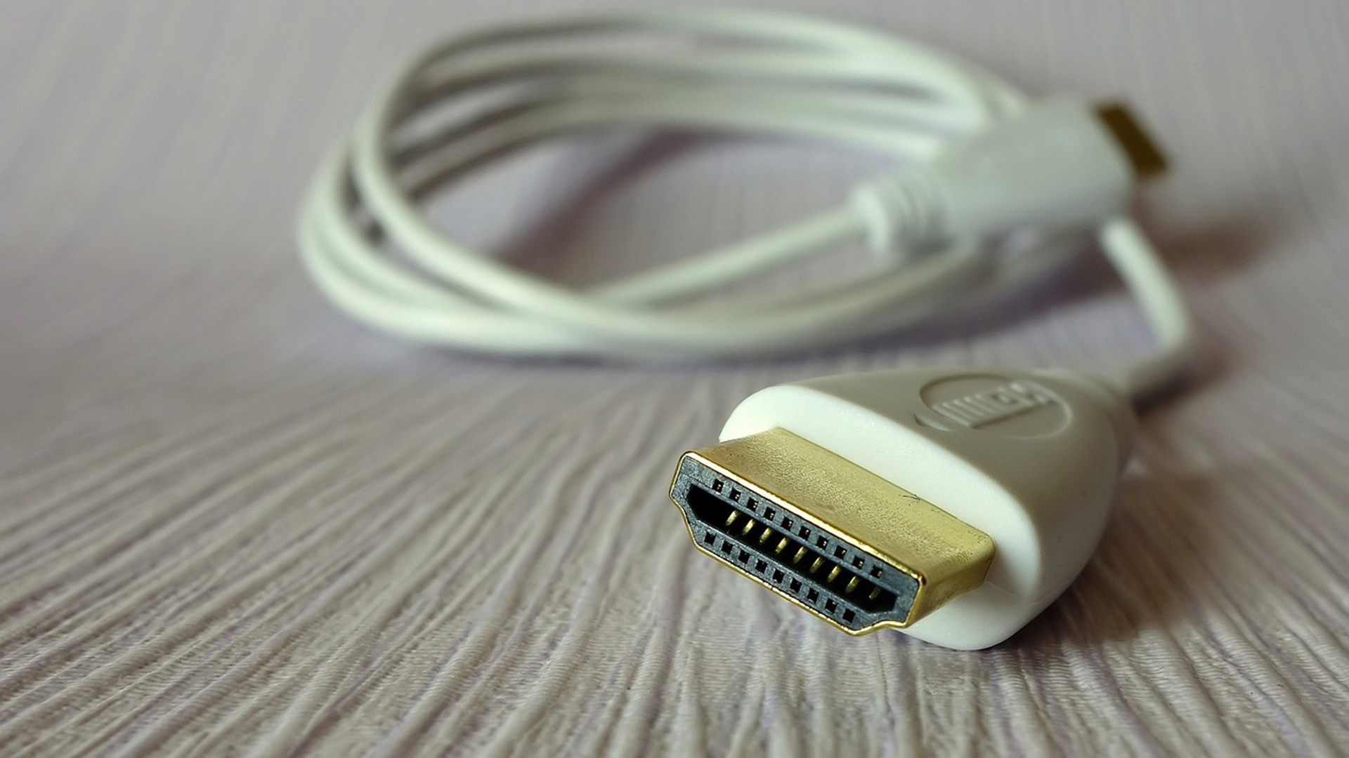

Why do you think the HDMI 2.1 cable from Xbox Series X works but not the cable I got from MonoPrice (which I cannot find what HDMI version it has). It really doesn't make any sense that this cable would be an issue.
That cable you bought says:
10.2Gbps data throughput
4K resolution at 24Hz
Even this cheap one looks better:
18Gbps data throughput
4K (3840x2160p @60Hz)
And still not sure what the fascination is with "slim/thin" cables.
It is definitely helpful when you have dozens of cables around. It does reduce the amount of space the cables use.
Any way to view the actual HDMI versions of these products? Why is it so difficult? And how would someone know which cable to get?

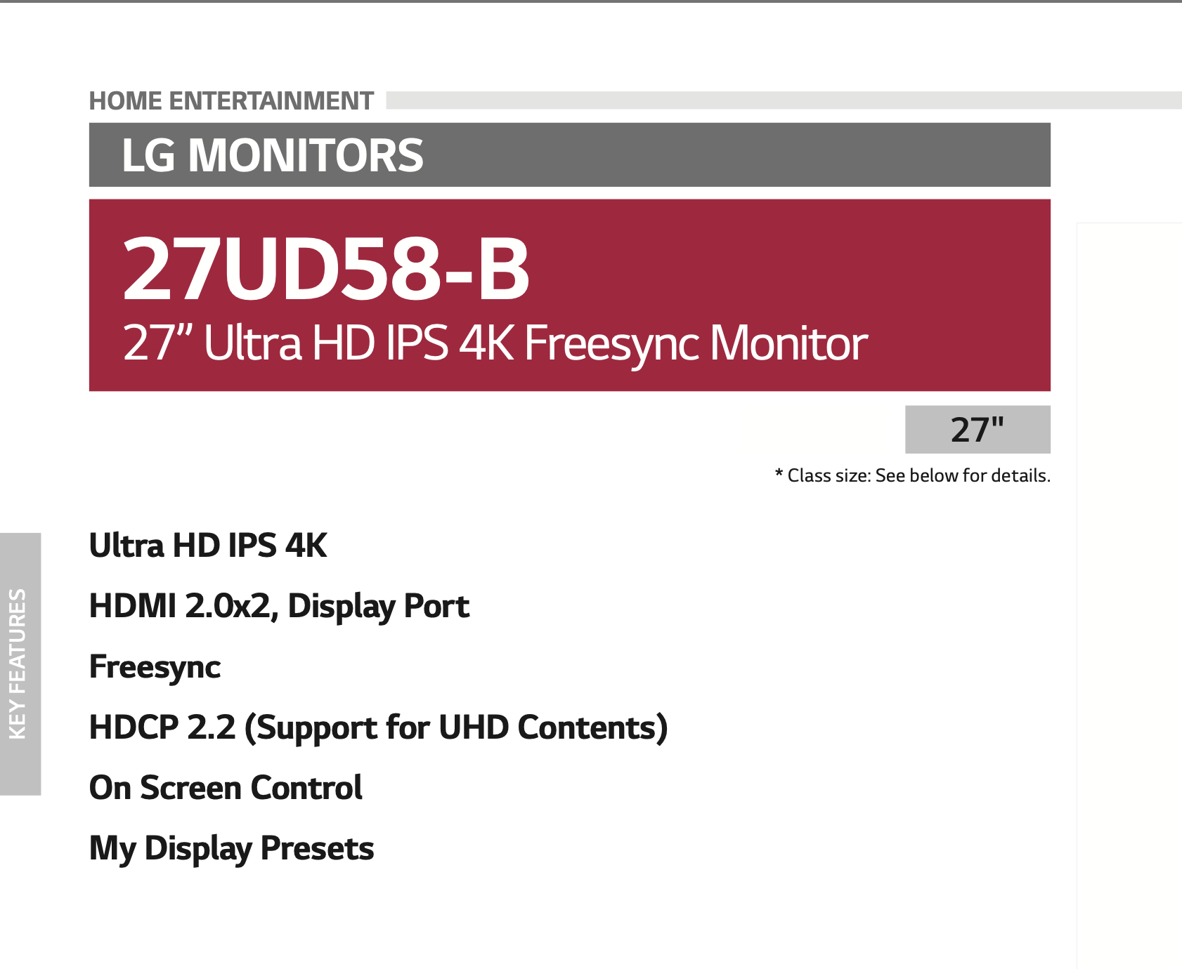

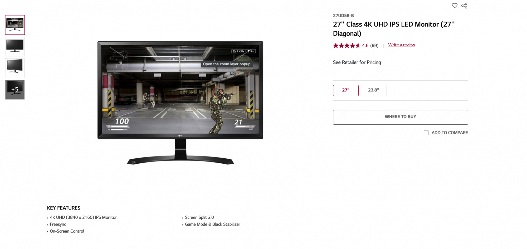

I really do not like HDMI and DisplayPort. Who made the idea of making hidden versions on the ports and cables? Here is the monitor I have: https://www.lg.com/us/monitors/lg-27UD58-B-4k-uhd-led-monitor
So I cannot find what HDMI port my monitor has, and I cannot see what HDMI version the cable I got from MonoPrice is. Why do they make these things so incredibly difficult?
It’s a 4K 60Hz. It’s an HDMI 2.0, just like your Mac Mini.
I use these for TVs, displays, whatever require HDMI : https://www.audioquest.com/cables/digital-cables/hdmi-4k-8k/pearl
It’s the cheapest from Audioquest. They make HDMI 2.1 too, but the Mac Mini will never be able to get to this because it only supports 2.0. So no need to go that high. And no need to go high grade at audioquest, sincerely. There is a limit. Not sure you can see the difference between AudioQuest 2.0 Pearl and the highest end one at 1000$ for 6 ft. But the basic Audioquest pearl is a top notch quality HDMI cable without an idiotic price.
It’s a 4K 60Hz
