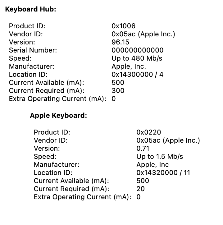

Upgrading from a late 2014 iMac (can't believe it's been so long since an upgrade!) and was really confused when my normal wired apple keyboard wasn't recognized. Not even showing up at all in System Information. (The one with silver body, white keys, like the current keyboards but wired and no touch ID).
Did lots of testing. An even older apple keyboard was recognized (PowerMac G5 era? clear case and more mechanical white keys). A pc keyboard was recognized. Finally found an identical wired keyboard to my iMac I had stored away and it WAS recognized.
This is what is showing in System Information for the keyboard that is recognized. The one that doesn't show up on the Studio, shows on my iMac as the same except "Apple Keyboard" version is "0.74" instead of "0.71". Any ideas why the 0.74 one wouldn't work? It's less used and cleaner so I'd preferably continue to use it with my Studio. 🙂

Further testing, the v74 keyboard doesn't work on a 2021 MacBook Pro via USB-C adapter either! While the identical v71 does work!
But here's the kicker. I did get the v74 to work with a USB extension cable! So is it something with the contacts on that keyboard and the newer machines? I thoroughly examined the contacts of the USB-A connectors of both keyboards and don't see any difference.
And the final weirdness: The v71 shows up on the MacBook via the USB-C adapter and USB-A extension cable, while the v74 does not!
So v74 keyboard:
- works on iMac
- works on Studio only through USB-A extender
- won't work on MacBook Pro no matter what.
I guess the most likely explanation is the keyboard is somehow faulty. Maybe it's the USB plug (more likely?), maybe it's something internal (less likely?).
Since I can use it on the Studio via extension cable... I think I'll just let it be. Just never realized it was faulty as I've been using it for years on my iMac! Typed this post with it in fact.
