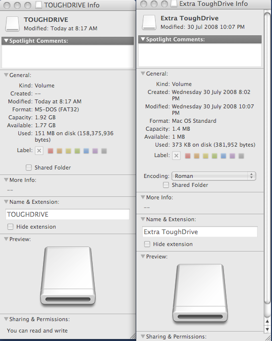

My FD (Toughdrive) has two partitions: one formatted as MS-DOS (FAT32) the other as Mac OS Standard, hence the drive appearing twice on the desktop. I assume that it was partitioned by the manufacturer. How do I get rid of one of them as formatting clearly won't work? (It's irritating as I have to eject "both" every time.)

It's not a HDD. it's a Flash Drive (or two)

I got this on my old pen drive, the manufacturer puts recovery tools on one partition, and leave the other free for all your data.
On the recovery partition, the recovery app (probably windows only) will allow you to erase the recovery partition.
That's what I did, I had the same problem too, disc utility wouldn't remove the other partition because it came up as 2 completely separate drives...
