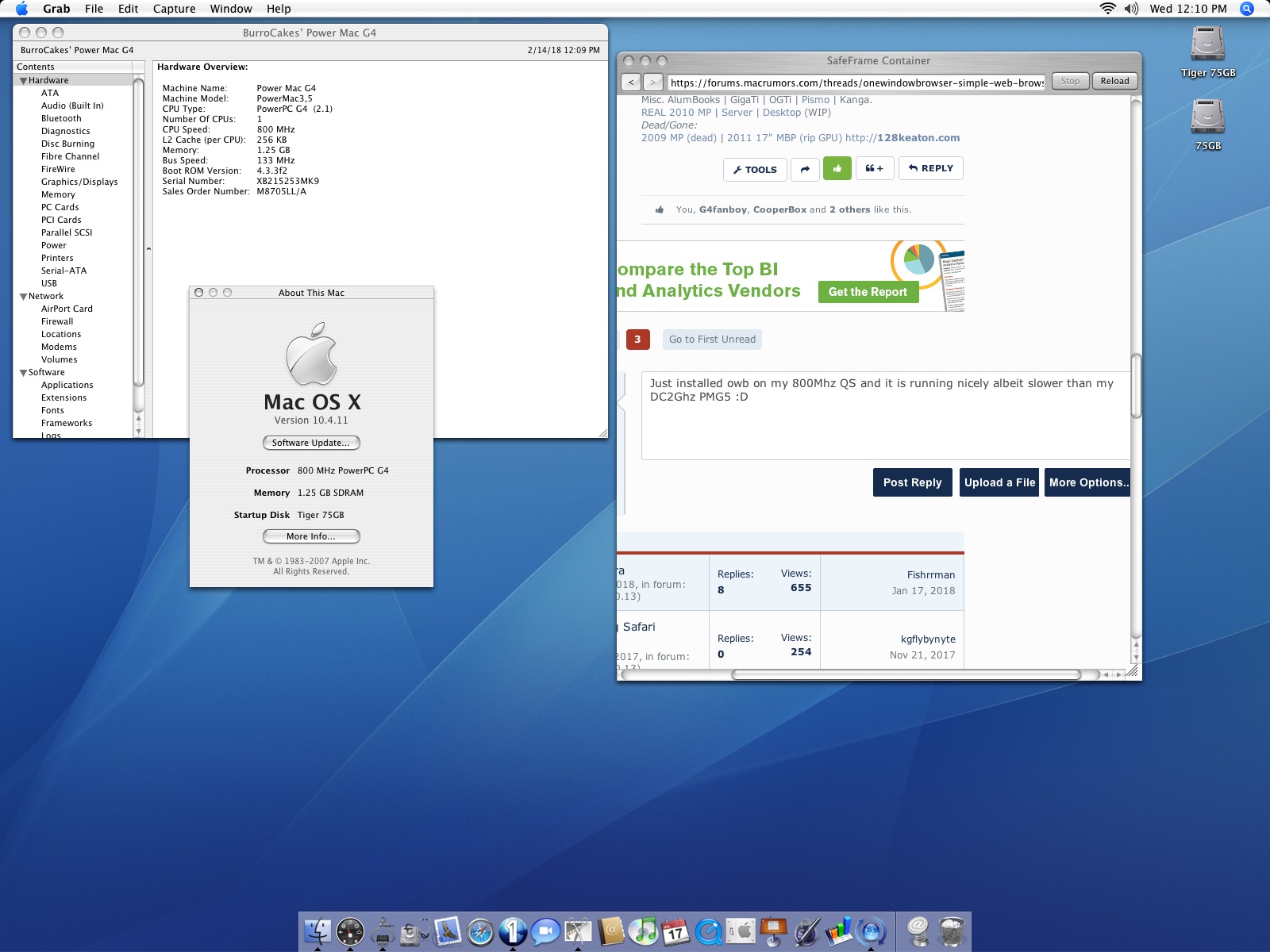

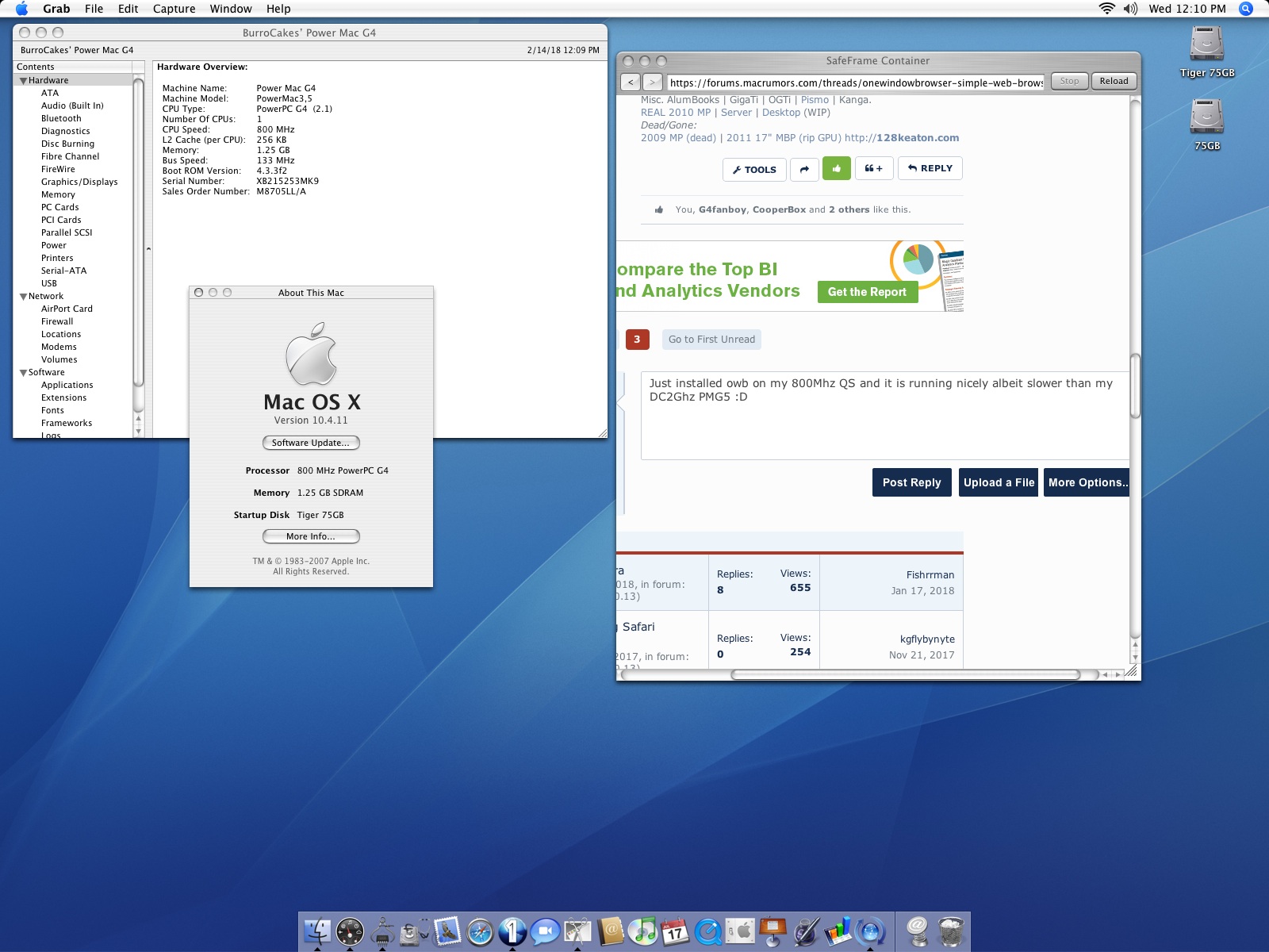

Just installed owb on my tiger 800Mhz QS and it is running nicely albeit slower than my leopard DC2Ghz PMG5 😀 A nice surprise was that I am not getting the full onslaught of banner ads but assume they will show up as the box "updates".
Also, buttons seem to be fine now although Im a ding dong evidently as I still cant figure out the picture thing. Fun browser though 🙂
Go Quicksilver! Both of these observations are due to the default user agent, which is iPad 3.2.2. There are fewer ads being pushed down the pipeline. You can stop the ads entirely by switching off JavaScript (which also speeds things up dramatically on a G4 or G3), but you lose text formatting options in your posts. You can manually format with MR’s bbCodes, but that’s another story.
To get the afforementioned drag and drop file uploads, MR seems to require the User Agent to be set to a Desktop profile. You could try the default UA for Tiger’s Safari (via Safari’s hidden Develop/Debug menu) or a generic Firefox one.
I will put a few of these options into the next update.

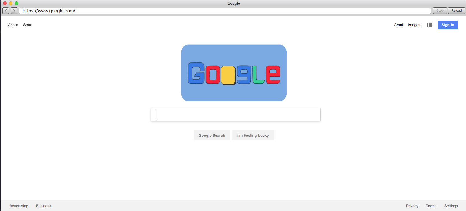

Err I still use IB just with a custom NsButton+Cell class. Check out https://github.com/128keaton/OneWin...buttons/OneWindowBrowser/NSCurvedButtonCell.m

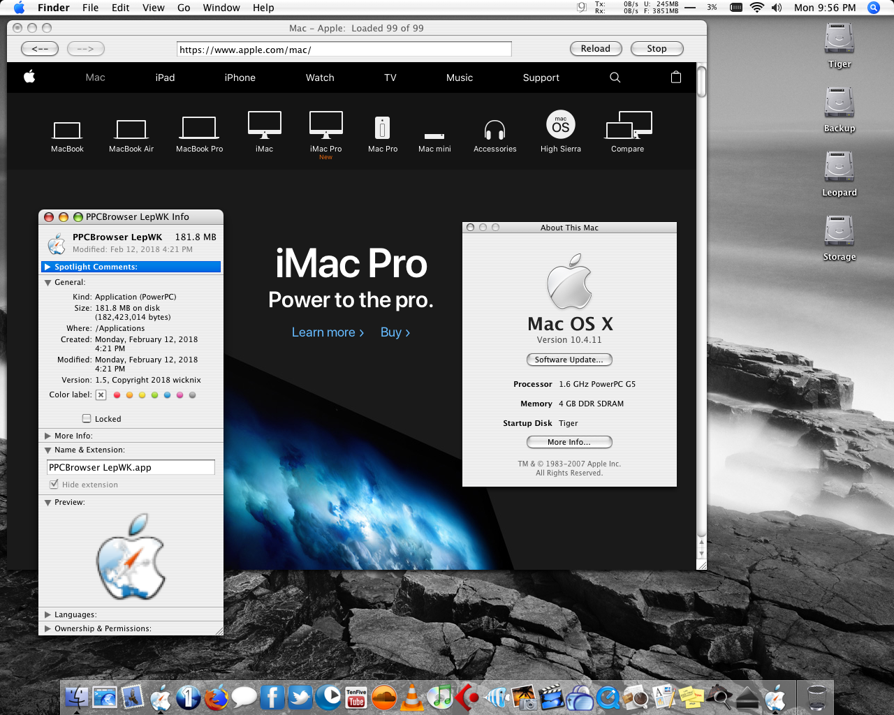

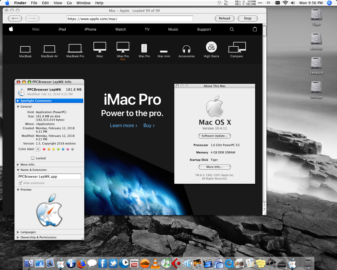

Tiger users *might* be able to after all. For the sake of curiosity i relinked my PPCBrowser.app with Leopard WebKit, copied it over to Tiger, and low and behold it launched! No errors, nothing! I haven't put it through it's paces yet, but it browses with an iPhone 10 user agent pretty happily. It does not work with any web based media like streaming audio or video, but page rendering seems legit so far. Now maybe it has no effect at all, and i just created a 180mb browser that's only as capable as the original 200kb browser. Just thought i'd share my findings. See attached photo.
Cheers
Cheers
Very interesting. Is there any way to confirm that the LWK is in use when run on Tiger? It may be just being bypassed.
I tried the same process of relinking LWK with 1WB and then moved it across to 10.4 and it runs, but I am not sure if the modern engine is in use.

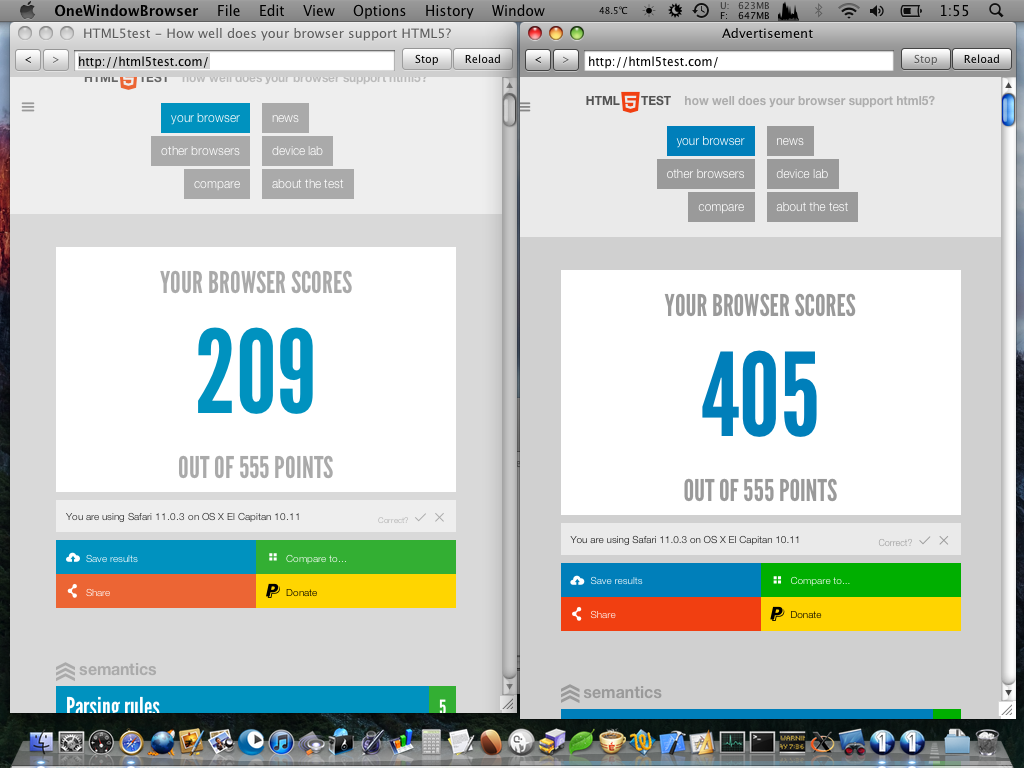

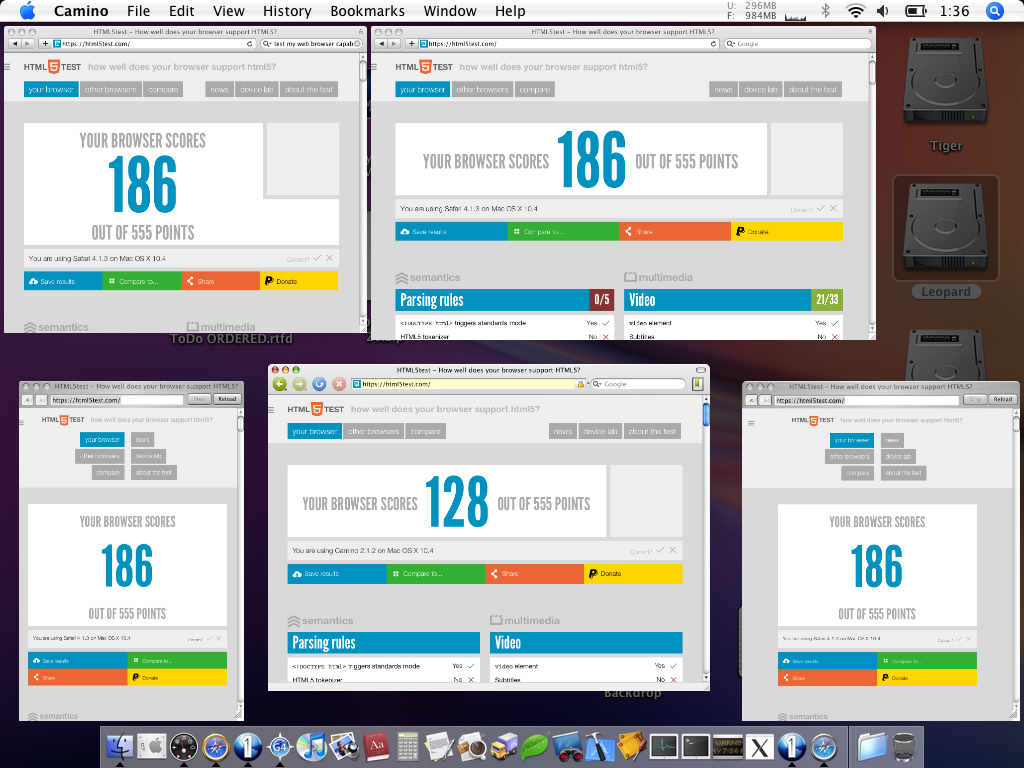

I ran the browsers through https://html5test.com and on Tiger, Safari 4.1.3, TenFourKit (533+), 1WB and 1WB LepWK all scored 186 when using the same UA (Safari 4.1.3 Mac).
Camino 2.1.2 scored 128 on the test. I'll reboot and see how Leopard goes.
[doublepost=1519142428][/doublepost]Here's Leopard's score with 1WB base on the left and 1WB with the LWK relink on the right. (Using the current Leopard Webkit v604.5.6)

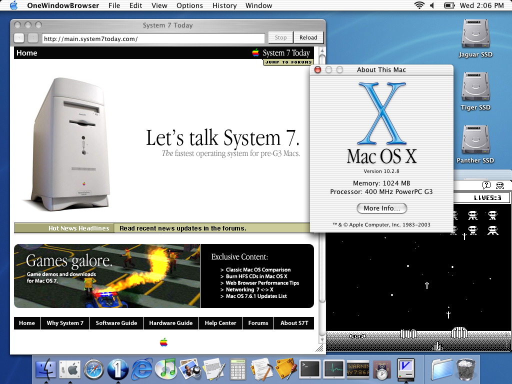

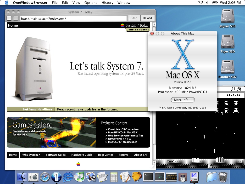

Here's my Pismo running Jaguar with one of the very few compatible websites I could find. (LowEndMac and Mac Garden worked too, along with any website which hasn't been overhauled for maxium profitibility within the past 10 years). Unfortunately, Jag and Panther can't handle the web bloat in any capacity, whereas at least Tiger and Leopard will give it a try.
(Snuck in a quick game of Invaders in mini vMac while I was at it 😉 )
