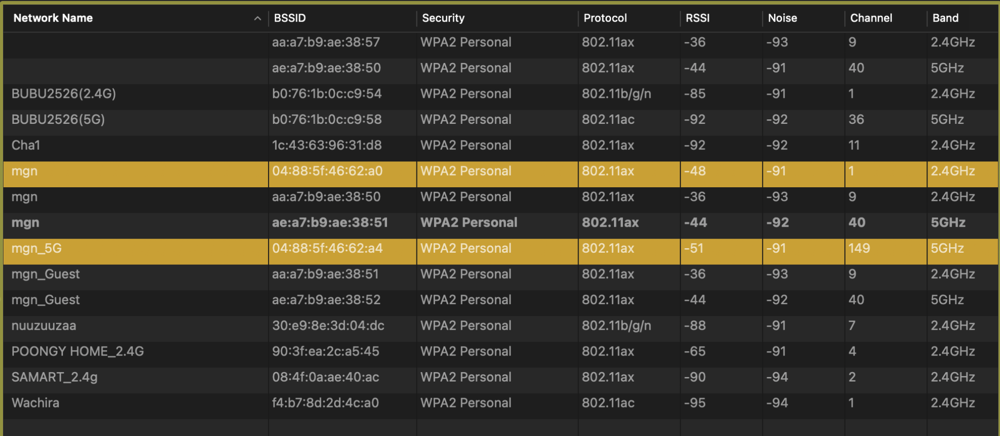

I may have solved this. In the WiFi stumbler table below you can see that there are duplicate SSIDs. The highlighted SSIDs are from the Huawei device. When they put it in bridged mode they forgot to turn WiFi off. I'm guessing that's what caused the HomeKit devices to fail.
Based on the MAC addresses in that screen shot, it appears likely the Huawei is still broadcasting wifi and still has the SSID/Pass of your primary network. Of course, this is assuming that the network is the one called mgn. Two different networks, same wifi username and pass within the same space is problematic for a number of reasons. I'd start there.
Reactions: Buadhai
Exactly right. Looks like we posted at the same time.
My guess: The other devices are still affected, but what you get is a quick disconnect as they bounce between the two LANs. You may not even notice this issue. However, Homekit devices require a connection to your Homekit Hub. If they are bouncing between the two different LANs within the home, they may never be able to establish communication with the hub. That hub, if hardwired, only exists on the LAN it's plugged into.

I'd forgotten about the connection to the home hubs. I'm sure you're right.
Thanks for the clear explanation.
