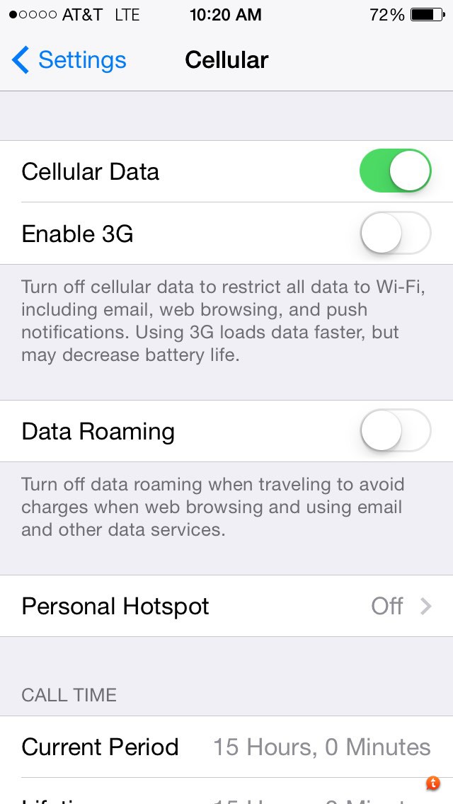

Yep happened to me. I did multiple full system restores and eventually LTE came back, but toggling it off will put it into 3G and it won't toggle back, so I can't turn off LTE until the next beta.

It didn't work. Once I went to an area without LTE, it dropped down to 3G and never went back to LTE. I guess we're stuck with LTE for the next few weeks until beta 3. Life of beta testing. 😉

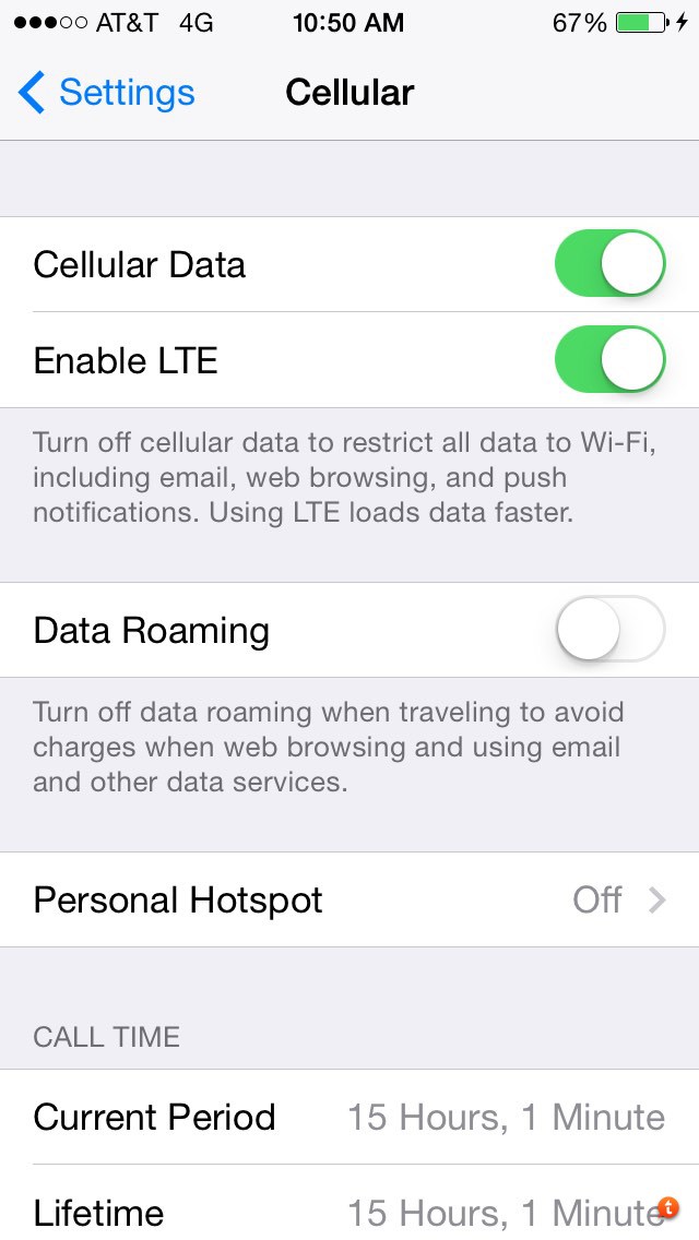

A good thing to do w/ Bata is setup as NEW and/or do a hard reboot ( home + power) this usually fixes most problems..
In this case just turn airplane mode ON for a min then off. It'll "Searching.." Then you be back on LTE

They replaced enable LTE with 3G, this is obviously an error.
I'm getting 3G speeds (ran speedtests), not LTE, and no amount of rebooting fixes it. I really think it's actually stuck in 3G, at least mine is.
So I nuked the phoned last night DFU style and installed a fresh copy of beta 2 and now I have my LTE back along with suprisigly less glitchyness in the OS. Good stuff. I recommend this for everyone with this problem.

I tried a clean install last night after having no LTE on an OTA install of b2. My observations were:
OTA b1 to b2 HAD LTE at first but lost it over night. wouldn't come back.
Clean install of beta 2 via iTunes and phone in recovery mode, set up as new HAD LTE. Seemed ok.
Restored from ios7 backup via iTunes and LOST LTE.
This leads me to think the issue is with something being carried over from ios7 update.
My next step is to reset all settings in ios7 then update to beta 2, see if that gives me LTE. I'll try this at the weekend tho.
Checked EE (UK) carrier version at each stage and was 16.0.2 on beta 1 then 16.0.4 for beta 2. 16.0 now on 7.1.1

See i had LTE on beta 1 despite the terrible reception. It was on Beta 2 that over night like you said I lost LTE. When I DFU'ed the phone I restored form the back up I make from Beta 2 before nuking it, and it seems to be working quiet well.
