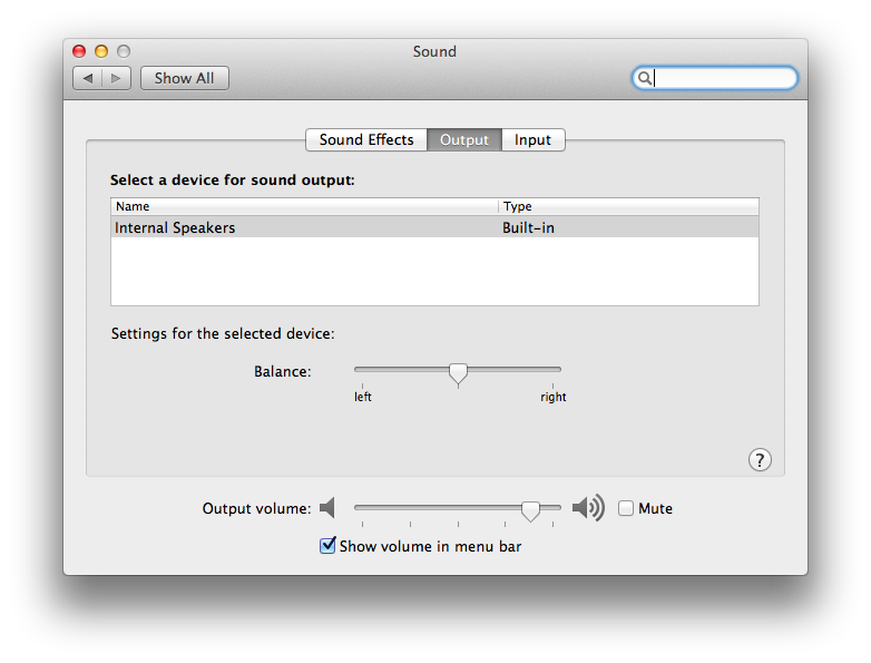

Are you sure it's a hardware problem? Have you checked the balance in your sound settings? You could also get some compressed air blow it in the jack with the opening facing down, something could have gotten in there and is keeping you from getting a good connection.
If all else fails you would probably need a logic board replacement since the connectors are built into it. At least on the newer unibody models.
Be sure to make sure that your balance is set in the middle on system preferences.
Reactions: Snaify
Also note that balance is independent of output, so just because it was working fine with the internal speakers doesn't mean it still can't be the balance with external speakers. OS X will remember the setting for each and automatically adjust them based on what output is selected.
