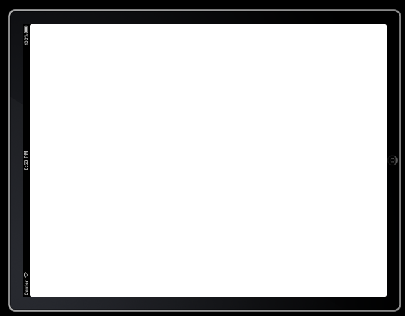

yes,it's running WITHOUT the modalviewController,I didn't see the SplitView displayed either.
the pic is:
Well, then I'm quite sure that your modal viewcontorller view outlet is not set 😉

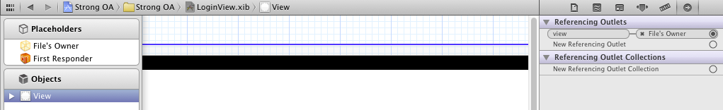

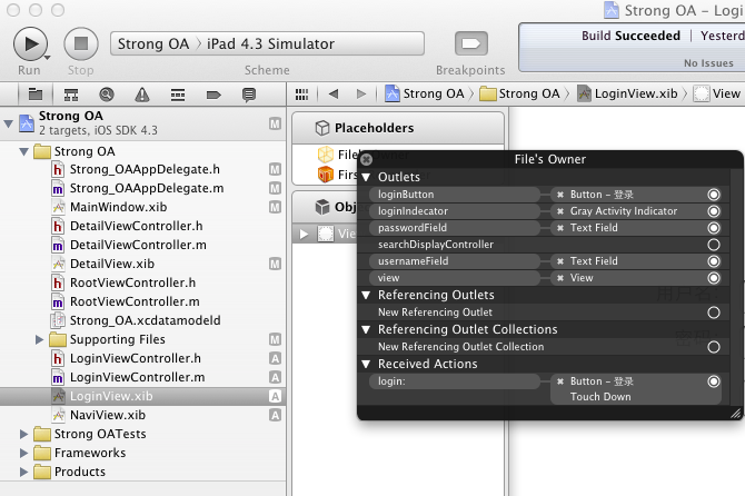

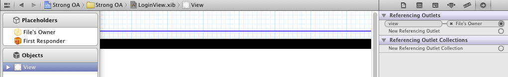

okay,please look at the pic which I uploaded:
right click the File's Owner:
click the View object,then the Connections Inspector is:
You got me there, There should be something at least going wrong, since I don't have problems at all ;p I tried it myself yesterday, and tadaaa 😛 It works.
if u NSLog the pointer, does it contain a Reference to the memory adress, or does it return (null).
Beside that problem, I see you have a login button on "touch down", didn't you mean "touch up inside"? 😛

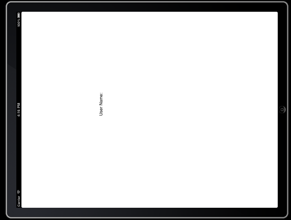

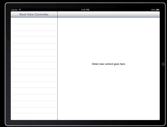

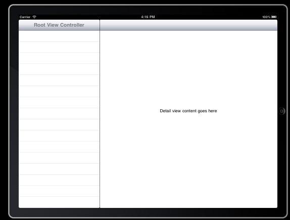

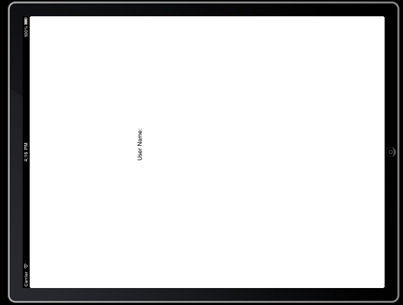

before pop the modal win:
after pop the modal win:
how can I let the modal's direction same with the prior case?
BTW:I set "supported device orientations"="Landscape Right".
So you got the Login Modal to work?
And erm, is your view setted up as Landscape (in the XIB). And you do a return LandscapeRight, Also do a LandscapeLeft 🙂
or just set in your project settings your app to only support Left/right, and then set the return type of the - (BOOL) shouldAutorotate bla blah.
to return YES;
to return YES;
