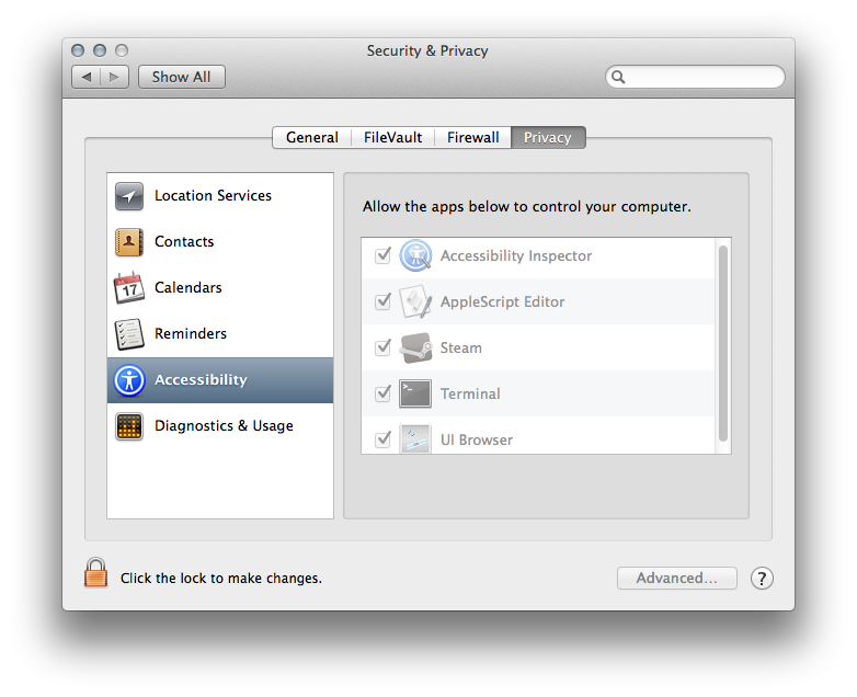

Note : Change "JPEGmini Lite" to whatever you're using e.g. how it's named in the Applications folder. You need to give access to the UI in the Privacy --> Accessibility section for Applescript Editor and/or Terminal. If you're on Mavericks it will ask you to do so on the first run of the scripts.
