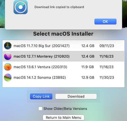

Anyhow I can download with the other option where is says copy link, but no instructions what to do from that point?
1.Do I drag the downloaded file to the USB, then open it, or do I open then drag it to the USB?, thanks.

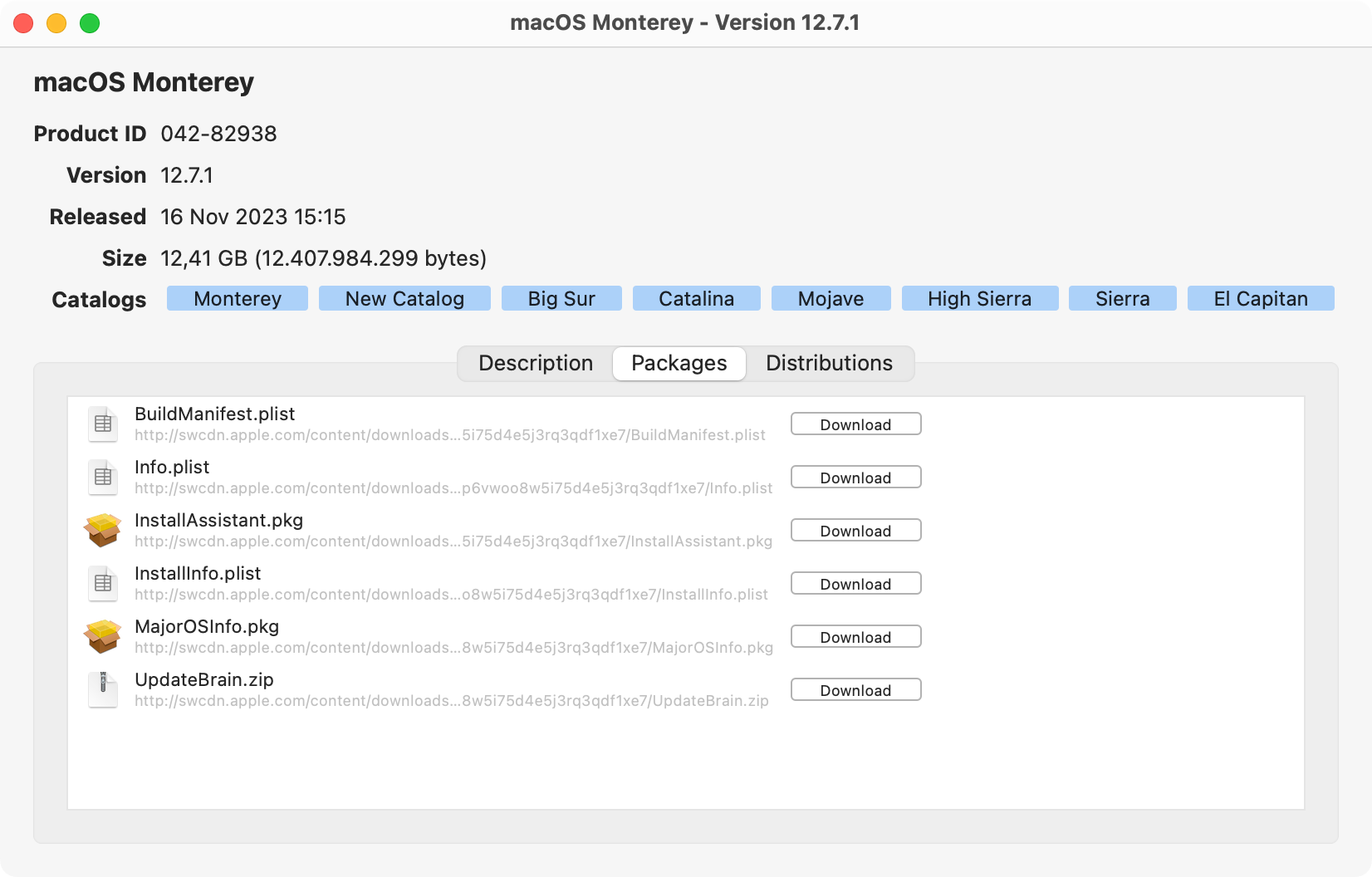

Apple re-issued all installers for still supported macOS releases back in the 16th, maybe OCLP is linking to the old releases, get it via the official way:
Then you just create your patched OCLP installer via "Use existing macOS Installer"

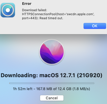

DOWNLOAD FAILED:
HTTPSConnectionPool(host='swcdn.apple.com',port=443): Read timed out
From what I was able to pull from google is this. Website have anti scrapping protection mechanism that would make your request hang if flagged as scrapper.
You could get flagged as a scrapper based on time and/or timing. If the server sees too many requests from the same IP in set amount time, it could deem you a robot.

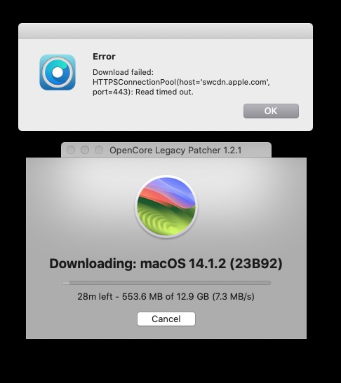

I have absolutely the same problem. I have an iMac 27", late 2012. I was able to follow the instructions so far. However, I get the error in the opencore legacy patcher (error the same in all versions): "Download failed: HTTPSConnectionPool(host='swcdn.apple.com', port=443): Read timed out." Does anyone have a solution to the problem?

Seems like it's internet related. After quite a few attempts it finally fully downloaded. but for sure you can download a more reliable download where it gives you the option to copy the link. When Monterey is downloaded from the copy link tab, just drag it to the Application folder then Opencore app will see it.

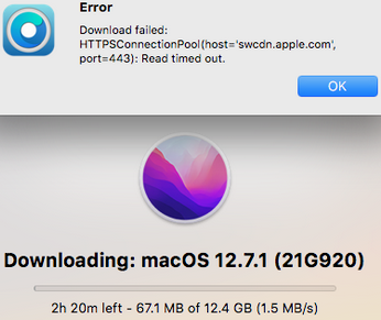

Create Mac installer worked great the first time. But now I get this error now.
DOWNLOAD FAILED:
So is there a way to bypass this ? I've tried about 10 times to download Monterey, even installing older versions, and about 2-3GB in I get this error ?

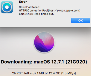

DOWNLOAD FAILED:
This happened to me today and even after reinstalling Monterey it still did it so i finally logged out of my AppleID and that got it working again. Makes sense? I don´t know. Hope it helps someone...
