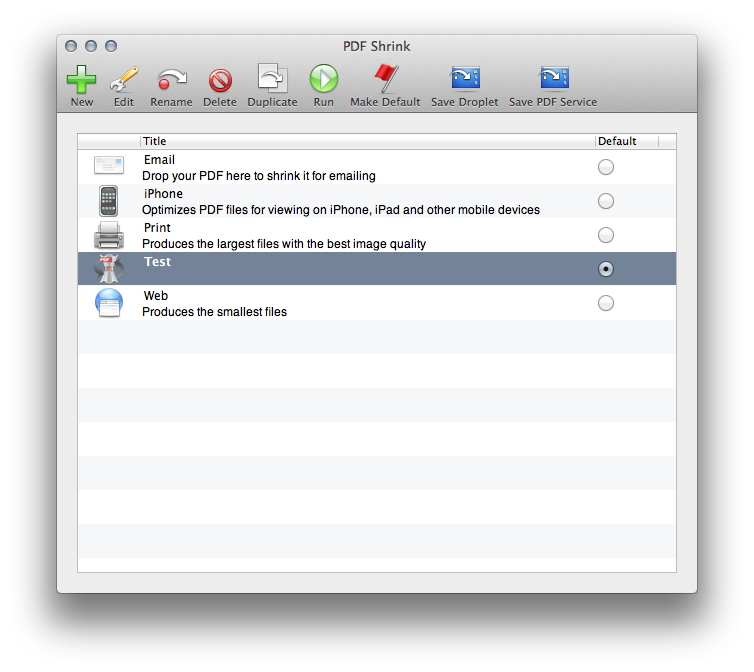

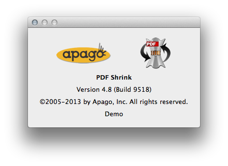

I made a test droplet in PDF Shrink Version 4.8 (Build 9518) and dropped 5 PDF files on it. Works just fine here. I even made a screen recording to show it in action.

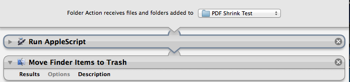

You should have mentioned that in your first post. Anyway, here's a possible solution :
In Automator create folder action :
  1. Folder Action receives files and folders added to your folder
  2. Run AppleScript action with the following code

  3. Move Finder Items to Trash

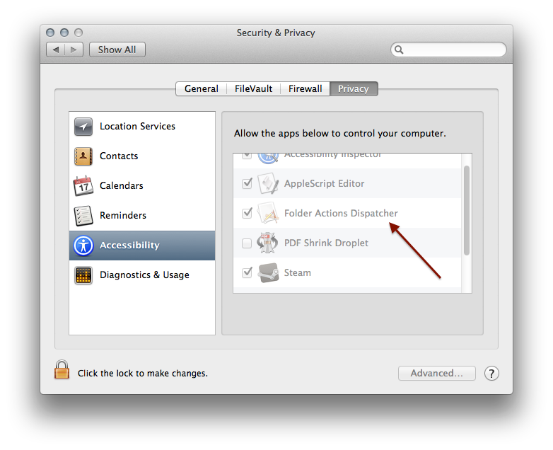

Note : Tested on OS X 10.9.4. You'll need to allow Folder Actions Dispatcher to control your computer. I'm stressing that I dropped files into the hot folder. If you want to process folders as well you'll need to change the script. It is good practice to leave the hot folder empty after processing. This avoids repeated application of the action to the same files.
