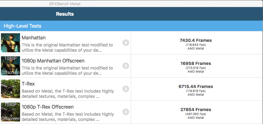

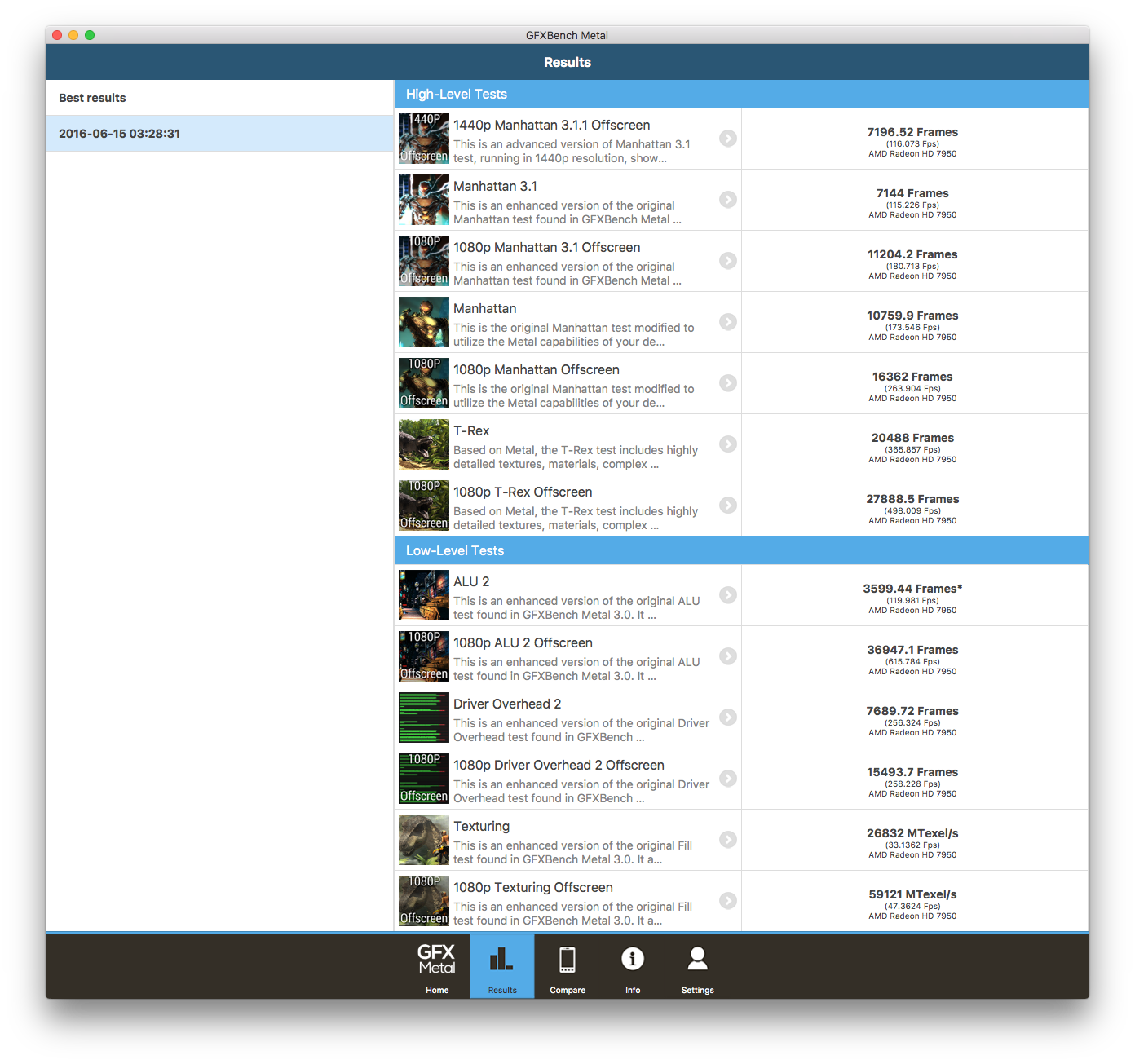

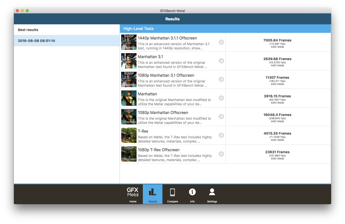

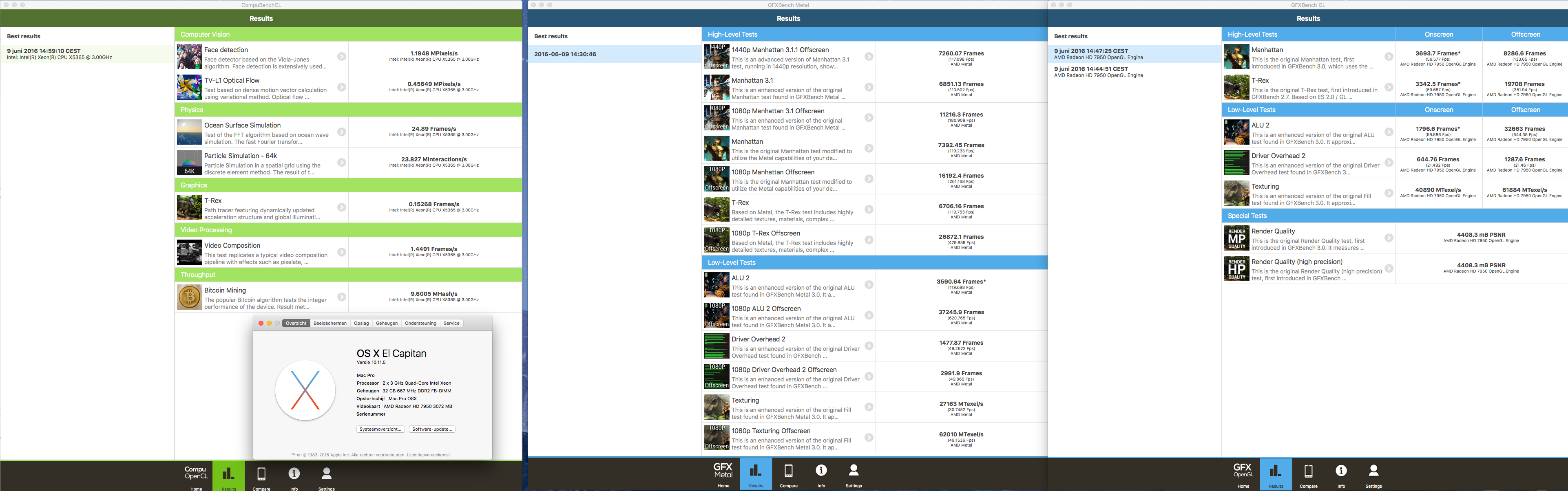

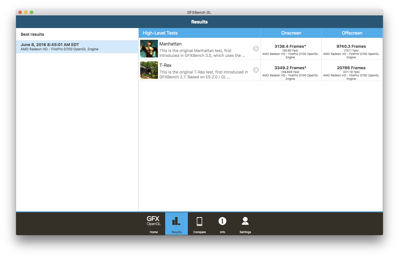

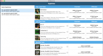

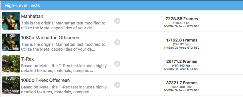

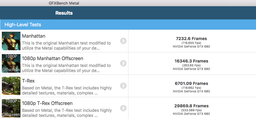

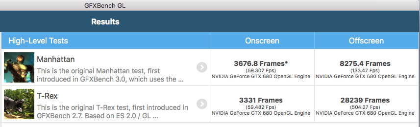

Here are some tests results from GFX Bench on my old upgraded Mac Pro 1,1. Onscreen tests were at 1080p, the highest my monitor will go.
Would like to see what results others get with newer Mac Pro's, etc.

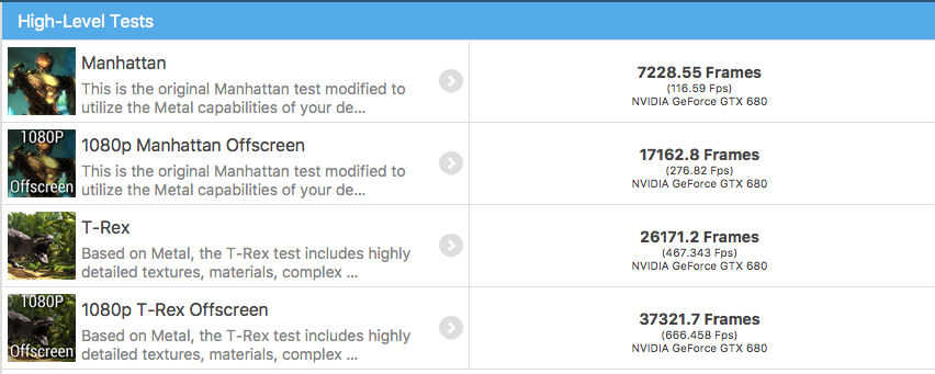

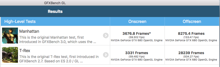

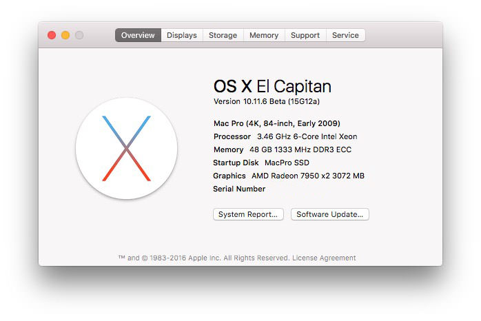

Mac Pro is in my sig. Tests were done on a 1440p monitor. (Running 10.11.5)

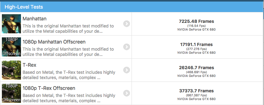

Added two more results; running Sierra Public Beta 1 using Apple's stock Nvidia driver (355.10.05.05b04) and Nvidia web driver (367.05.10.05b07).

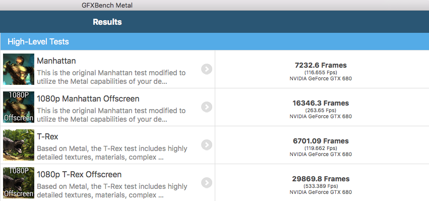

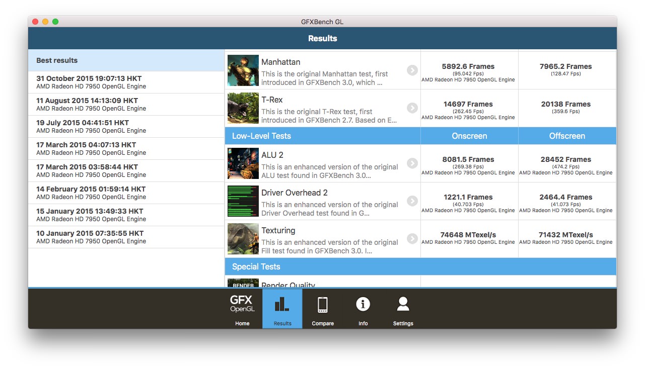

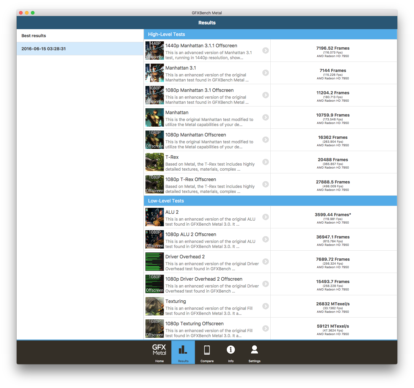

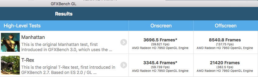

Well it seems with one card, the 7950 all perform about the same with Open GL being about 60 FPS and Metal about 120 FPS. If you have two though the Open GL rocks! I find it interesting that my old 1,1 is on par with the 5,1's in this program, wish I could run the higher res to see just how close they are.
My understanding is like perform in "headless", so, won't affected by something like v-sync (cap at 60FPS). The offscreen result should be more accurate.
Yes, headless. An offscreen benchmark runs in memory at a resolution that the screen doesn't support.

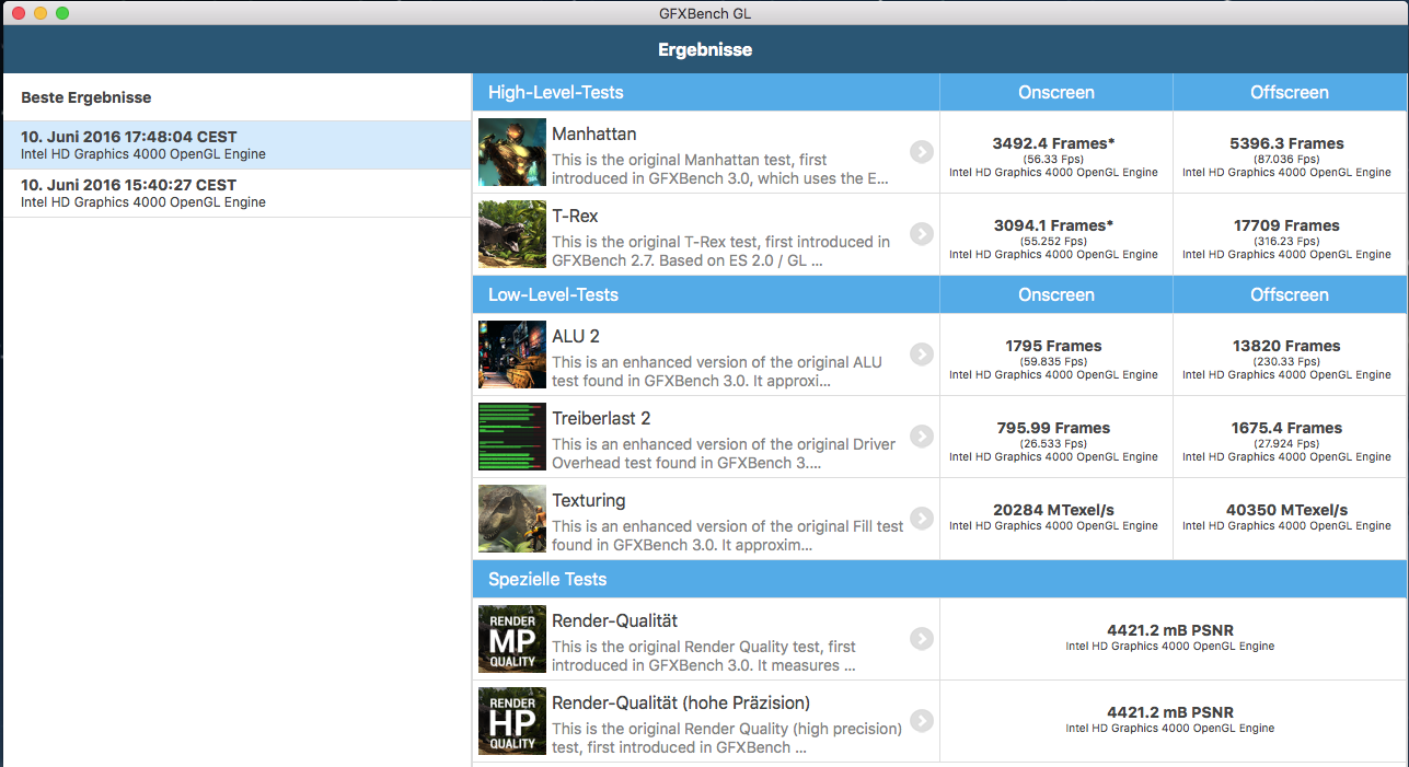

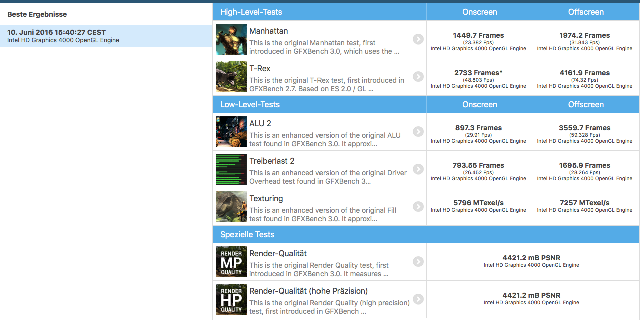

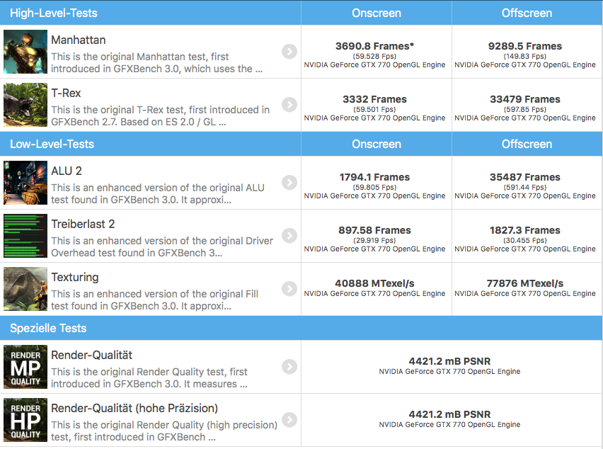

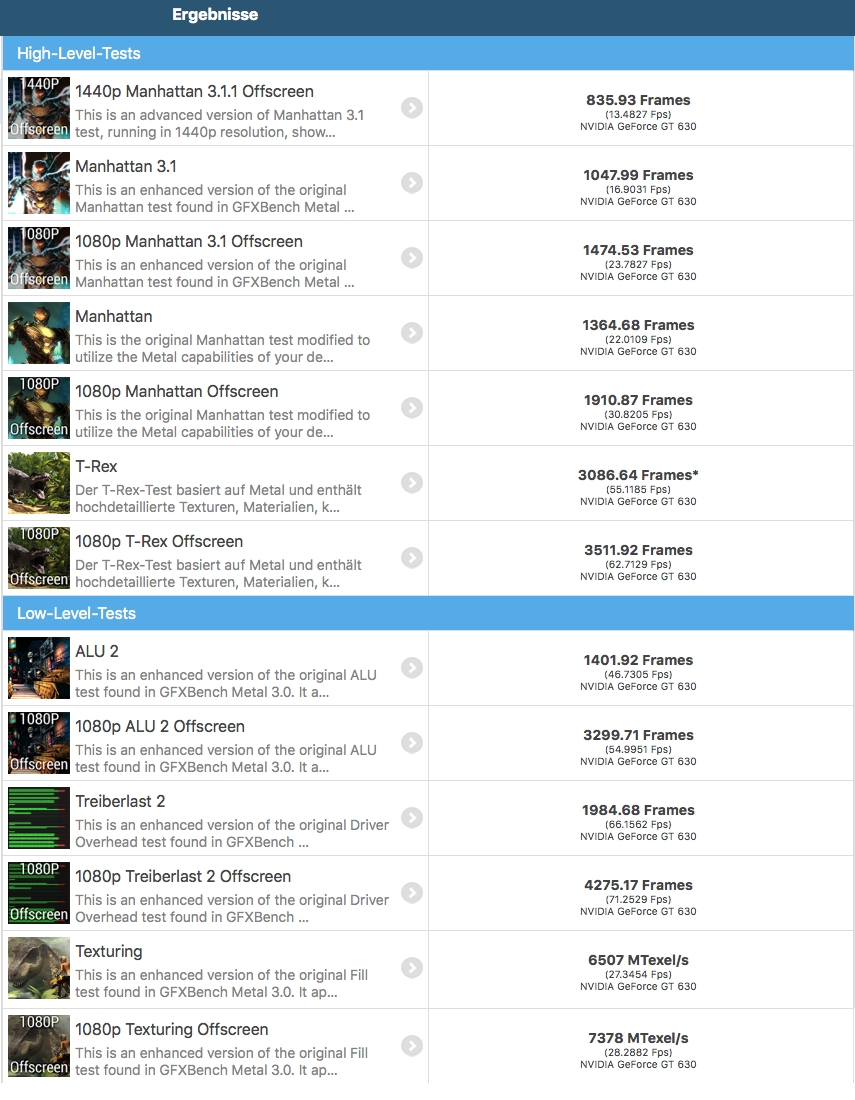

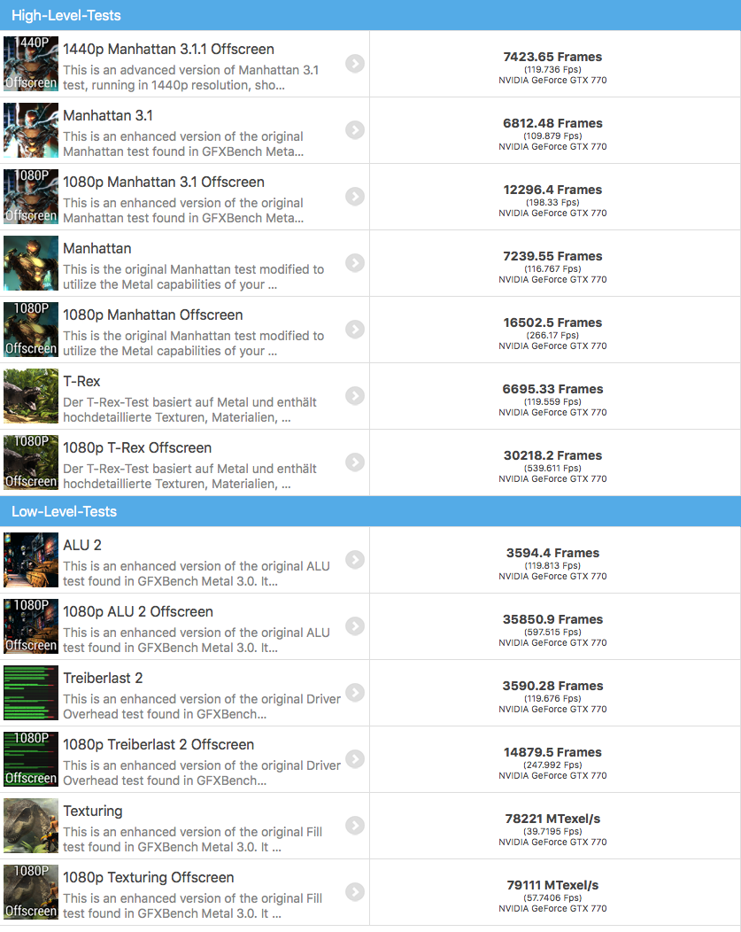

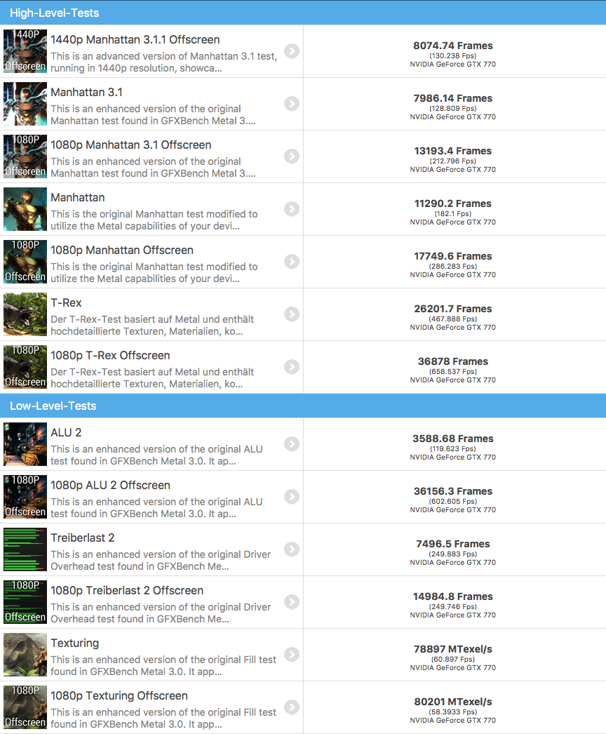

I could do the OpenGL Benchmark with GTX 770 in the Mac Pro, GTX 630 as eGPU, and GTX 750 Ti as eGPU connected to a Mac Mini 2012.
But the Metal Benchmark crashed with the only Maxwell GPU I have, the GTX 750 Ti. So no Metal benchmark for Maxwell...

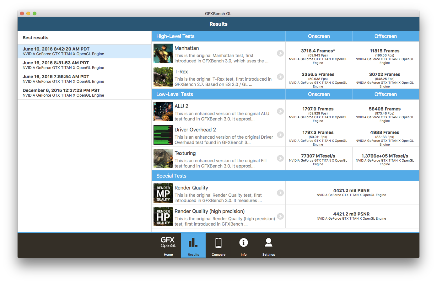

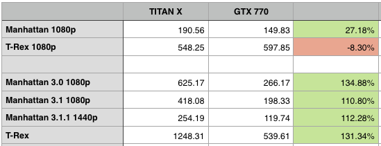

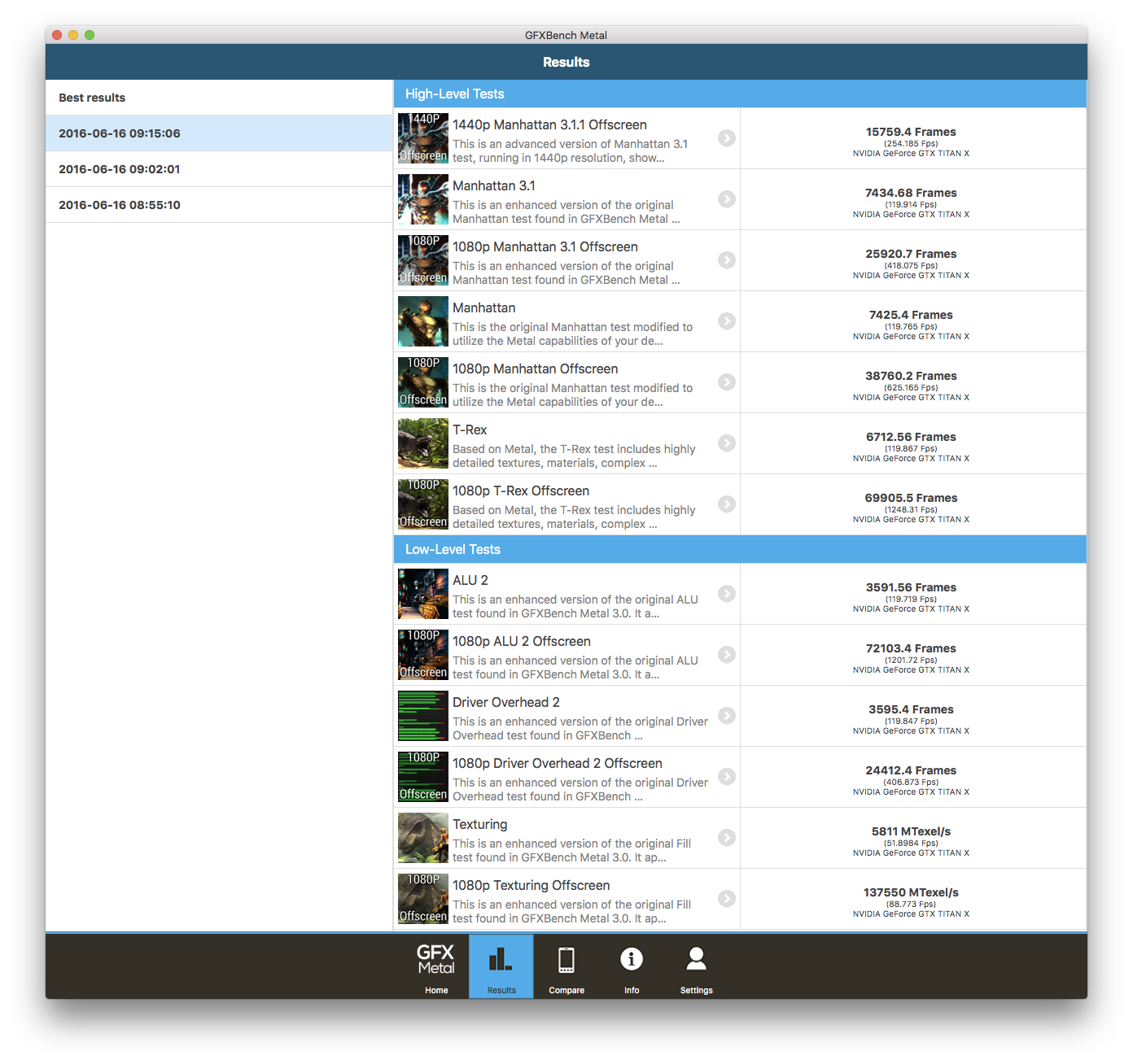

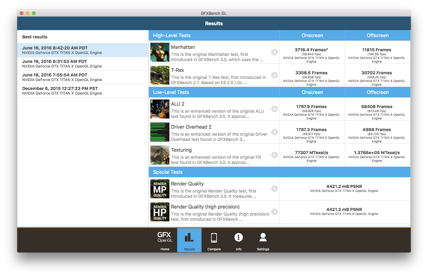

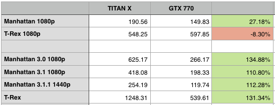

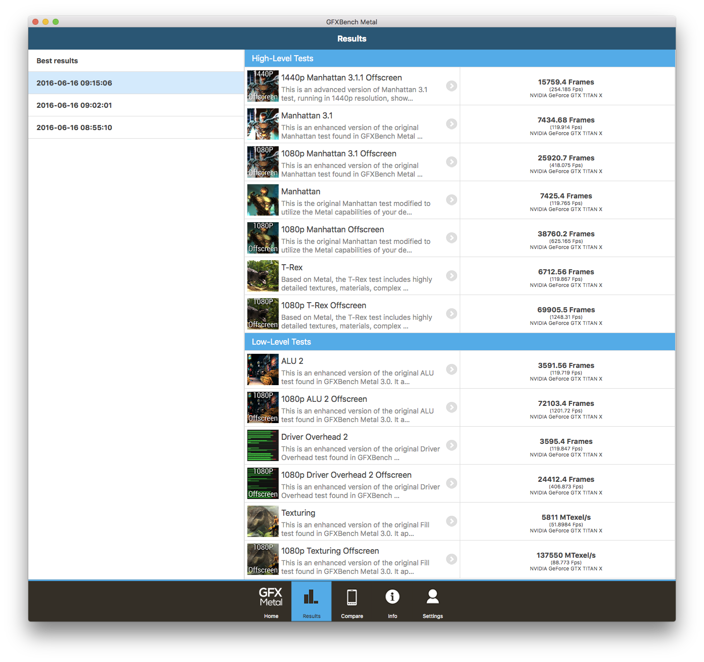

Here are my results for my Core i7-4790K with a TITAN X, using 10.11.5 with the 346.03.10f02 web driver. I've attached a comparison of the tests that are likely to be GPU limited with the GTX 770 posted earlier, for ease of reference. I don't know how you can look at results like these and conclude that the Maxwell cards are running in compatibility mode or are missing optimizations or whatever else people are claiming.

Poor in comparison to the 770. If you can't see how different that delta is compared to how well the Titan X is supposed to run in comparison to the 770 then...what am I saying...of course you can't see the issue here. I wasted one year trying to tell you. Haha....facepalm.

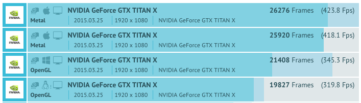

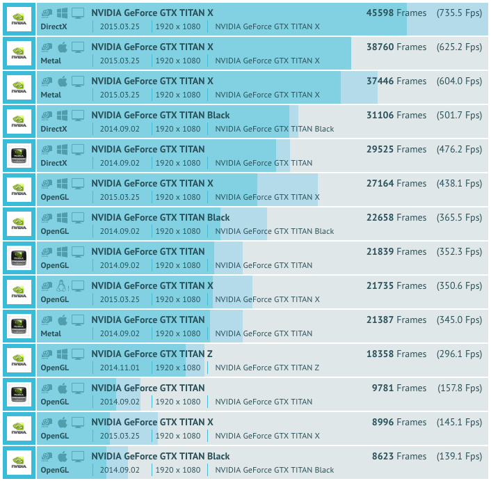

Okay, so just to be clear, you're complaining that Metal performance isn't as good as DirectX under Windows? I've spent a year trying to explain to you what it means to be CPU limited, and how the Apple OpenGL framework makes it impossible to match Windows OpenGL or DirectX performance, so I'm hoping we're past that.
Let's look at how the original 3.0 version of Manhattan performs. D3D gets 735.5 FPS, Metal gets 625.2 FPS, or about 15% slower. Is your whole argument that Metal should match D3D on a test that renders more than 10 frames every screen refresh? Given that NVIDIA has more people working on D3D performance than they have working on all aspects of the Mac drivers, it's not surprising that they've been able to squeeze out more performance here, and/or that their Mac team has been focusing their effort elsewhere.
Let's look at how the 3.1 version of Manhattan performs. Metal gets 423.8 FPS and beats Windows OpenGL with 345.3 (though the max score looks like it's much closer). What are you complaining about here, exactly?
So, what exactly would make you happy with respect to GFXBench results? Are you upset that GFXBench isn't matching what you expect based on the paper specs of the two GPUs? What makes you conclude that the Mac driver is running in compatibility mode, or doesn't have color compression enabled? I get that you think the NVIDIA web drivers are **** and that they should be doing a better job of supporting your usage cases, and you've raised some legitimate concerns about issues with Adobe apps (many/most of which have already been addressed).

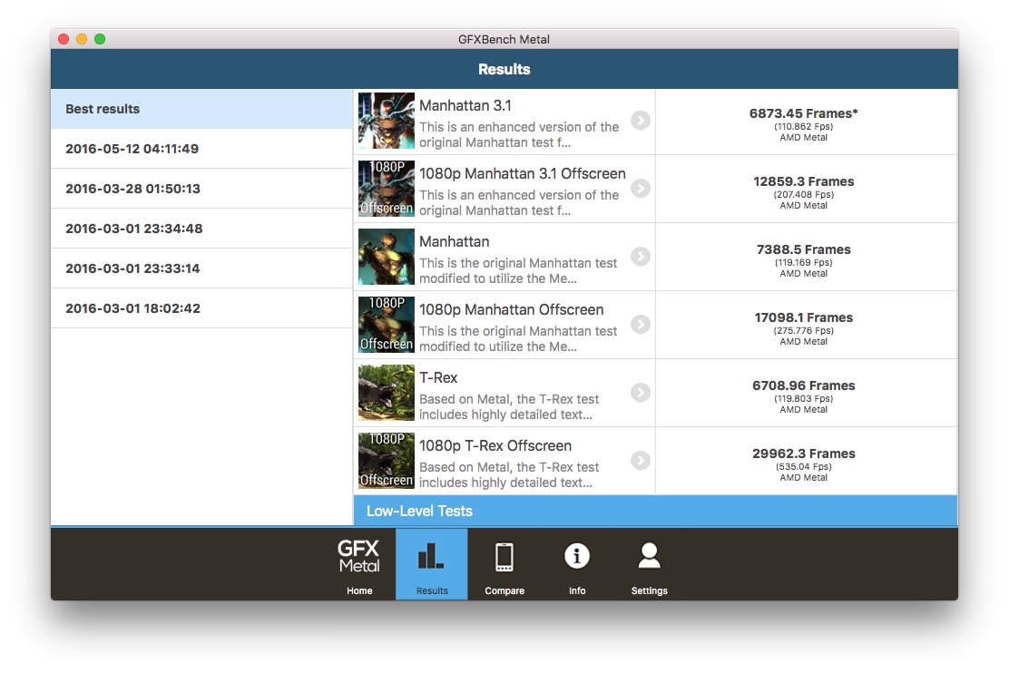

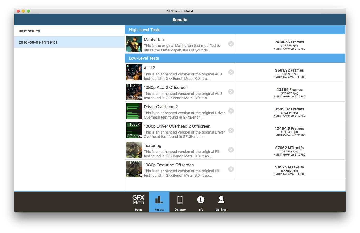

Enjoy your Polaris GPU, I'll enjoy using my 1080 Ti when it gets released. I was hoping to be able to include comparisons to the high-end AMD GPUs like the Fury X, but I wasn't able to find any data. So yeah, let's keep complaining about the NVIDIA web drivers because they're at least enabling all their GPUs to work.
