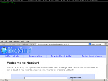

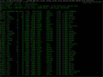

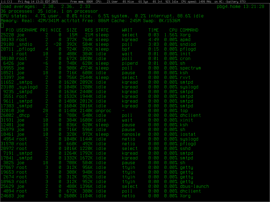

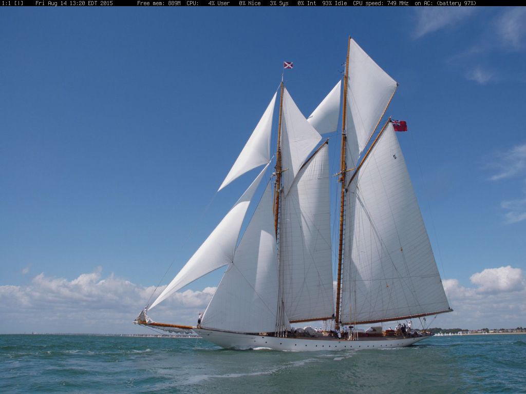

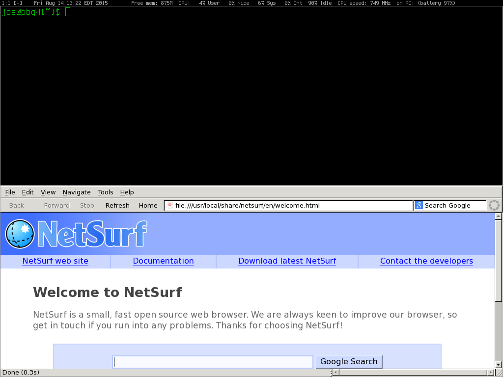

@556fmjoe Could you post what your desktop looks like under OpenBSD with the window manager you use?
This is the current configuration with spectrwm, showing a plain desktop, one rxvt terminal running top, and rxvt and Netsurf running concurrently on the same virtual desktop.
I should add that my original post is outdated. The official documentation should always take precedence over anything I post.

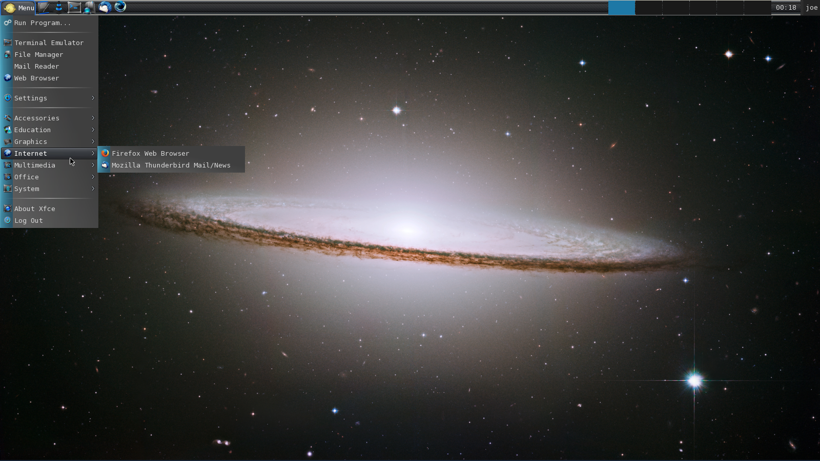

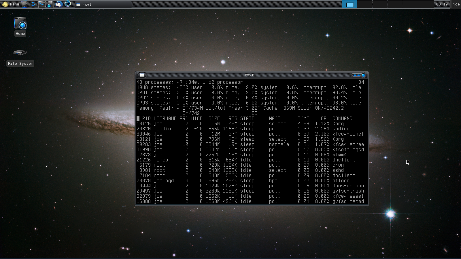

There are lots of them. The other two I use the most are cwm and XFCE. XFCE is probably the heaviest I would go on a G4, but it will run it fine. Cwm is in the base system so you don't need to install anything. It's very lightweight and simple. Like spectrwm, everything is controlled by key bindings, though unlike spectrwm you get a right click context menu that you can edit with whatever items you want. Tons of other WMs are available though.
Here are a couple screenshots of XFCE on my T420.
