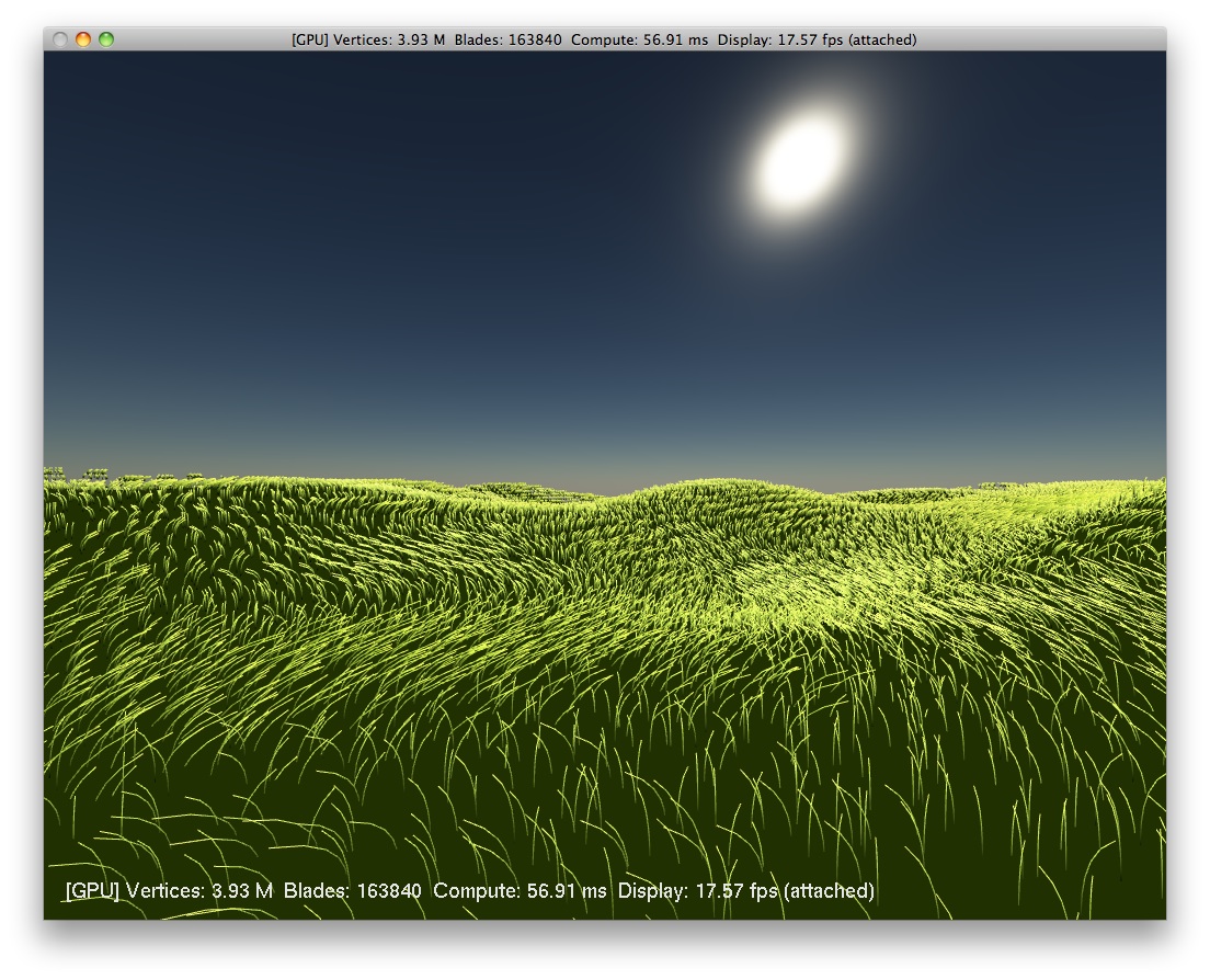

OpenCL_Procedural_Grass_and_Terrain_Example worked for me (NVIDIA GeForce 9400M).
That is worrisome for me. 🙁

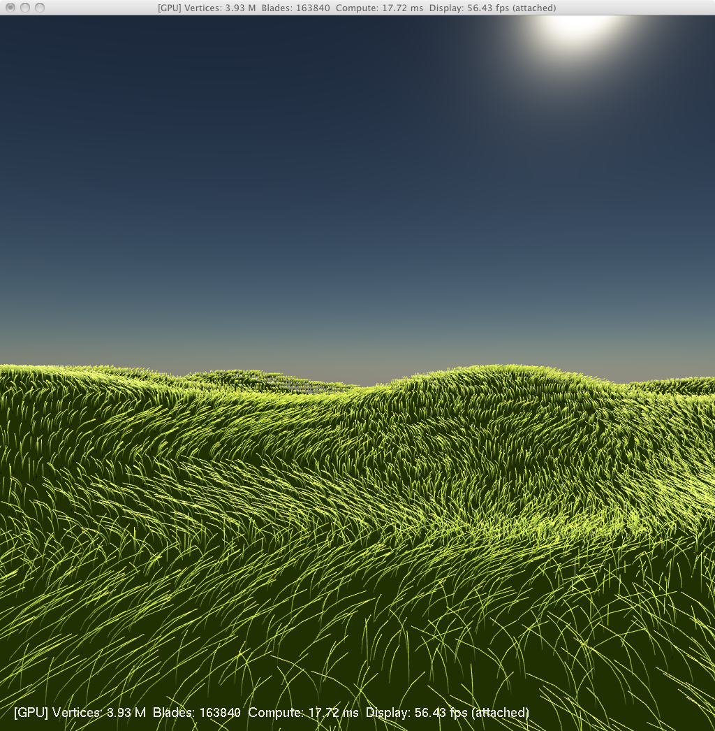

I don't have that graphics card but it does work on my Mac Pro with the Nvidia 8800GT. Maybe it is an ATI thing?
Also I had to switch the compiler from the default (GCC 4.2) to LLVM Clang to get it too work for me.
