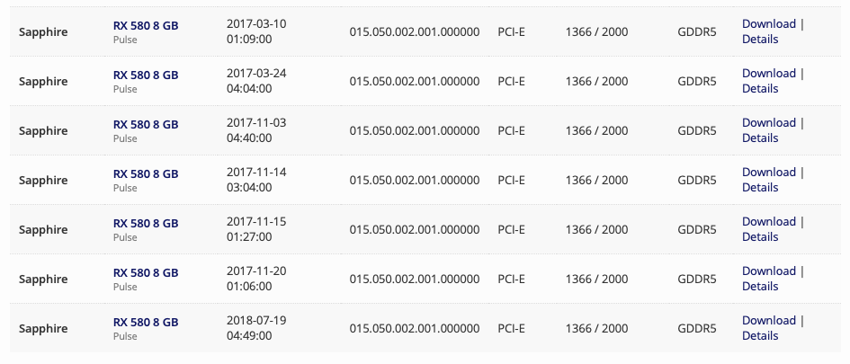

Understand, I am fairly sure it's the card's ROM issue. It doesn't matter if that's new card or not, if the ROM has issue, we can always try to flash that. The required ROM can be download from TechPowerUp anyway.

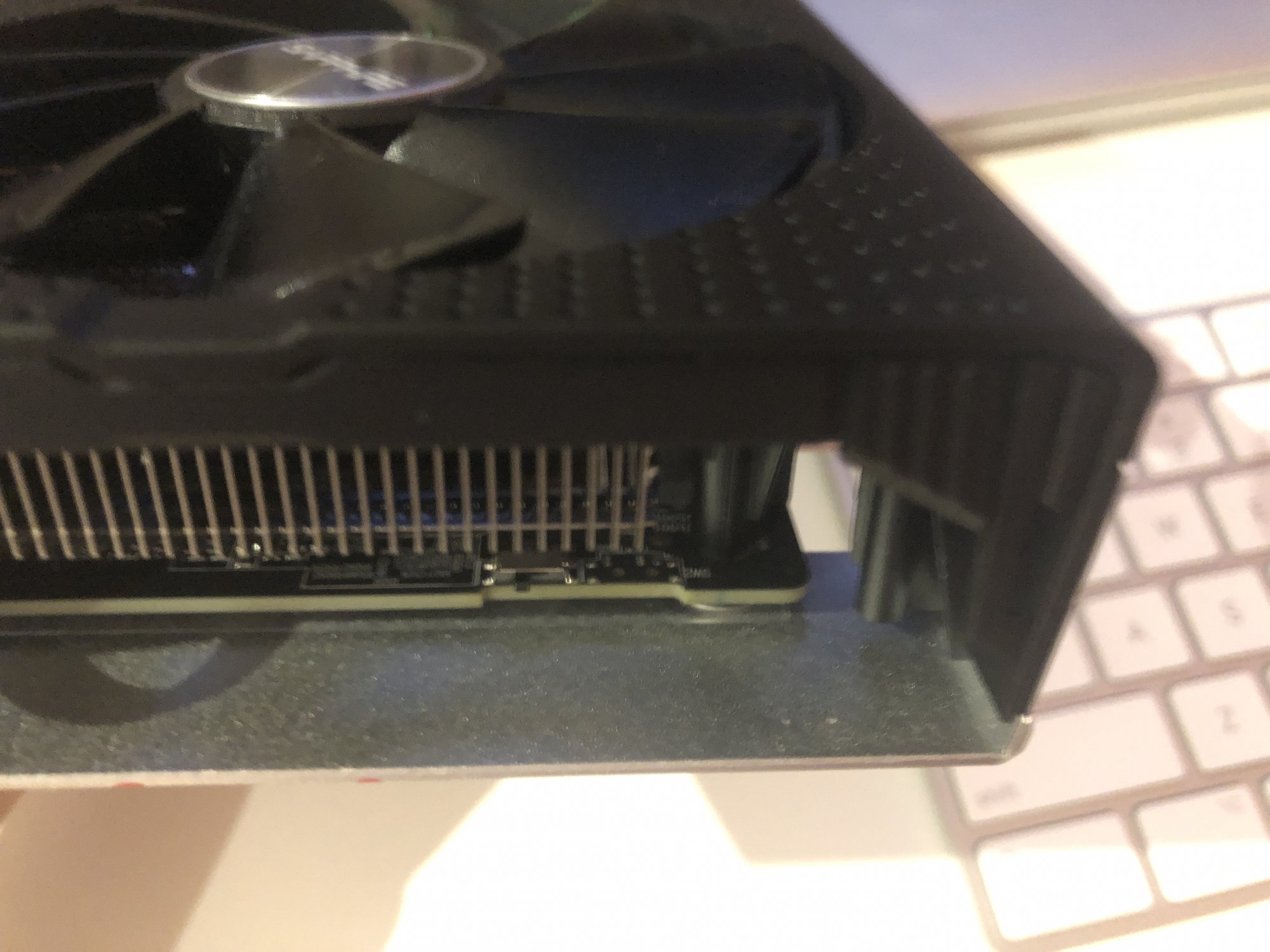

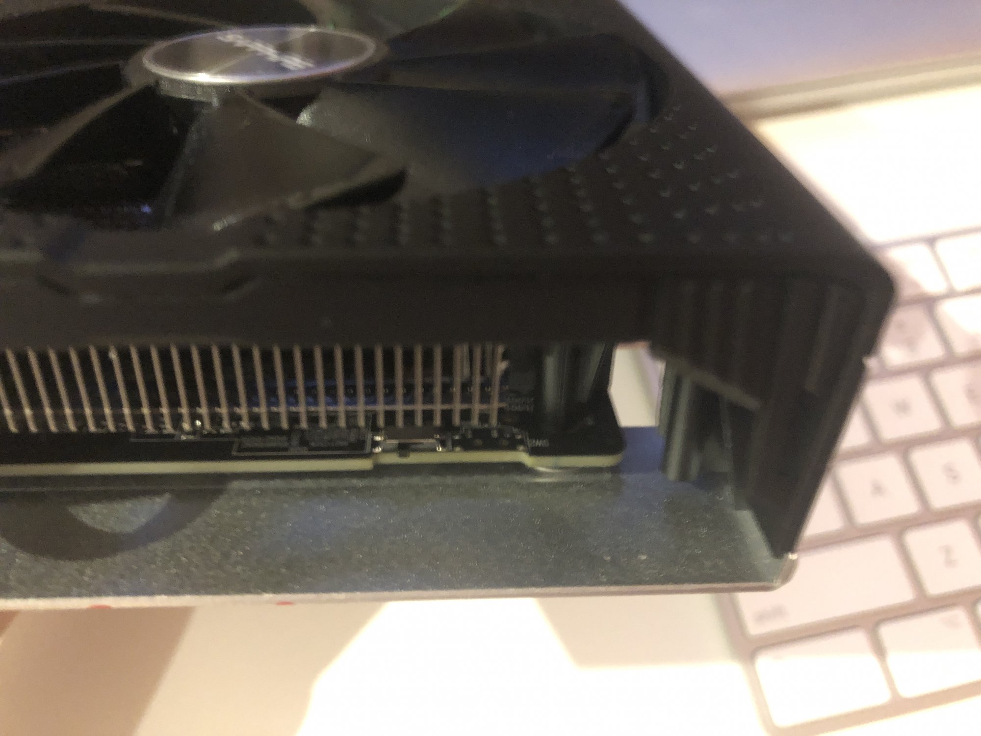

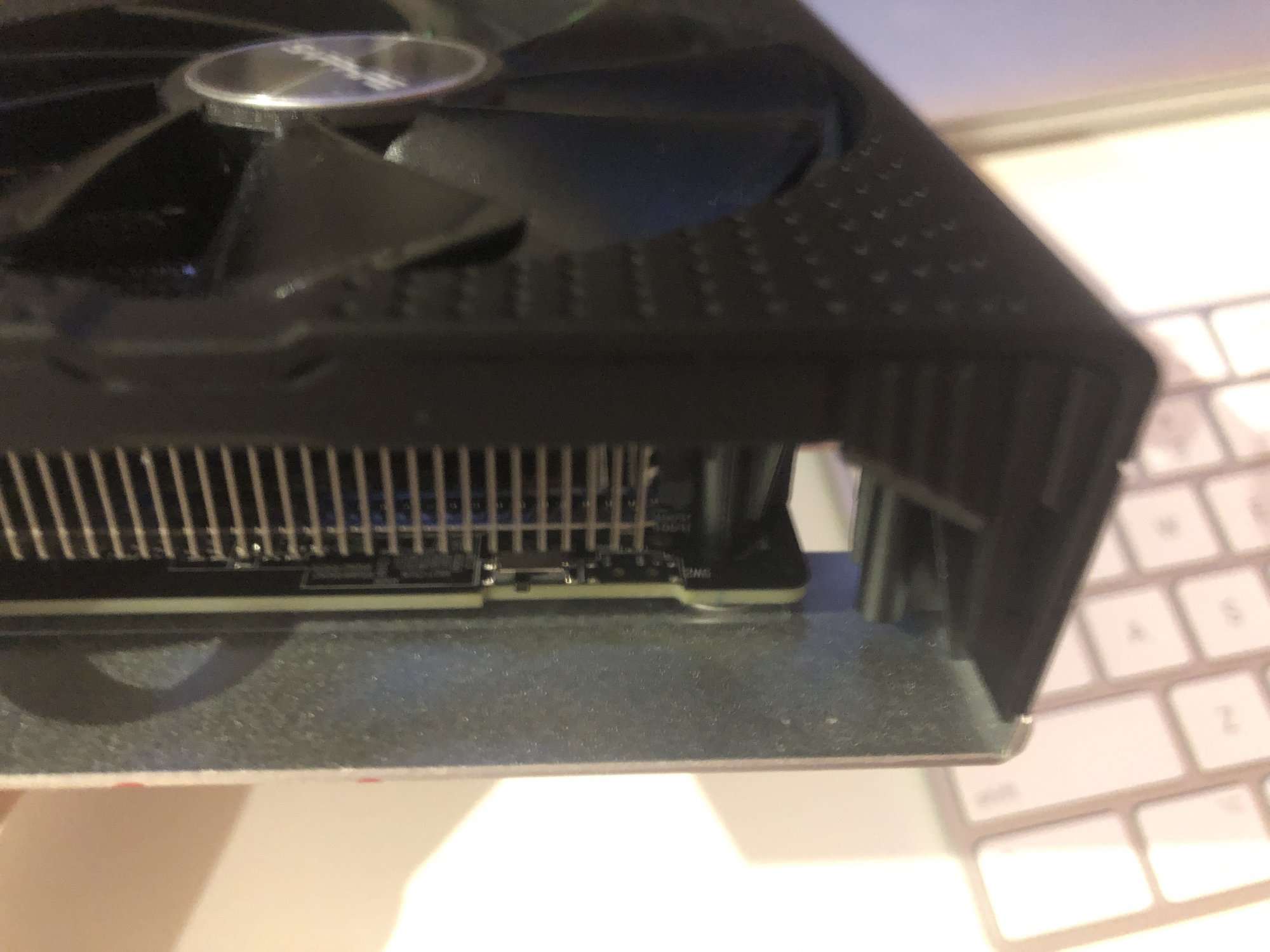

Is there any ROM switch on your card?
Yes, the switch is on the left side. I presume I can flash the rom on right side and switch it like you did? I don't know what is the correct rom version for my card, which will fix the bootpicker issue.

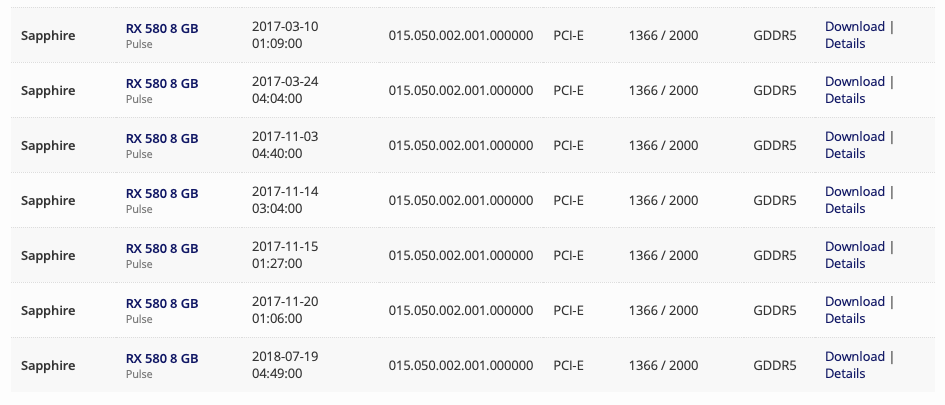

Any of those ROM should work, just download 2-3 of them and try one by one.
You don't need PC, just need Windows / DOS. I never flash RX580 in Linux, not sure if there is any reliable tool to do that.
As long as you leave the left side's ROM untouched, your card is safe.

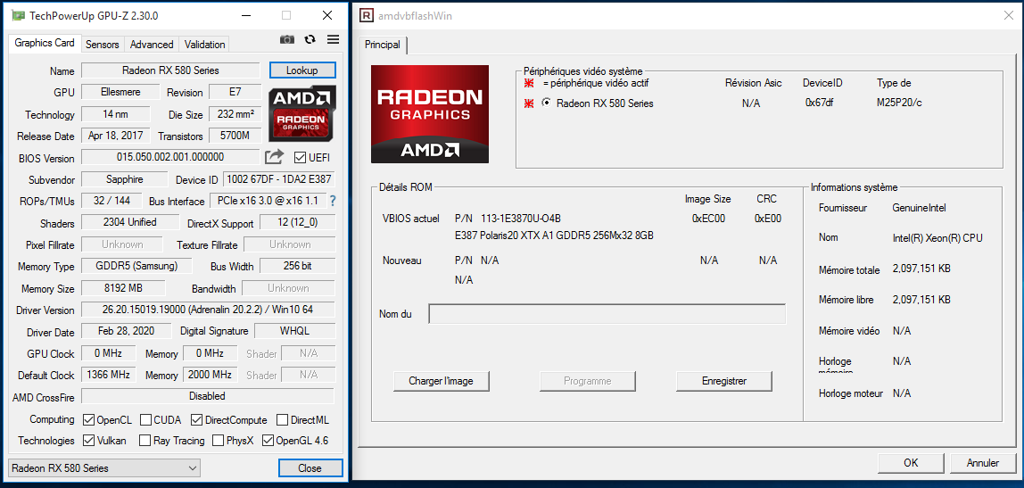

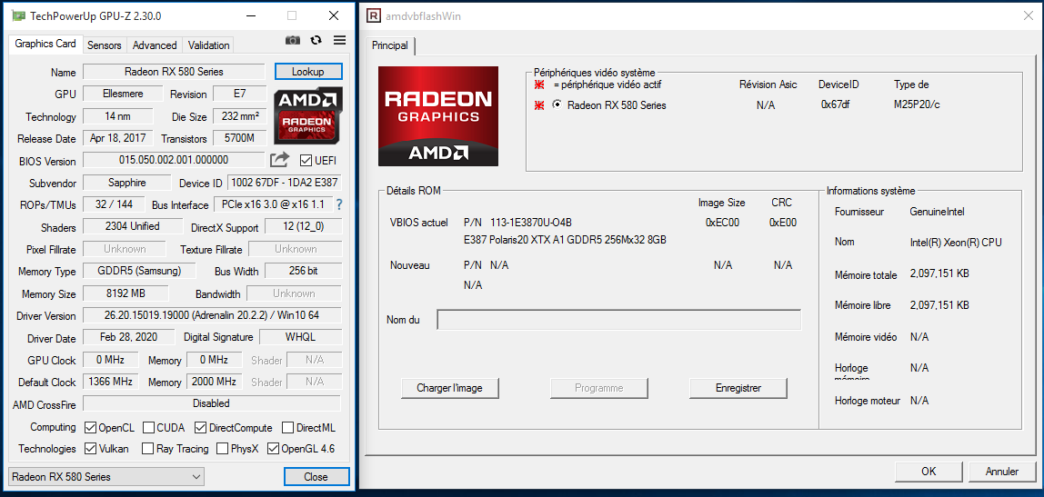

Hi
I try again to flash my RX580 and I solved it 🙂
But this time I used the same rom already installed by default but from techpowerup instead of another previous rom. (see screenshot)
and it works !

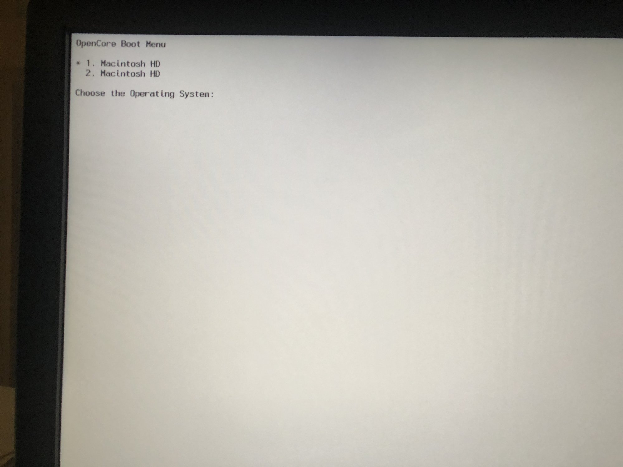

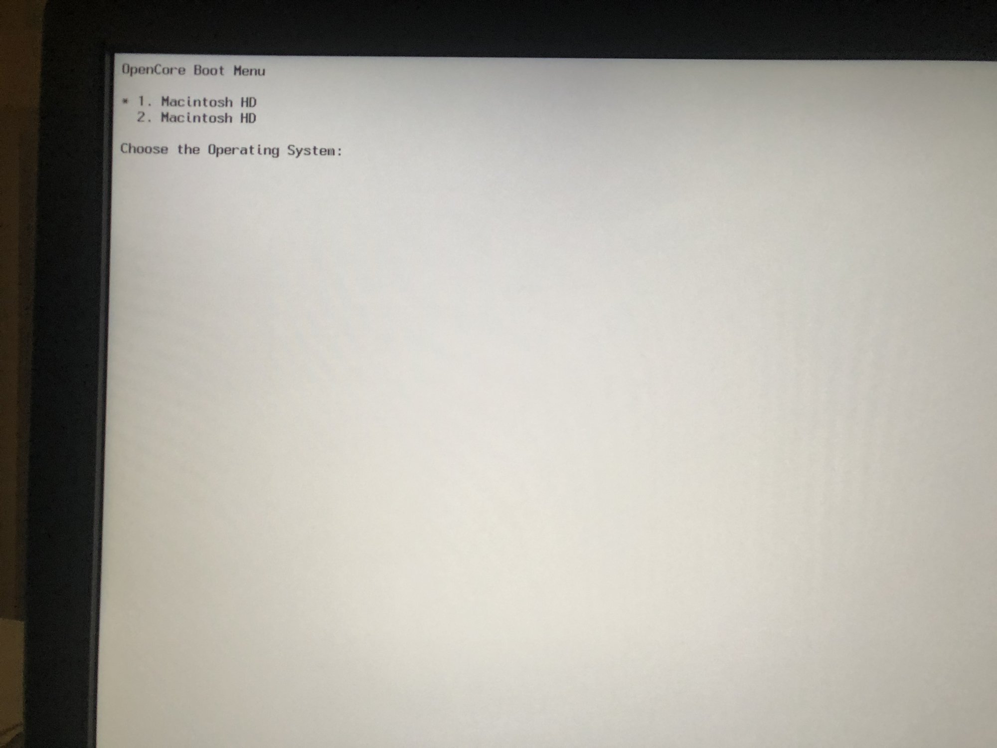

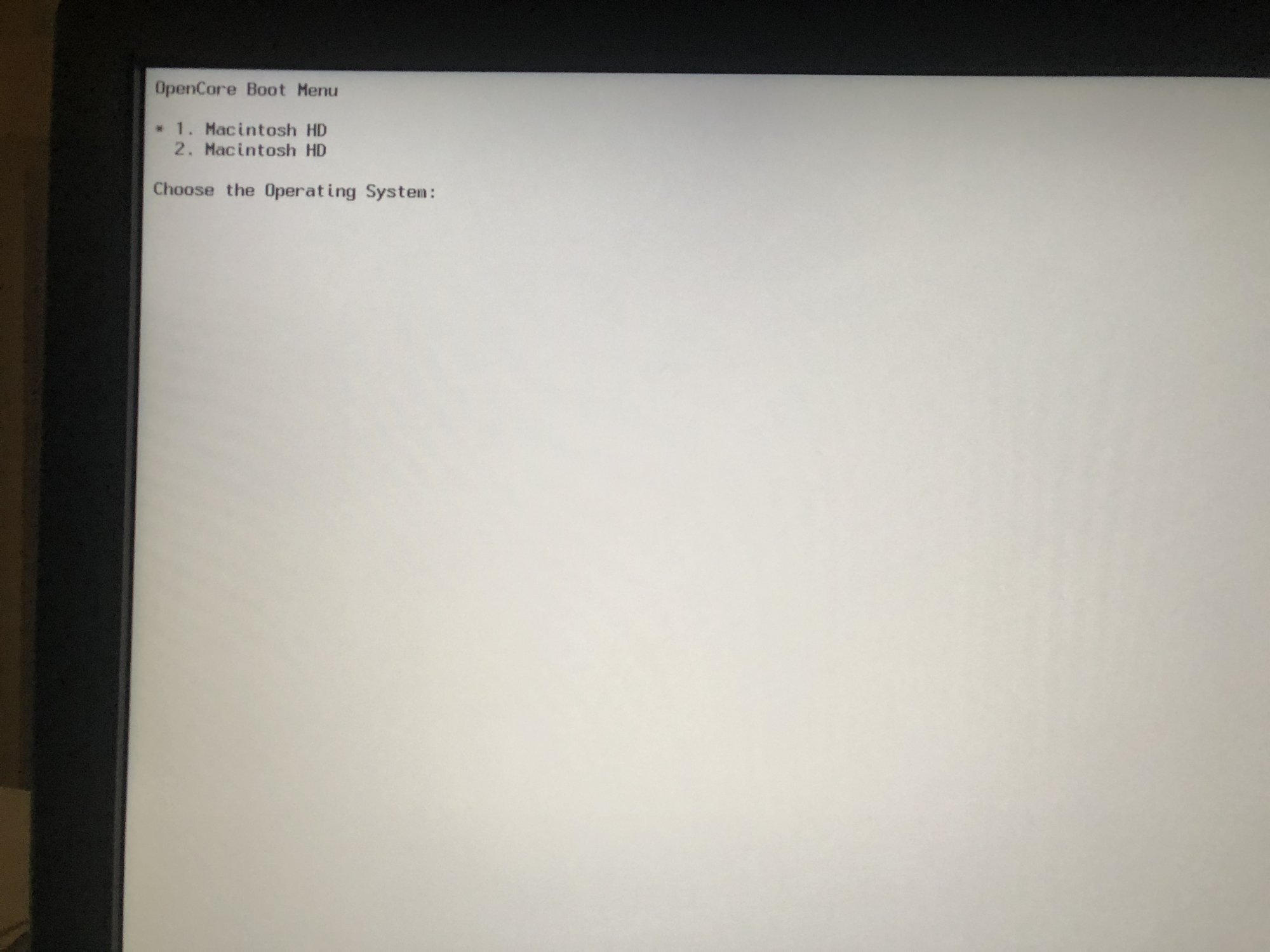

@lbuisson thanks for identifying the issue.
For me the fix was very easy, I had the ROM switch on Performance mode (right side) by default. As soon as I switched to Quiet mode (left side) and set the DirectGopRendering key to false, the bootpicker menu showed.
Is interesting my bootpicker is text based, while @lbuisson is graphic. I presume this is just a setting?
View attachment 907518View attachment 907517
Text base boot picker is normal. That GUI boot picker is a 3rd party plugin.

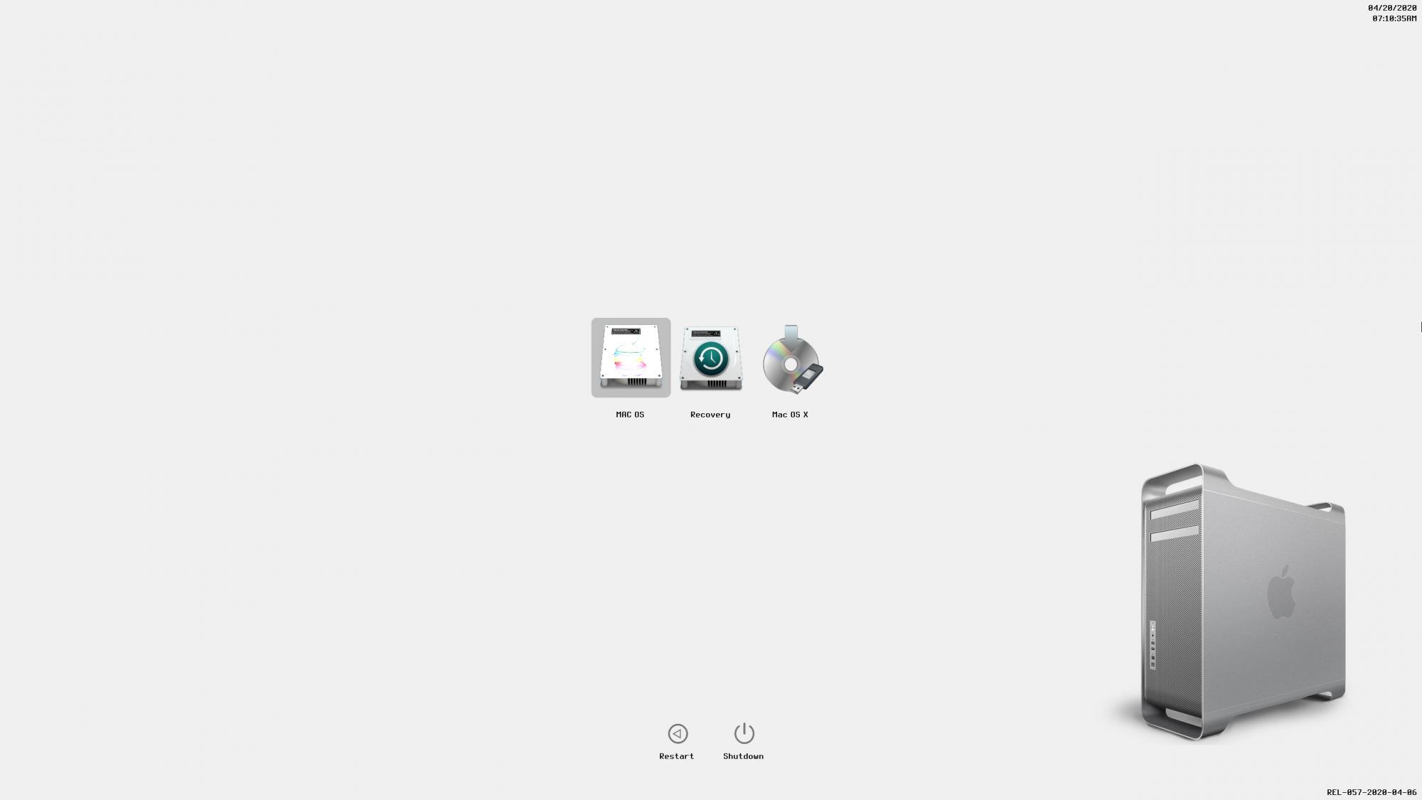

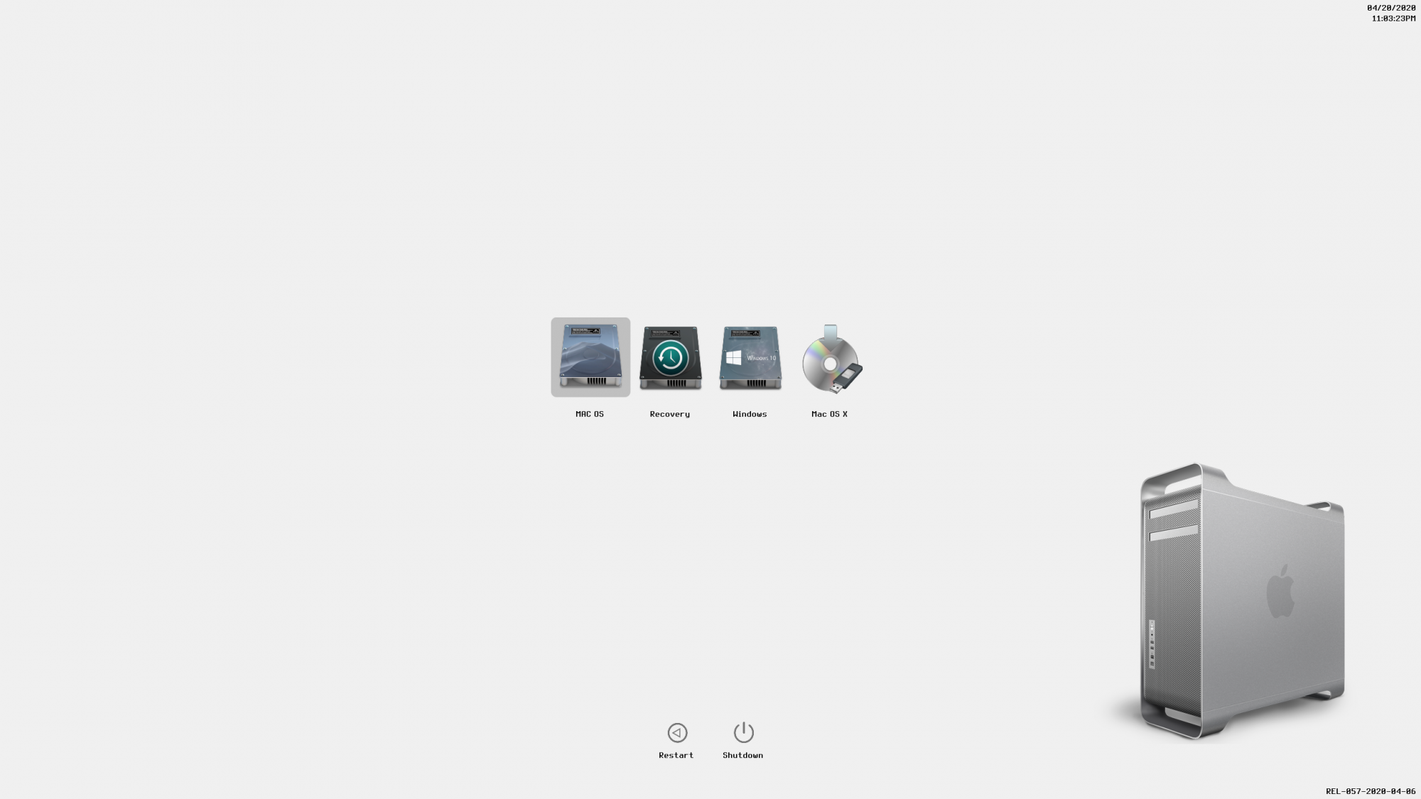

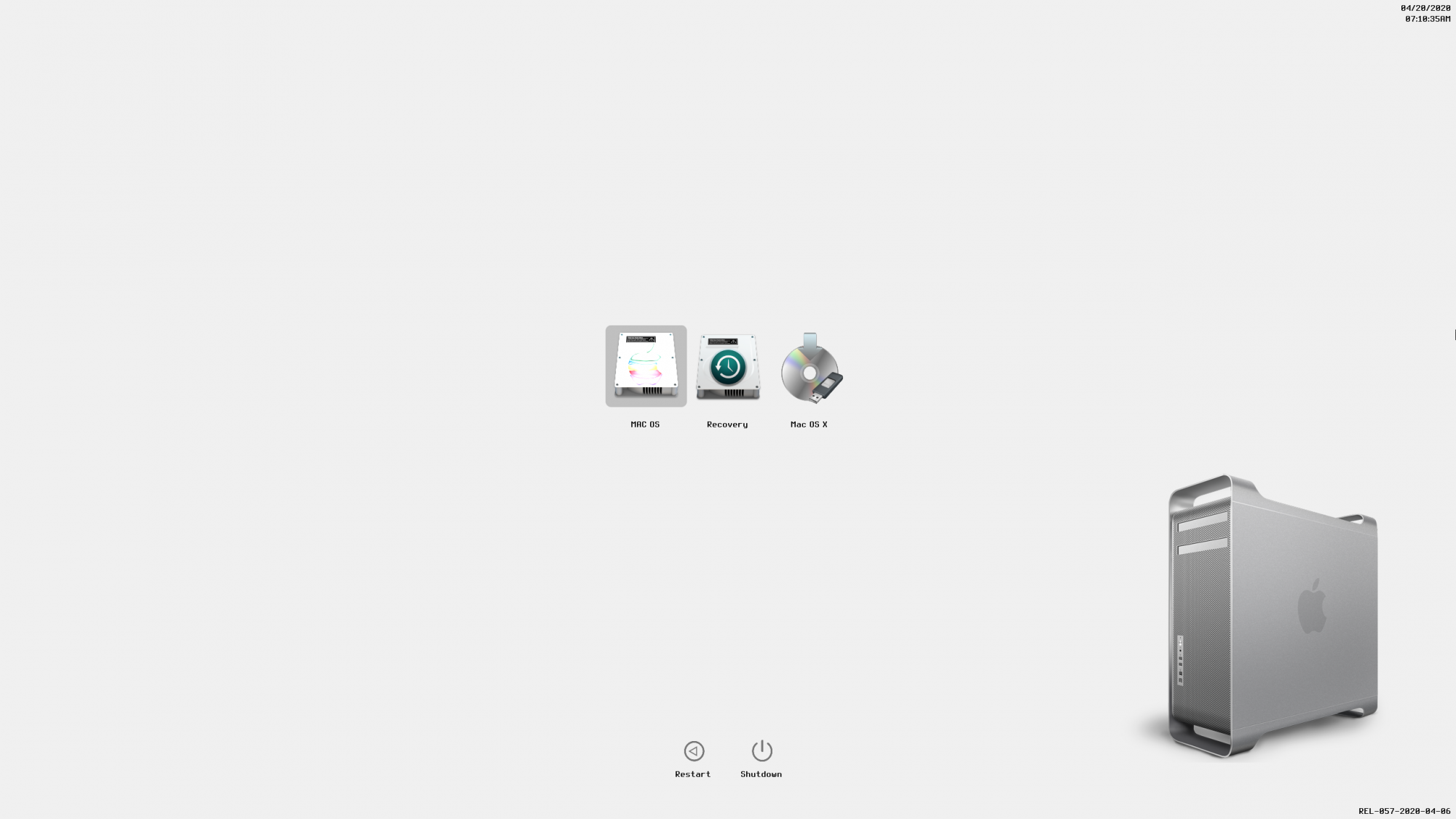

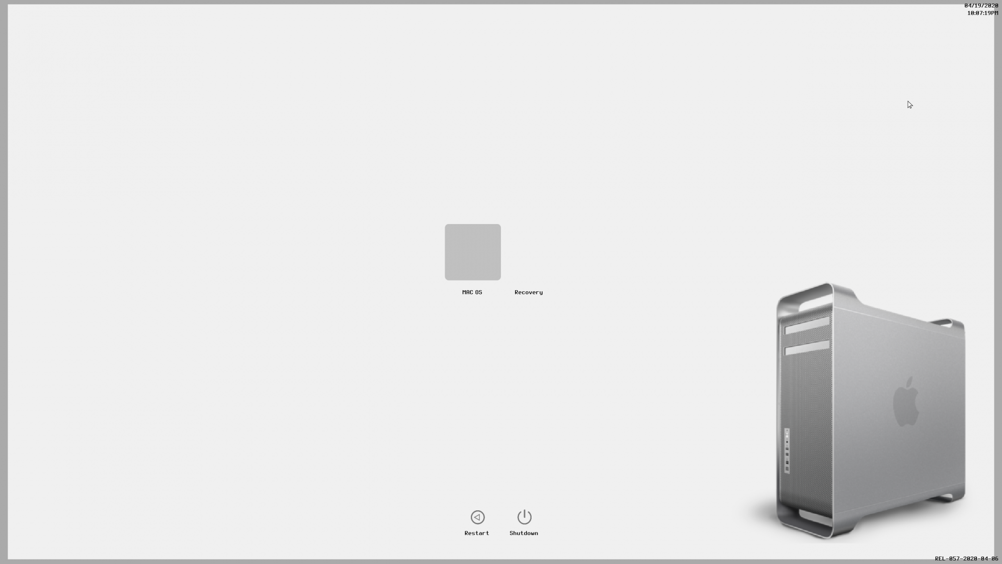

Hi
and it works !
But I still have issue :
- I have gray border around background Solved by replace backgroung.png with a QHD resolution instead 1080
- I can't see real icns I create (I attached on example) I test with one of yours @h9826790 it works how create them? I create real icns perhaps only png rename icns you done?
- I can't Windows 10 boot which existing still have this issue 🙁
Thank you for your help
Make 256x256 PNG files, then just rename them to icns. Do NOT convert them to icns.
For Windows issue, please read through the old posts. Has been discussed a few times already. OpenCore only support EFI systems, not legacy.

Yes for 256 it was already ok
And I saw that because make a test they are not real icns but only renamed png. 🙂
I made test with my create theme and I have issue with highlight selection, it is too more lightning.
Have you a solution or setting?
Another question :
do you know why bootpicker take os_mac.icns instead os_moja.icns in my case?
For Win10 I will search 😉
Thank you so much for your help 🙂

He seems to be either using a forked version of OpenCore or a bootpicker for the official version provided by the fork's developer
It is based on @h9826790
For those issue, you better contact the developer of NdkBootPicker.

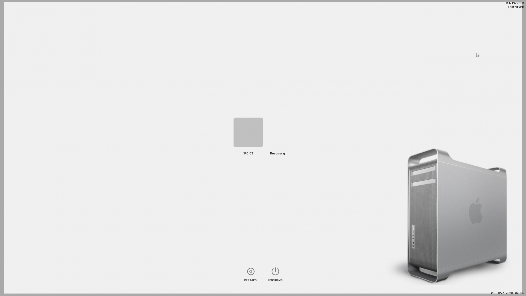

@lbuisson,
Do you mind sharing a copy of your bootscreen background file with the cMP Image in the corner?
Yes I will share it with my complete theme and different resolutions 🙂 in my case background is 2K
by default in NBK it is 1080 and 4K
[automerge]1587367979[/automerge]
