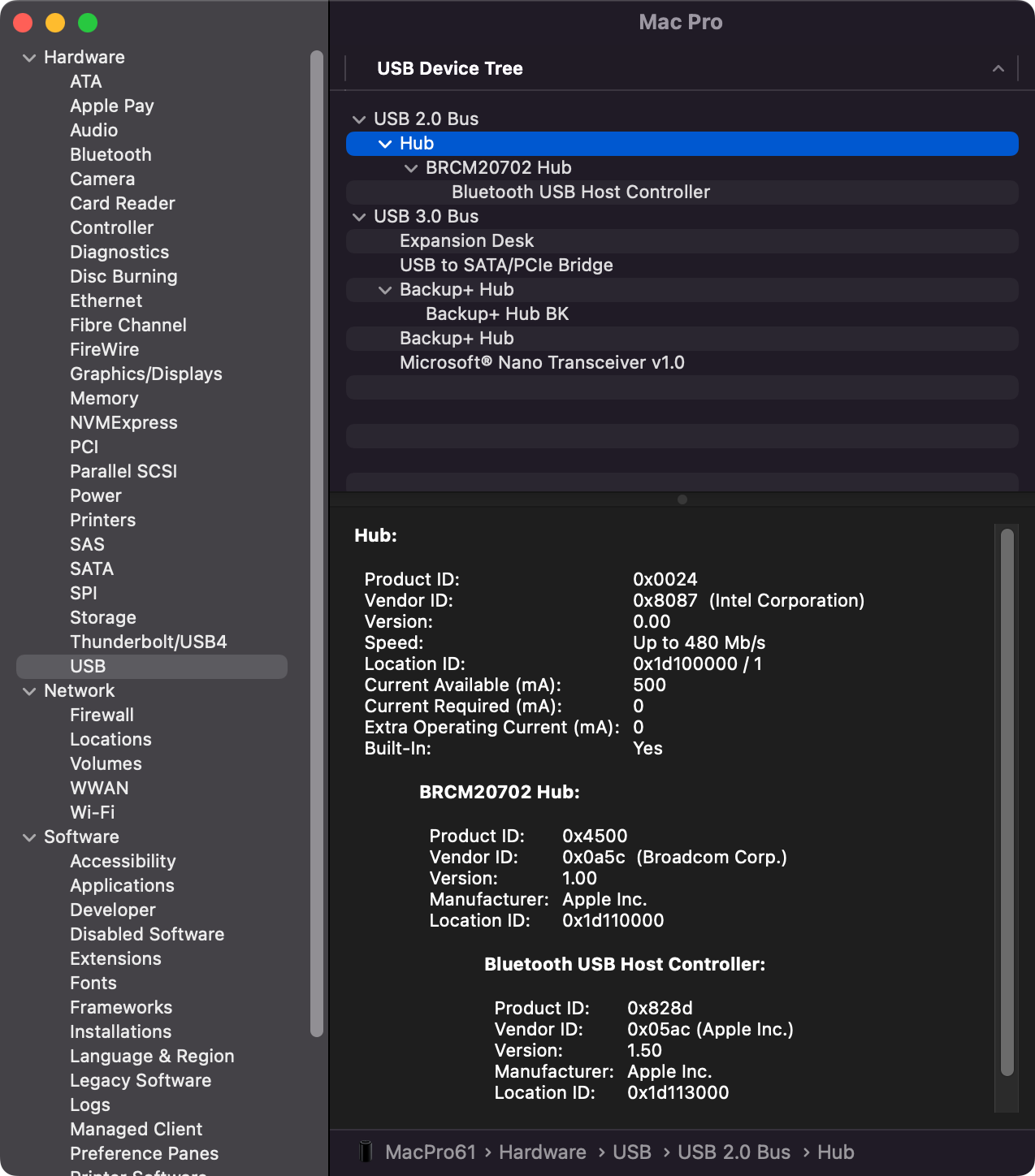

Thanks, so that wouldn't be a PCI card, but an external desktop hub? And would it be mainly for plugging in keyboard and mouse? Interestingly, my system report lists a USB 2 Hub internally - see attachment. You're the expert and I'm certainly not, but I'm just showing it as it may mean something!

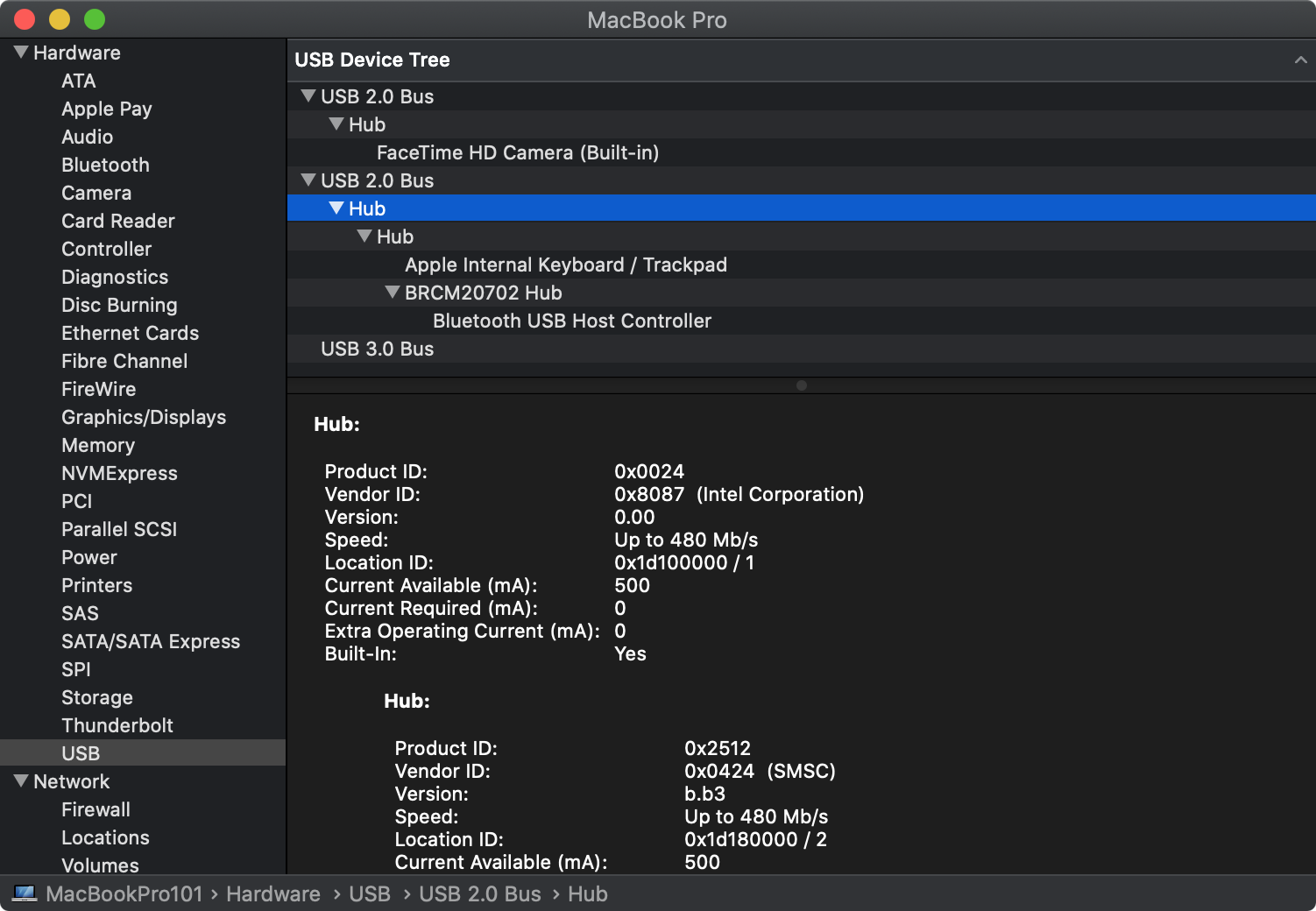

All Macs have it for the Bluetooth controller and other things, like the camera, keyboard and touchpad with notebooks.
MacPro6,1:
MacBookPro10,1:
Thanks again, so a mains-powered USB2/ USB 3 hub would be the thing. The reason why I was wondering about the USB 2 hub listed on my system report is that I just remembered that a few years after buying my Mac Pro in 2011, I purchased a second-hand twin-processor board for it which may have been from a more recent computer, hence it might have the required hub built in and not need upgrading.
