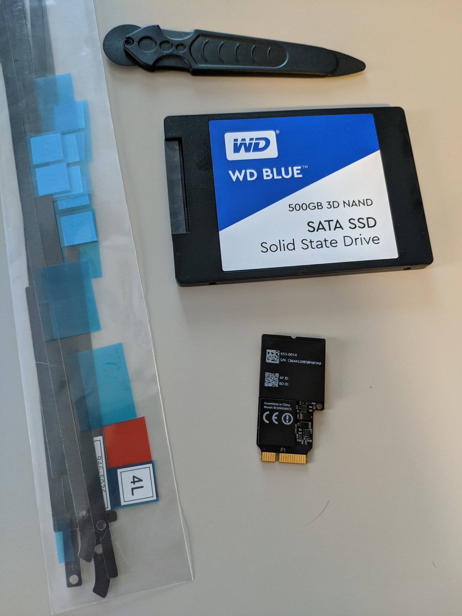

I'm about to open my late 21.5" imac (again) to upgrade the wi-fi card to make it Big Sur compatible. I will also upgrade to 16Gb RAM. I've already fitted an SSD.
What else should I consider? Should I be replacing thermal paste etc?
I want it to last another 3 years or so, so I'll consider anything that is reasonably cost effective.

Thanks for the responses. My imac is a late 2012,(13.1) 2,7GHz i5 with the NVIDIA GeForce GT 640M 512 MB graphics, 8Gb RAM and a Crucial MX500 SSD. It does not have the 802.11ac wifi so I'm trying to find suitable wifi card. On the Big Sur thread, those who have the Beta working with the 2013 iMac appear to have working wifi and this card (Broadcom BCM94360CD 802.11ac) seems to be ok. That's not to say there won't be other issues but it's a start!

Replacing the thermal paste has its challenges, for you have to tear apart the complete system to get to the CPU and GPU. I plan on doing this to upgrade to a i7 CPU from the i5, but looking on YouTube etc. basically you have to take the whole system apart to get to the CPU (and Gert to the memory).
Upgrading to 16 GB of RAM is also a nice option if you are going to go for thermal paste replacement anyway. Since you have teared apart the system to get to the CPU, the memory is an easy upgrade after. I bought the display tape as well and had the same idea that "Once Only" in opening the iMac and all of the upgrading etc., Cleaning out the air flow etc.
This will be the second opening so I am quite aware of all the inconvenience! With the proper tools and a degree of patience it is quite straightforward. Having a video on 'freeze frame' on another screen during the process helps enormously. It's really the other way round in terms of priorities. I intend to upgrade the RAM, so I may as well do the thermal paste at the same time as everything will be accessible.
One of the great benefits is cleaning out the ventilation path. I did a 2011MBP for a friend a couple of weeks ago (RAM/SSD). The fan wasn't bad but when I lifted it out, you would not believe the fluff and lint which was obstructing the heatsink matrix outlet. No wonder the fan was running most of the time. It's virtually silent now!

It's all back together again and running well. The big surprise was when I removed the fan. I had the screen off about 18 months ago when I did the SSD and I also cleaned the fan. This time I opened the fan unit itself and could not believe how dirty it was inside. The face of the fan that you see when you open the back is only about 1/3rd of the fan depth. When you open the unit there is another double depth set of blades there as well, out of sight from the front. Mine had 8 years of gunge and crusty grime caked to the blades!
Running quietly now and only 1400rpm on the fan control!!
