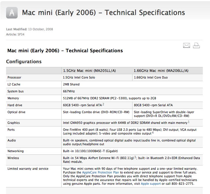

No such thing as a Core Solo......
Its a Core Duo.
And they are a piece of cake to open unless you have two left thumbs.....
Core solo...?
Its a Core Duo.

The first Mac Minis were actually Core Solo 1.5GHz before the Core Duo Mini came out, and then the Core 2 Duo Minis came out with the 1.83GHz models. Before the first Core Solo minis were the G4 Minis.
Here is one of the Core Solo Minis on Amazon:
http://www.amazon.com/Apple-MA205LL-Intel-Drive-DVD-ROM/dp/B000EPWDTC
1.5 GHz Intel Core Solo processor with 167 MHz system bus
512 MB DDR2 SDRAM (expandable to 2 GB), 60 GB hard drive, and slot-loading Combo Drive (DVD-ROM/CD-RW)
One FireWire 400 port; four USB 2.0 ports
