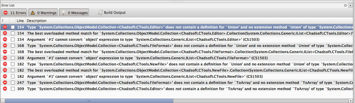

I tried to run the SZS Explorer via Mono and got errors. A screenshot is attached.
