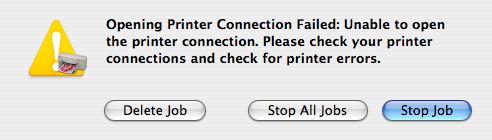

C'mon, somebody must know something about this. 😕
Actually, I know there's plenty of you out there who do, it's just that no one browses the Peripherals Forum very much. 🙁
New, old printer? Did it used to work? Do you have a spare USB cable to try? Printer and Mac restarted to clear any weirdness?
Did you get a fix for this problem? It seems that one of the recent OS X updates broke my printer software. When I try to print anything from OS X now, the Print Manager returns the same error:
"Opening Printer Connection Failed: Unable to open the printer connection. Please check your printer connection and check for printer errors."
What doesn't make sense is that the Mac can see the printer, but HP's software says that the device is busy. What's frustrating is that the software doesn't give the dump of the error, so I can't determine if the HP software has been corrupted or if there's something wrong with OS X. Of course, HP doesn't have any updated drivers for my old printer, so I maybe I'm supposed to buy a new printer.

I have the same problem.
Had worked wired and remote.
I have uninstalled everything and reinstalled with no luck.
What is odd is mac sees the printer and i have no problem printing anything else non PDF.
Went home and tried it on my HP printer, no luck as well.
I have windows vista using boot camp on a mac book pro, no problems.
Any help would be great.
Thanks
I took a pdf file that was on a usb drive and it printed from there fine on the mac, still no clue

"opening printer connection failed"
This is really a question-I just read all the threads & have tried all the suggestions except for a new USB cable but the printer had been working fine until I "Safe Booted" my computer this morning when it froze up. When I tried to print something my printer had disappeared, so I finally got it back on but nothing will print now. What am I doing wrong? I tried all the steps that HP said to try & none of them helped. Help!!
My suggestion is to buy a new printer that isn't from HP or anybody else that doesn't make good drivers. I'd guess that "Safe Booting" (whatever that means - sounds like a Microsoft feature) disabled or deleted the printer drivers or its configuration preferences that OS X uses. You could try uninstalling and reinstalling the printer software from its CD-ROM, which also sounds like a Microsoft Windows fix-it suggestion.
SafeBooting activates a series of measures designed to return the computer to good health. I tried the uninstalling and reinstalling-no go. I bought a new USB cord and plugged that in, didn't help anything. I guess my next move is to call Apple and get them to figure it out for me since I have an extended warranty.
Apple Support's likely response will be to tell you that non-Apple products aren't supported under the warranty and to call HP if you want help. That's what happened to me when I had a conflict between OS X and non-Apple hardware. It's like dealing with Microsoft after you buy an OEM computer with Windows preinstalled.
