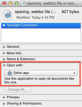

Get Info on the .webloc file, then just change the "Open with" dropdown to which app you want.

That definitely does not work. .webloc files do not behave the same way as standard Finder files. They will always open with the default browser. In my case, Firefox is the default browser, even though the "get info" screen shows "Safari" as the open-with app.
