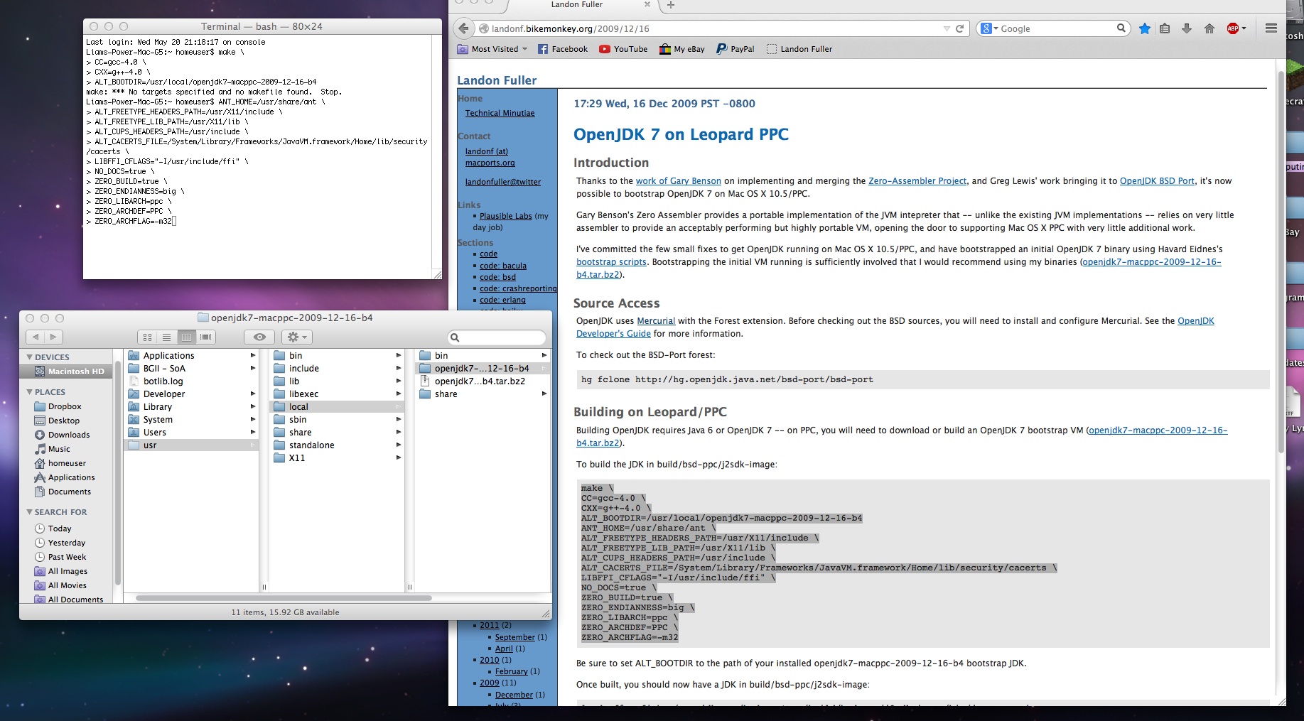

I am trying to build an image using OpenJDK7 and the method detailed by Landon Fuller here: http://landonf.bikemonkey.org/2009/12/16
The problem is when I try to do this step (ALT_BOOTDIR=/usr/local/openjdk7-macppc-2009-12-16-b4), it tells me that the file or directory does not exist, when it clearly does. I have tried using different directories to no avail.
Anybody an expert with a troublesome Terminal here?
You can clearly see my situation below:

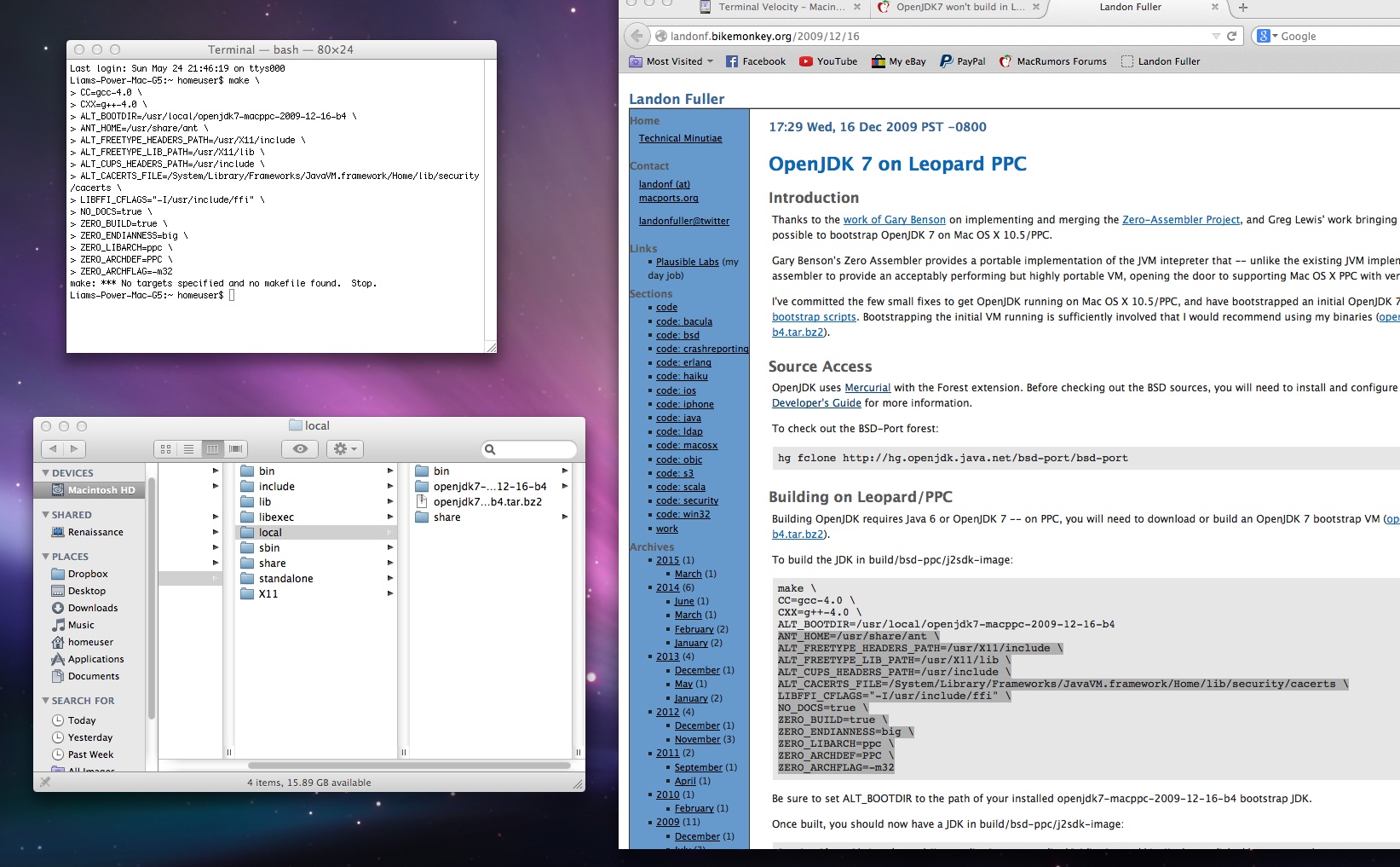

Oh gosh I knew it must be something stupid! Thanks, I'll give that a go 🙂

Well I'm afraid that didn't fix the issue. It seems to work accordingly but can't seem to see the folder I'm pointing it too. But as you can see, it is in the location I'm specifying. :/
From what I can tell from your picture, it seems your terminal is located at a different directory, the directory homeuser, then your jdk source folder.
The error message you receive from make, says that it cannot find a make file/targets, which I assume is because the current directory doesn't contain a make file.
I would assume that if you navigate to the jdk source folder in your terminal, and try the make command again it would try to compile the jdk.
The folder /usr/local/openjdk7-macppc-2009-12-16-b4 isn't your problem. You have to cd into your source folder where the Makefile resides before calling make.
