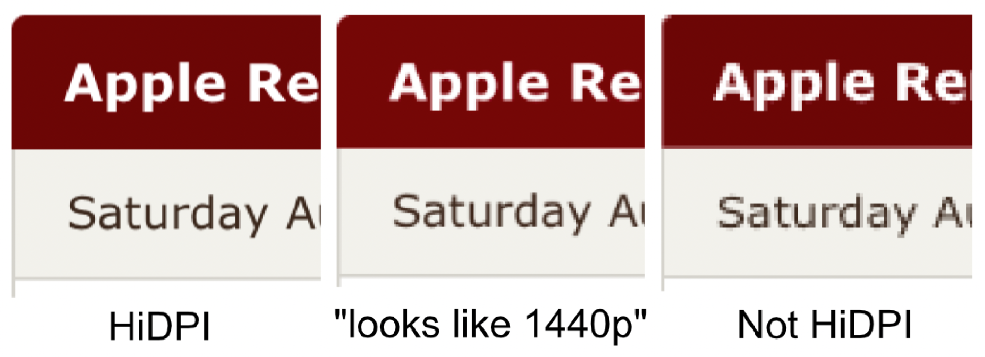

for points of comparison, this is what "looks like 2560x1440" on a 4K display looks like:
This is what it will looks like on either a 5K monitor or when you run your 4K monitor with "looks like 1920x1080":
For me, it's not just the fonts being blurry, the distortion on the line edges is unacceptable as well. It's like looking at the UX through a Zoom screencast. It's not how the OS designers, the app designers, or the web designers expected things to look like and appreciation of those details is big part of the reason why people use Macs.
Where are you getting those images from?
I run my 4K display at "looks like 1440p." I just took a bunch of macro photographs of text being displayed on my monitor and none of it has any of the distortion/aliasing that's in your "scaled" image.
Your "scaled" image has the same sort of aliasing you would get if you ran it through a sharpening filter. I think somebody has tricked you.
yes, I edited the post with a bilinear scale from photoshop and indicated as such. The edges are still going to be blurred although not with the same edge artifact. There’s no getting around that the Mac OS is pushing every pixel of the entire 5K frame buffer through a rescale function with “looks like 1440p”. Fonts, lines, everything gets resampled. IMHO, a 27" 4K display should be run at "looks like 1080" and just live with the larger UX, at least you won't get this second layer of scaling distortion added.
I don't know what went wrong with Photoshop but it's clearly doing some sharpening in addition to scaling. I just took a similar screen shot on my computer and scaled it down to 75% in Affinity Photo (also using bilinear sampling) and it looks fine. It's obviously lower resolution but it doesn't have any of the sharpening artifacts that were in your image.
Edit: It occurs to me that the distortion in your image also looks a bit like JPEG compression artifacts. Is it possible that you resized the image and then saved it as a JPEG?

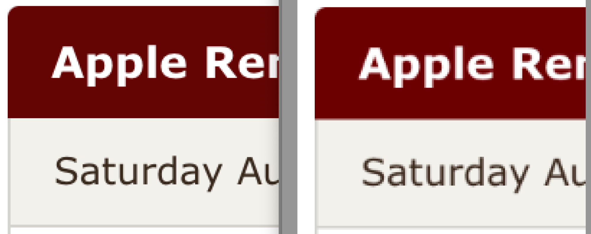

Just a quick comparison of 5K vs. 4K set to "looks like 1440p" vs. what you'd see on an actual 1440p display.
4K with scaling is obviously not as good as 5K but it's not awful.

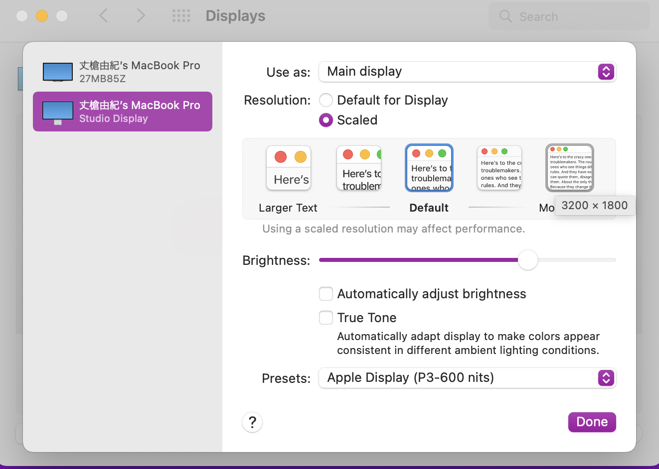

No, this is not correct. When you choose a scaled resolution, the message "Using a scaled resolution may affect performance" will appear.
For instance, if you use 2K scaling on 5K, your GPU will use a virtual screen to render that in 5K and downscale it to 4K to create a image on the screen that can fit. Since this is not a native scaling, it impacts performance. Of course, it won't be as noticeable on M1 Pro or higher SoCs since it has more GPU cores.If you want to prove your point, run benchmarks in Blender in 2x scaling and 2K scaling on a 4K monitor and see if there is a big difference.
Regardless, 27" 4K will always be inferior to 5K. Some won't tell the difference, but I certainly can and 1080P 2x scaling to me is just a big waste on a 27" display due to loss of screen real estate, but some may like it
Right. It MAY affect performance.
Note that the message doesn't say "downsampling to this resolution will be the ONLY and ENTIRE reason for any slowdowns when using GPU-intensive programs."
But of course the guy in the video basically concluded the latter. SMH.
Also, I'm certain that there's basically no performance impact of using a scaled resolution (due to downsampling) on an Apple Silicon Mac. I have an AS MacBook, I run my external monitor at "looks like 1440p" all day, the UI is perfectly fluid, and the GPU temperature is same regardless of whether or not I have the external monitor plugged in. Meaning that the GPU is essentially doing no work to downsample.
And the process of downsampling a 5K image showing cat pictures in Safari is the same as the process of downsampling a 5K image showing Blender.
So it's nonsensical to think that downsampling might be a huge burden on the GPU, but only when you're running Blender, and not when you're looking at cat pictures.

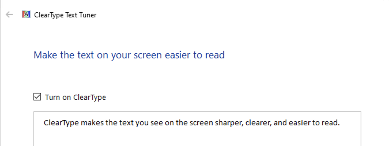

Microsoft started phasing out subpixel-AA with DirectWrite in 2008:
I would be surprised if anything you see in Windows today uses subpixel-AA.
And for those who care about UI size, Windows has vectorized scaling that enables pixel-perfect rendering at continous UI sizes. ...
You mean, Windows programs have the option to render lines etc. on pixel boundaries. Which is of dubious value on higher resolution displays.
There's nothing about "vector scaling" that implies "pixel-perfect" anything.
I have yet to see a vector image that looks meaningfully different when rendered directly at 4K vs. rendered at 5K and scaled down to 4K. But if you can find some examples I'd be interested to see them.

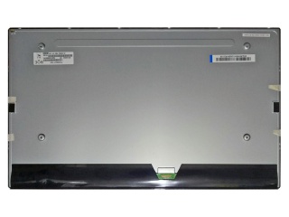

It's this panel. I've unscrewed the casing to check. 23.8 inch. 4K. 185 dpi. 10 bit. IPS. deltaE < 2.
The problem is entirely one of marketing not manufacture cost. Americans don't want to buy a small 4K monitor hence one is not sold. There is the monitor I mentioned in the UK, and several based of this panel available in the Chinese market. None are particularly expensive.
I don't see anywhere that it says "IPS" in that list of specs. It does say 10-bit, but it may not e a true 10-bit panel, and instead achieves 10-bit by applying temporal dithering to an 8-bit panel (that's what the ASD does). It says it was discontinued in 2005, so perhaps that's why the displays that use it are so inexpensive (?).
IPS is an LG trademark. The other manufacturers have equivalent technologies. It says viewing angle 89/89/89. The majority of mainstream LCD panels are 6 bit+FRC (marketed as 8 bit), and some higher-end/modern panels are 8bit+FRC(marketed as 10 bit). The sister-panel of this 23.8" is used in the Asus ProArt (https://www.asus.com/uk/Displays-Desktops/Monitors/ProArt/ProArt-Display-PA279CV/). Production status on Panelook can be inaccurate, and in any case it says Q3 2021, not 2005.
I have two of these monitors. They are high quality panels in a low quality case. They are auto-detected as Retina in OS-X and render a lovely sharp desktop. They aren't available in America. What else can I say?

....The sister-panel of this 23.8" is used in the Asus ProArt (https://www.asus.com/uk/Displays-Desktops/Monitors/ProArt/ProArt-Display-PA279CV/).
Other manufacturers that use IPS can and do label their panels as IPS. For instance, here's Samsung, another IPS panel manufacturer, talking about its IPS panels:
See also: https://en.wikipedia.org/wiki/IPS_panel
What's the source your info. that this is the same panel used in the Asus?
The manufacturer isn't Samsung. It's BOE. They have their own physically different technology to IPS which is visually equivalent.
Also, I am literally looking at this monitor right now. It has IPS-like viewing angles.
I won't reply further as I have a sense you seem to think I'm lying for some strange reason.
Thanks for letting me know. I don't use Windows directly myself (I sometimes have to remote into Windows computers), so I wasn't aware of this.
I'm not an expert on Windows, but it's my understanding that, because of vectorized scaling, it can render displays at non-integer scaling ratios without suffering the artifacts seen with MacOS. Is that not correct?
