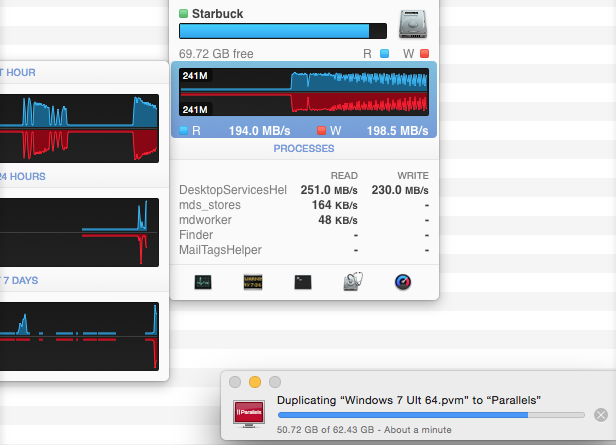

Update on my MCE Optibay Extreme. I've used it successfully with a Crucial M500 series SSD for many months. On large files transfers, it will occasionally 'pause' but no data is lost, and the files are not corrupted. Of course, I would like to see what I can do to better shield the cable, but I thought it noteworthy to report. The uploaded image shows data throughput in copying a 60GB file from/to the SSD in the optibay. Even with the occasional slowdown in data transfer, the SSD in the 2nd bay works well enough to run a Parallels VM of Windows 7. Note: I typically have bluetooth turned off when running the VM (just in case) so YMMV. If anyone comes up with a good way to shield the connector cable, I would love to hear it. As for the snake oil opinion of the optibay extreme, I can say that at least the one they sent me works much better than my own (goofy) attempts with foil. I have some copper tape meant for a guitar that I was going to try, but the performance hit is not such a deal breaker that I want to bust open my system again. Hope this helps someone.
