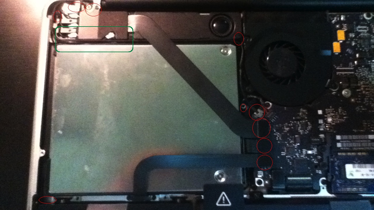

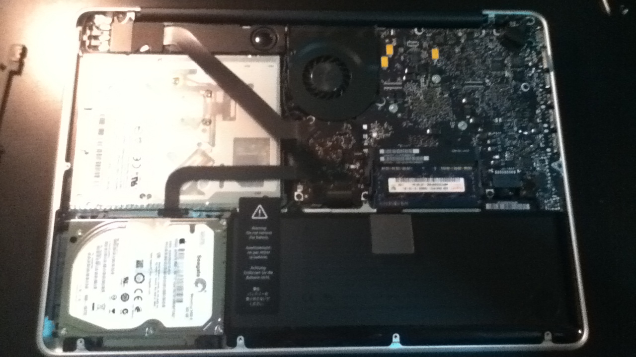

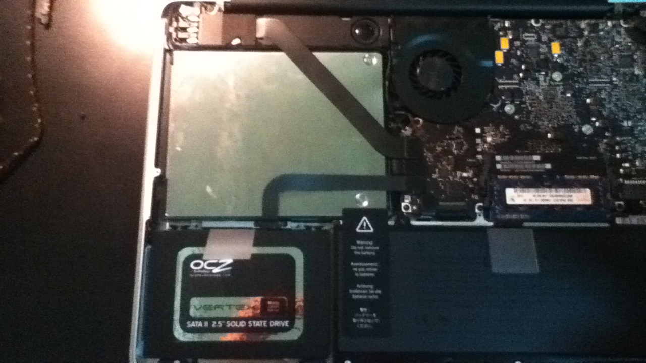

Did it last night. A bit tougher than before only because the the speaker area was kind if tight instead of being able to move all the way out. The black speaker thing is also a little flatter or something. Anyway my caddy was ghetto in the first place and I had to shave off some black plastic to fit it again. Anyway it's the same size, easy. lol didn't mean to make that confusing I'll post pictures here soon.
*edit* pictures
attachment photo 3 shows in red approximately the screws or cables that need to be removed. The green square is what I meant that seemed to be "bigger" or thicker. Shouldn't be a problem though. Good luck, sorry for the craptastic pictures, did it in low light lol.
