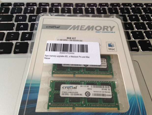

8 gig ram arrived today.....with new set screwdrivers from Amazon
Just the torx drivers and hdd bracket for my original hdd, that will be my macbook upgrade complete🙂
