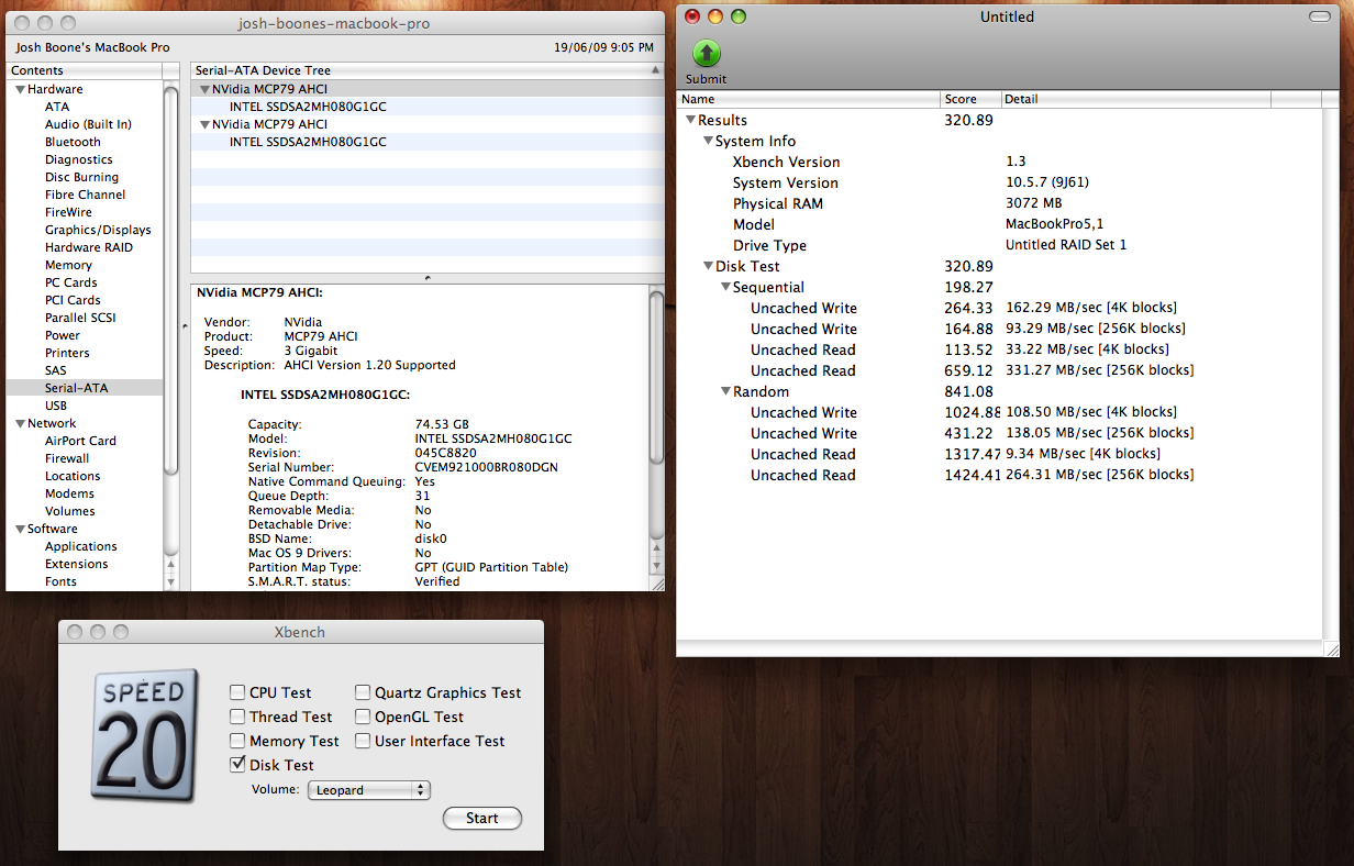

yawn....here is my setup
2xintel's
better battery life, external slot load samsung w/lightscribe usb powered 😀

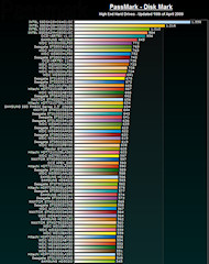

For boot times I really don't see any difference as the read times are almost all the same in high end drives (240 - 250mb/s) its where the write times come in that makes a difference.
