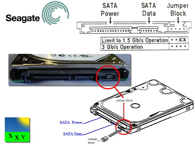

There any jumpers on the drive that could define the bus connection used? Some previous 2.5" HDD had jumper settings that would force 1.5 or 3.0 if the autodetect failed. It's possible you could set a jumper and force 3.0 here.
No jumpers on the SSDs. In fact, I haven't seen jumpers on hard drives now for years. I don't think they exist anymore.
Wow - you haven't been looking as they never went anywhere on 2.5' HDD and from the google images search you can see that the Kingston, Toshiba, OCZ all have jumpers on them...
http://www.google.com/search?q=SSD+...&source=og&sa=N&hl=en&tab=wi&biw=1242&bih=720
And here's a link to a Vertex user stating that they can't get their BOIS to recognize the drive WITHOUT a jumper.
http://www.ocztechnologyforum.com/f...solved-Vertex-only-recognized-if-jumper-is-on
You may want to do more reading before you dismiss suggestions like you know better...
