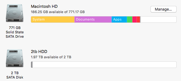

I wanted to report back that I have all the bits and pieces together. I picked up a 2tb WD Blue from NewEgg, and also just a generic brand Optibay attachment.
Since I was concerned about the SMS, I put it in the standard HDD bay and then put my Evo 850 in the optical bay. The installation was straight-forward, and when I powered the computer up it booted right off the SSD.
I'm in the process of migrating my photo library over to the 2TB drive, and am going to re-route my default Lightroom catalog over to the 2TB drive. I'll see how that goes-I may end up still doing the initial import to the SSD and later migrating over to the HDD, but I'll try that.
All I know is that between my Nikon D800(36mb) and D600(24mp), I can chew up a LOT of storage space pretty quickly.
I know newer MBPs have their advantages, but this just goes to prove to me that in a lot of ways the 2012 9,1 is still king 🙂 .
